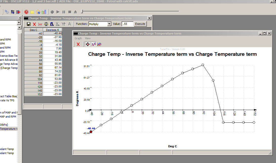

when you do a hot restart, take note or better yet log the calculated charge temp. You can add that data plot in the monitor by right clicking and adding it, then log it as you start the engine and let everything normalized.
We should see a peak charge temp during this period which will give you an idea on what points on the inverse need tweaking. It can be fudged in the inverse as the factory did on the V6 here. So under normal running conditions it's never reached but only does when a heat soak restart happens. The normal thing for the V6 to do it go really rich on a hot restart, the reason is the fudge from factory was overly aggressive, but making it linear makes it got way over the other side and become really lean, like 16:1 lean. Where as target might be 13-14. For the fudged v6 factory it typically goes around 11 if i recall, but making it closer to linear but still roll over around the 100c mark does the trick
See this screen shot of BLCD implantation of the inverse temp the factory did.
