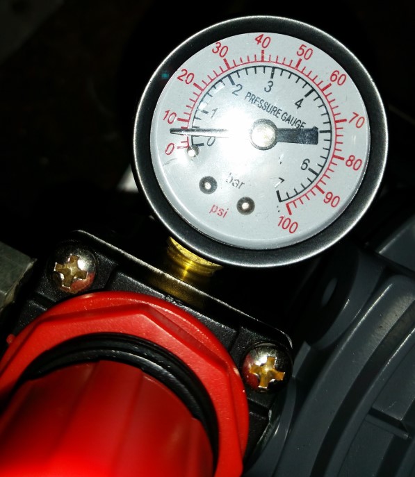

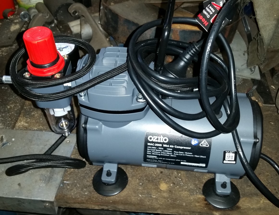

Ok so i've modified the rig, and with the use of the wifes craft compressor (which is not allowed to smell like fuel or have grease or dirt on it)
i've been able to use it for simulating manifold pressure, and lets be honest, it doesn't have the cfm for much more than that anyways ... it maxed out at 280kpa on the delco log

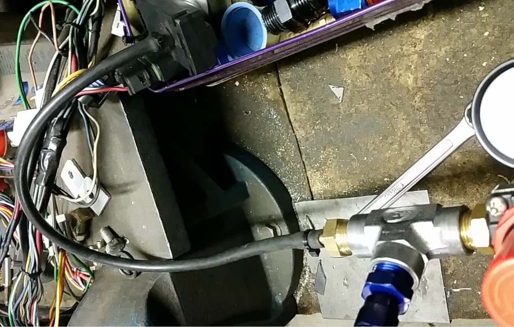

So i removed the air brush and found some suitable fittings to make a little manifold for my wastegate/solenoid feed and the map sensor.
This thing is pretty cool, it has easy adjustment down to about 120kpa (map sensor reading) much below that and it starts cutting on and off and gets a bit pulsy ... it also seems the guage is not quite accurate at low pressures, but the map sensor is there for monitoring that stuff anyways.

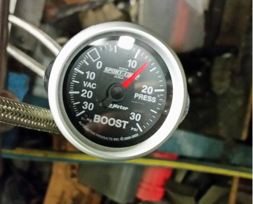

So i used my boost gauge to go onto the exhaust manifold, and i have a 18cfm i think air compressor on it, its got enough flow to put the manifold pressure to well over 30psi so i've got plenty of room to adjust there.

I just need to connect up the boost solenoid now and i can start playing, but with adjusting the wifes air compressor i can easily open the wastegate

so this has progressed a bit, i used my fuel pressure sender for the FX to plumb into the exhaust manifold, this gave me a PSI reading in tunerpro logs, and was then able to see what changes i got in the exhaust from changing the inlet pressure on either side of the gate.
the end result is, i can see pressure changes and i can see the actual wastegate valve opening and closing but i think it really needs a flow meter on the outlet of the wastegate to see how much air is going through it, i've also found while the craft compressor is able to provide the pressure needed to simulate the inlet pressure, i dont think its moving enough air to open and close the gate quickly enough, ie. i move the duty cycle of the solenoid from 10-15% and then the gate slowly opens more over a few seconds.
