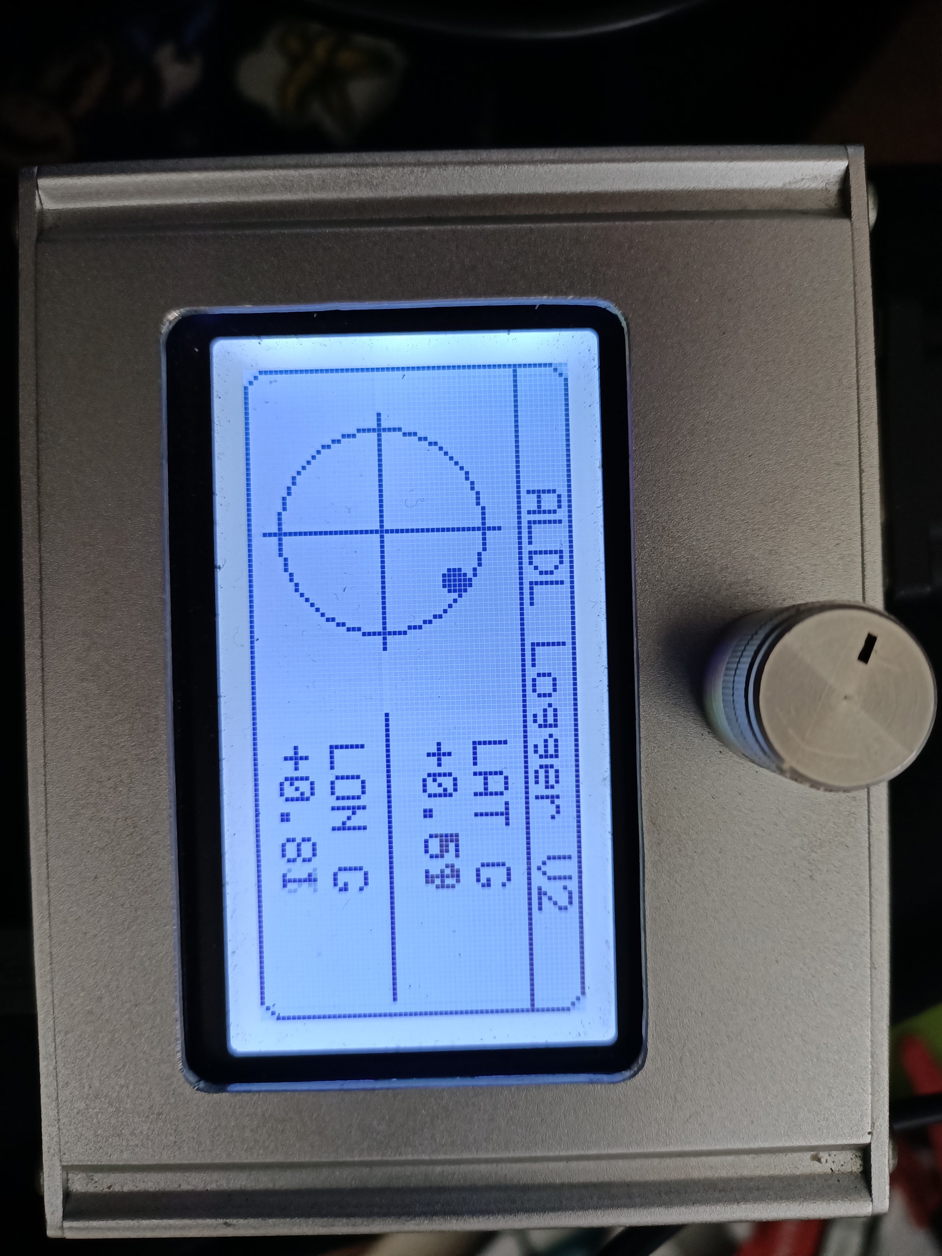

Can anyone tell me what this screen on the logger is for?

That was for the added bonus, G-force type metre for analyzing different things like take off etc..

Wow he certainly did a great job with this little tool. Shame there's nothing in the paperwork (that I can find) that shows how to set it up and use it.
