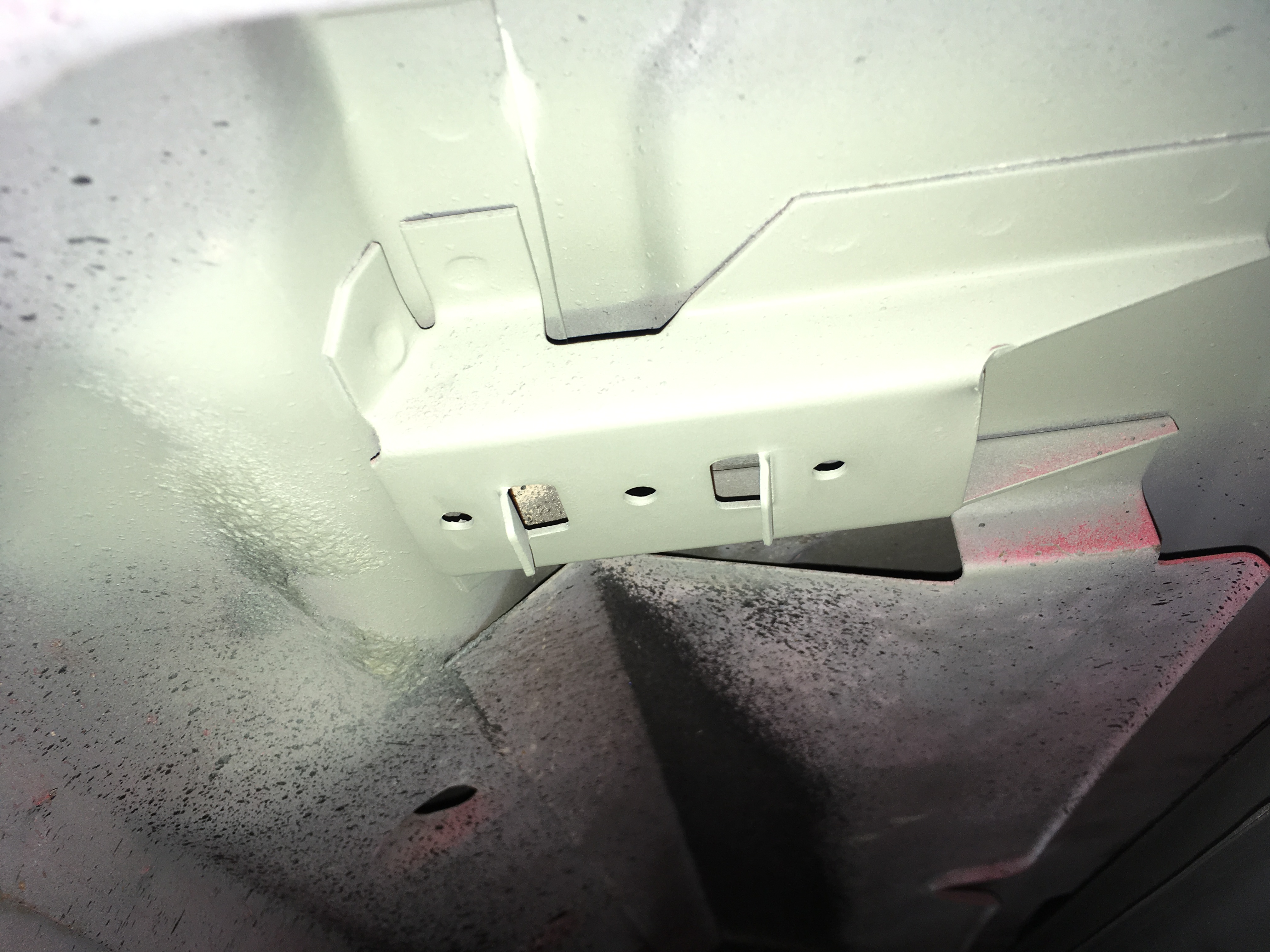

Sorted the upper section of the existing body mount. Cleaned off the left over spot welds and drilled holes, clean up and anti rust primer.
Test fit while I get some of the correct length CS screws next time I am up in Melbourne.

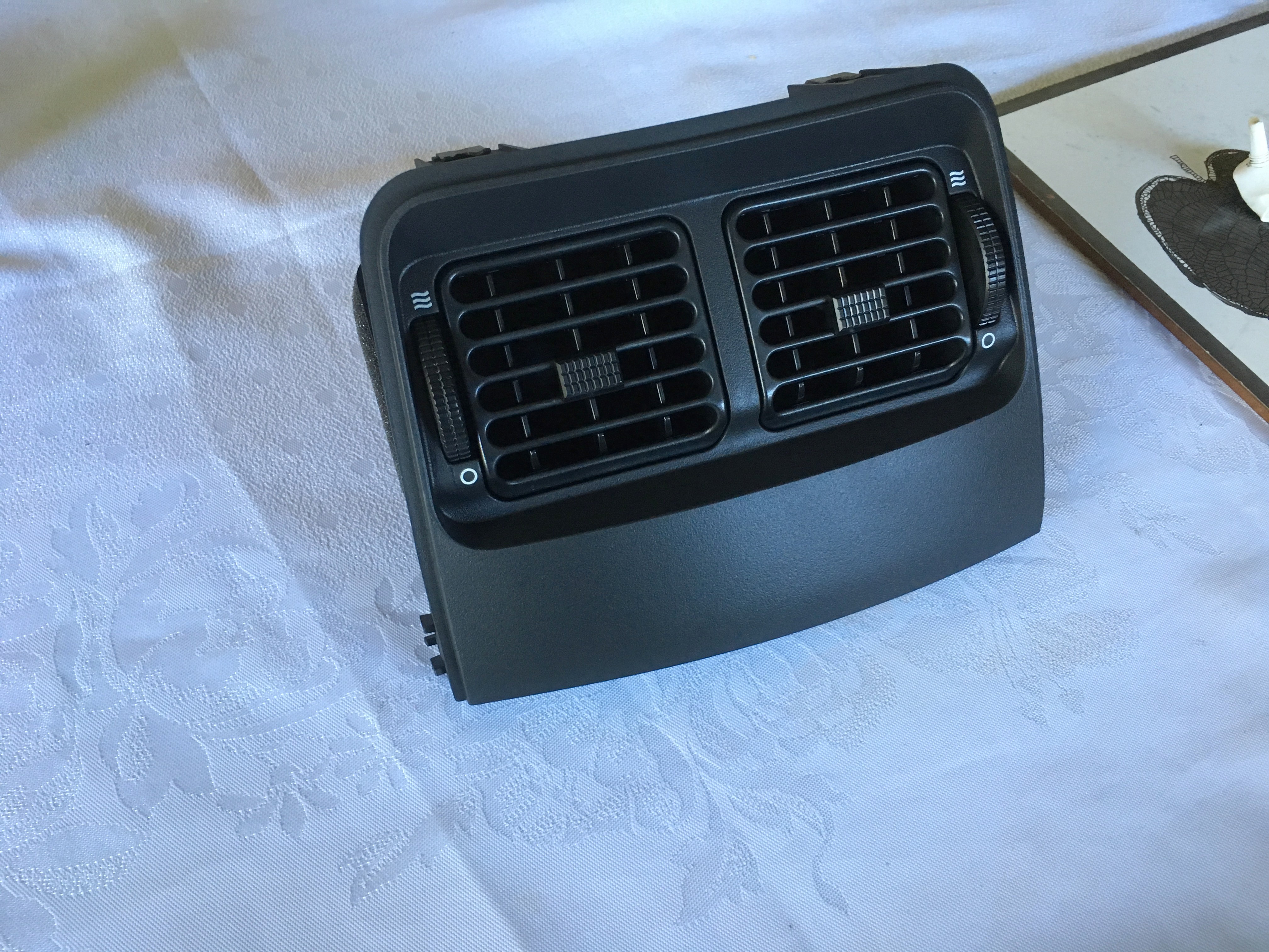

Had lots of trouble getting the technique of laying down the custom flat/satin black die down but finally got it down pat to get the finish I wanted.
Turned out damn good I must say. Better than the $480 asking price for a NOS black vent lol.

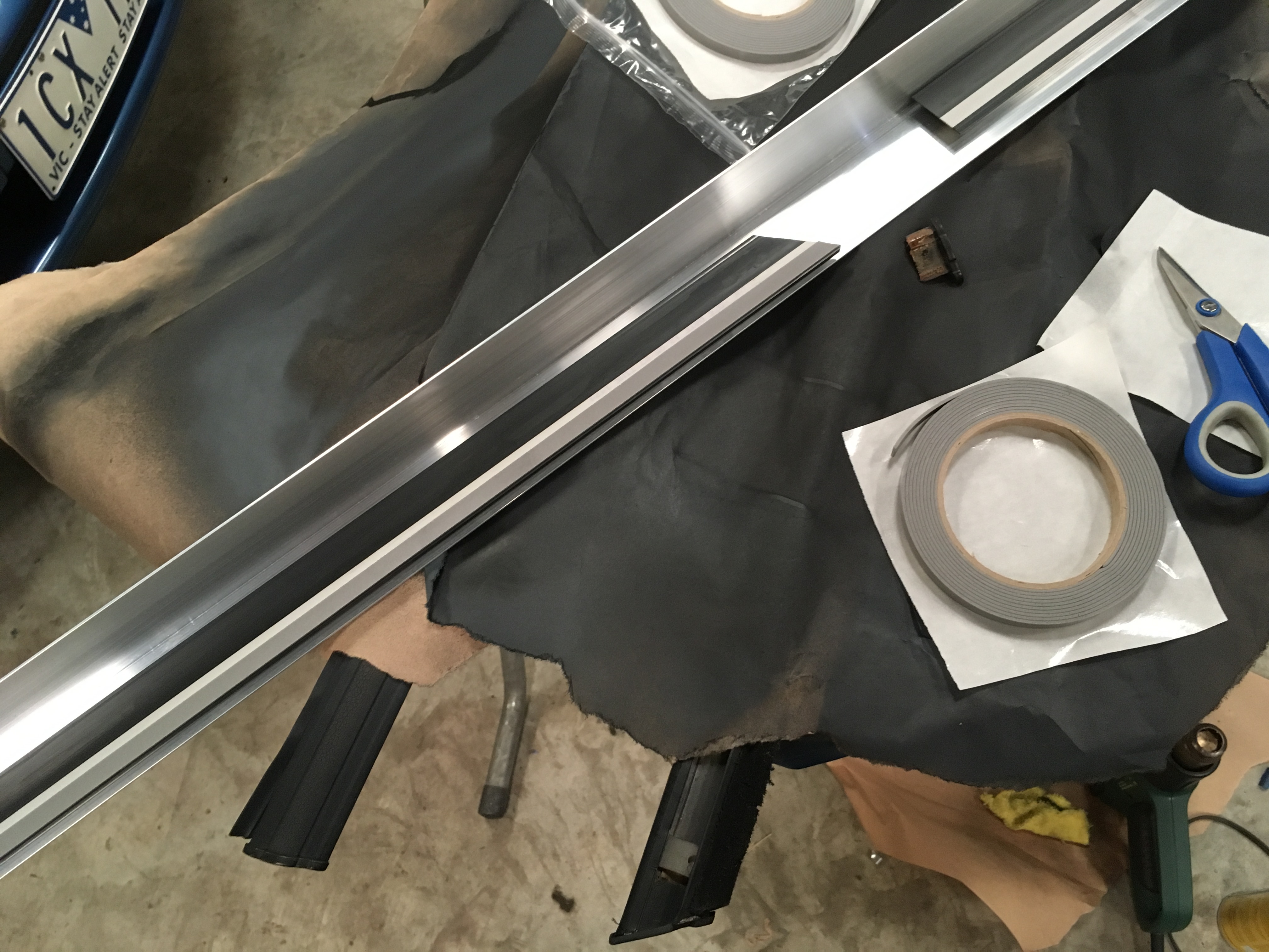

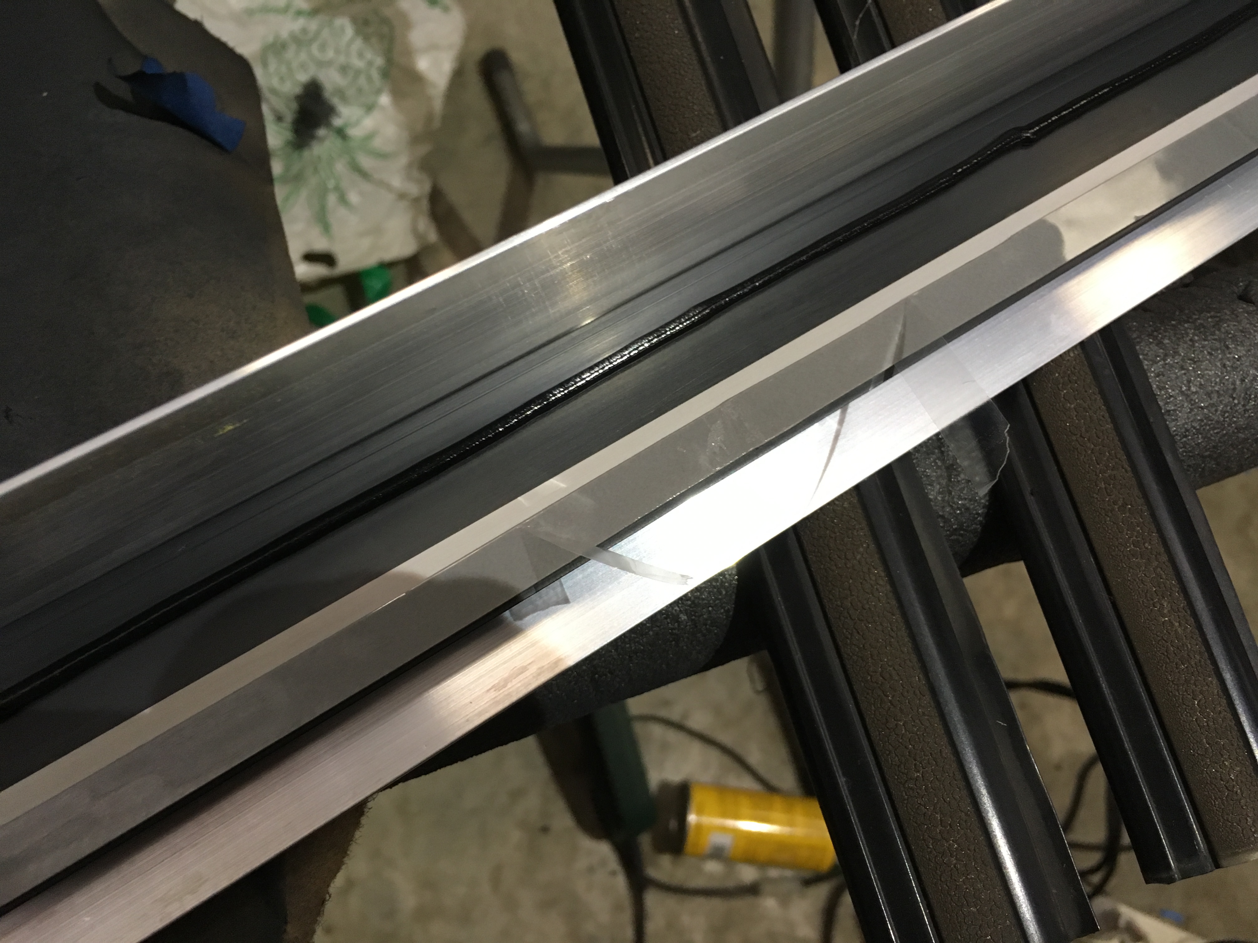

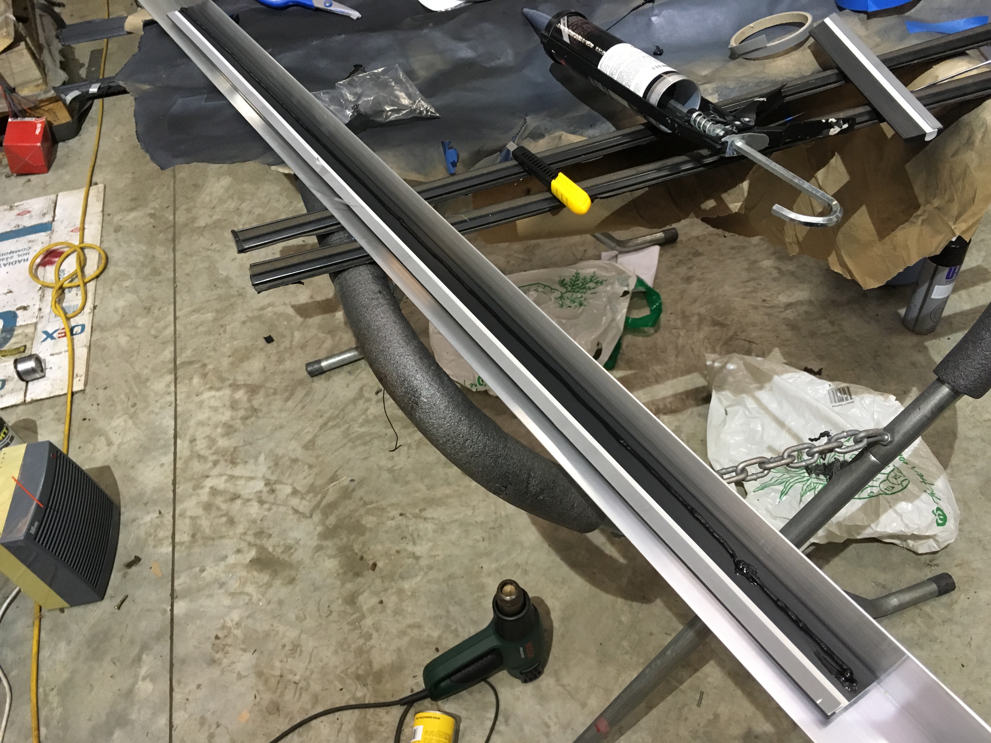

Got to do some moulds. Only one side so far.
Fresh from straightening out in the sun in this alloy angle section. Applying my very own double sided to spec tape.
Looks fantastic!

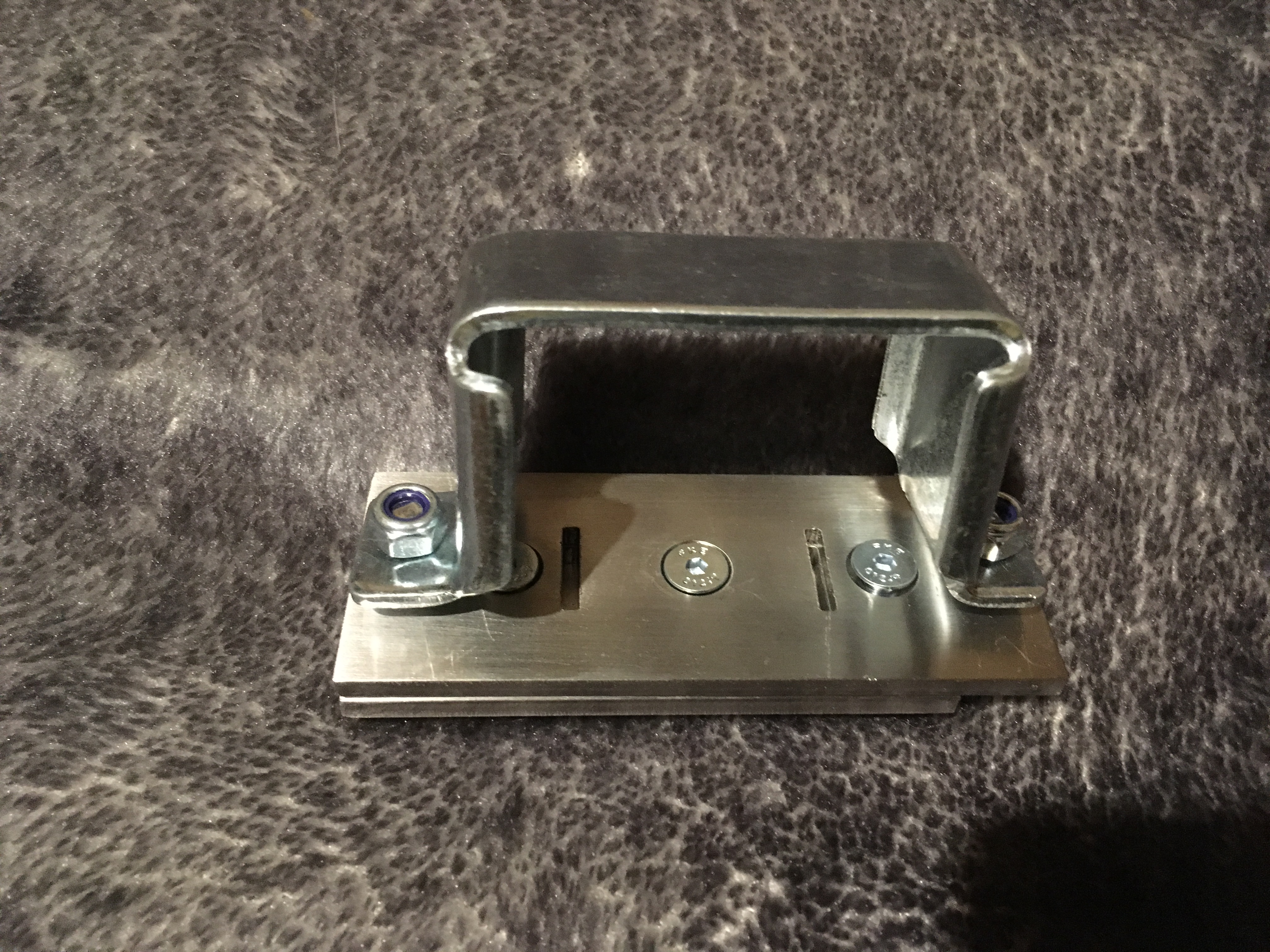

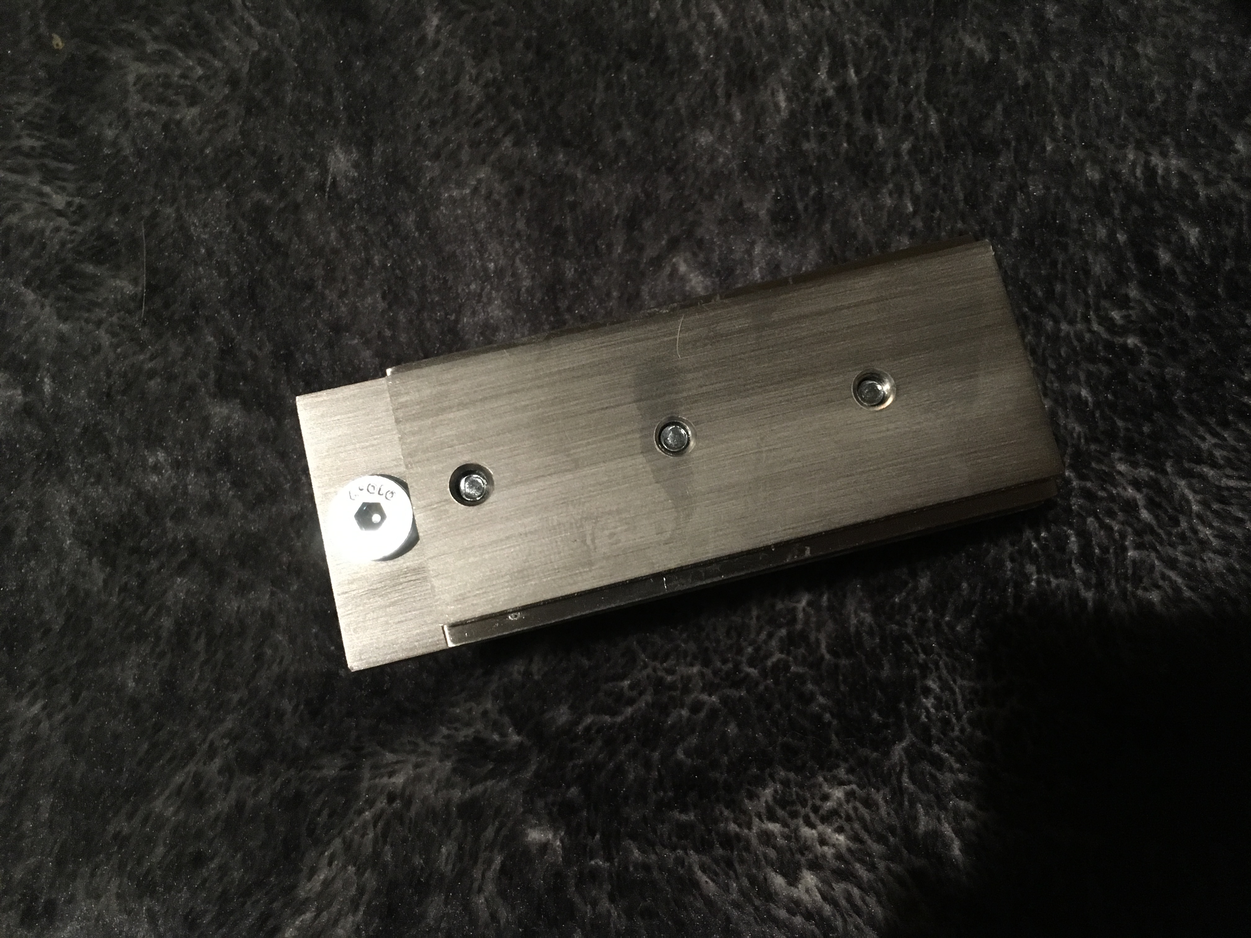

I got it all level and straight with this magnetic padded straight edge I made for this job.
Although the early lower shifter boots are made from a superior rubber compared to the late one piece type which they always perish. The early ones don't hold on to the plate lip all that good and tend to pop back off.
So I sikaflex'd that in too while I was doing the moulds. Had to put some weights around and tape some spots to stop the rubber popping off before it dries. Should of done it before I riveted the plate in in hindsight. At least I would not of needed weights and been so awkward to do, but it worked out anyway. Always the next car for improvement

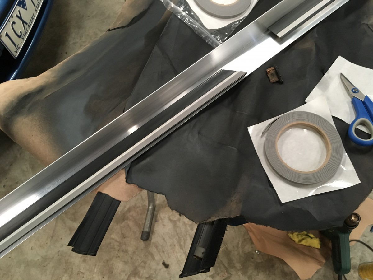

Looks fantastic!

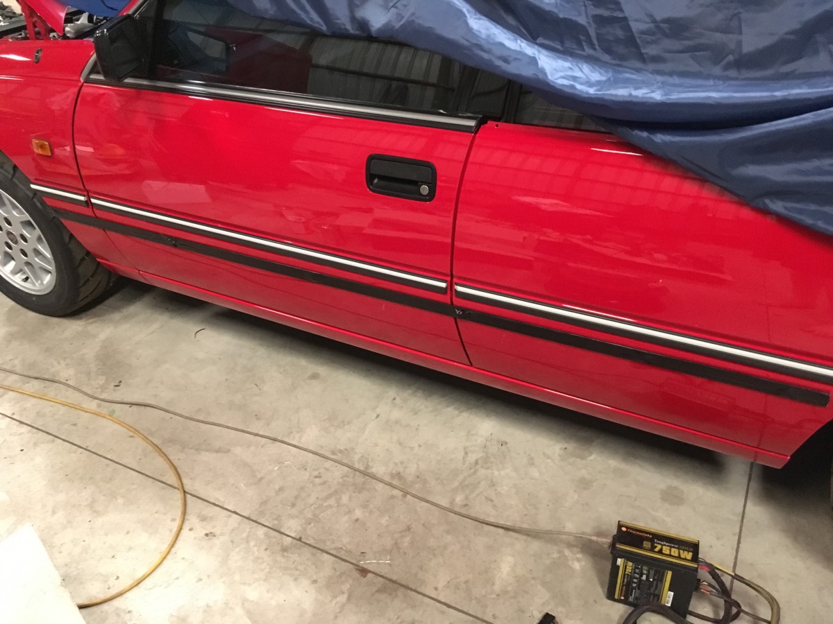

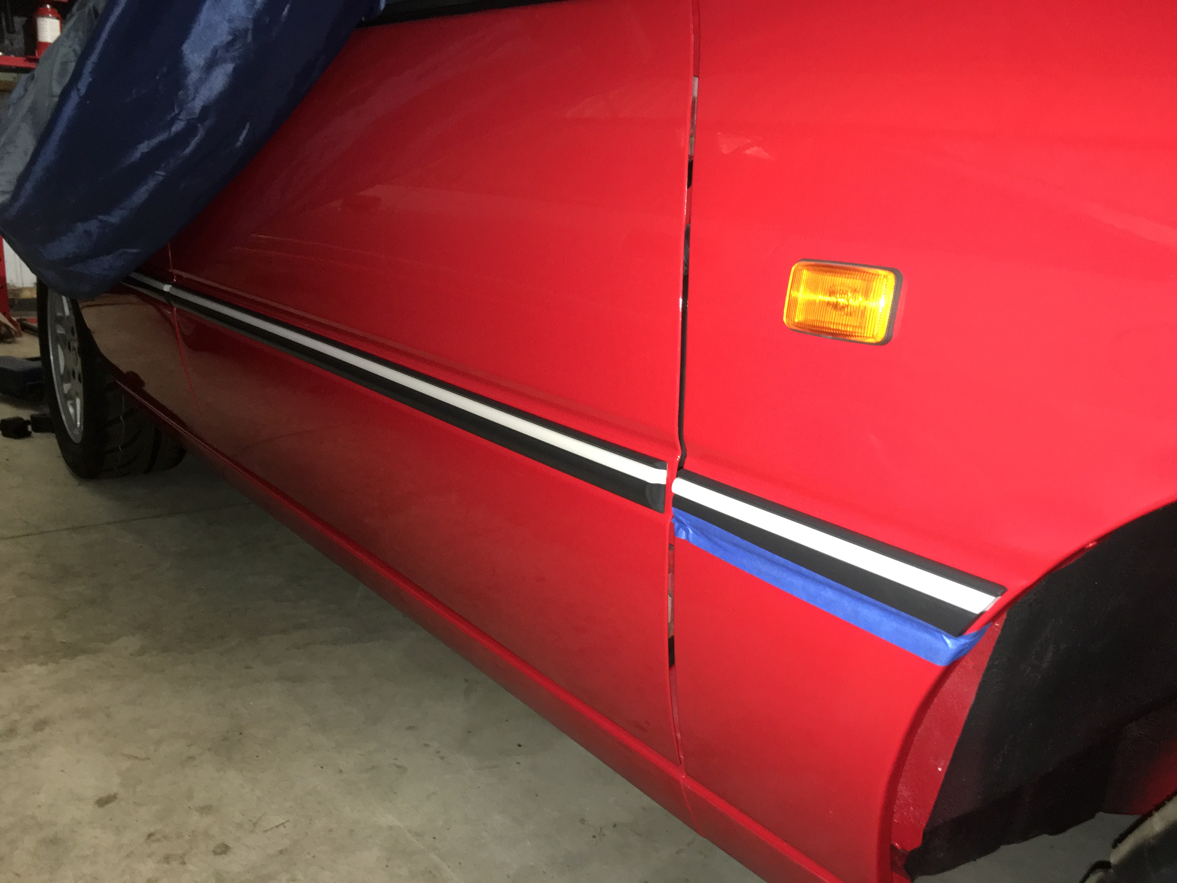

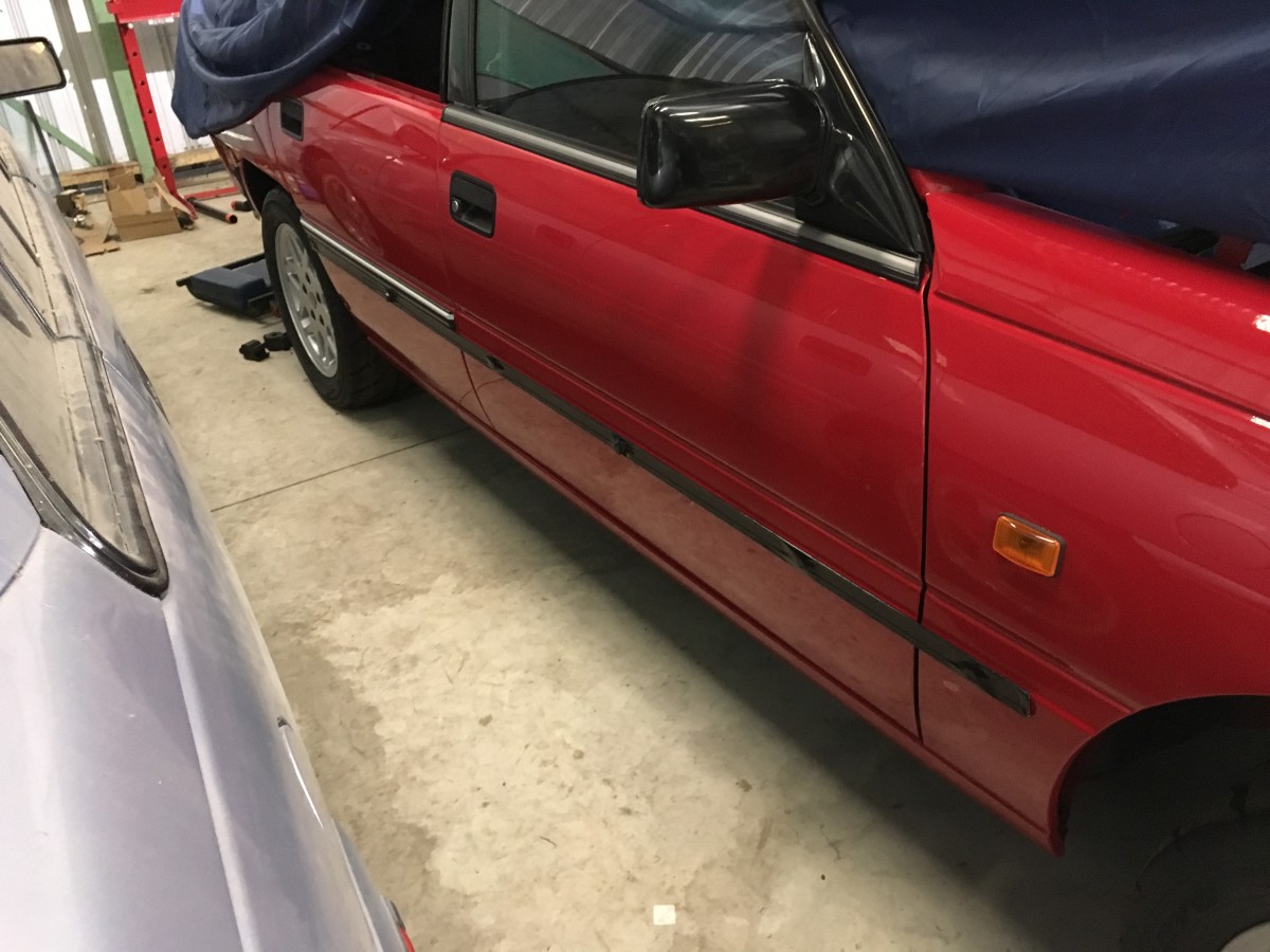

More of the same.
I split and splay the backing in the middle and apply from middle out. This works best and if/when the backing snaps you can save it by then moving outwards in. Start from one end to the other and if it breaks then you are in trouble.

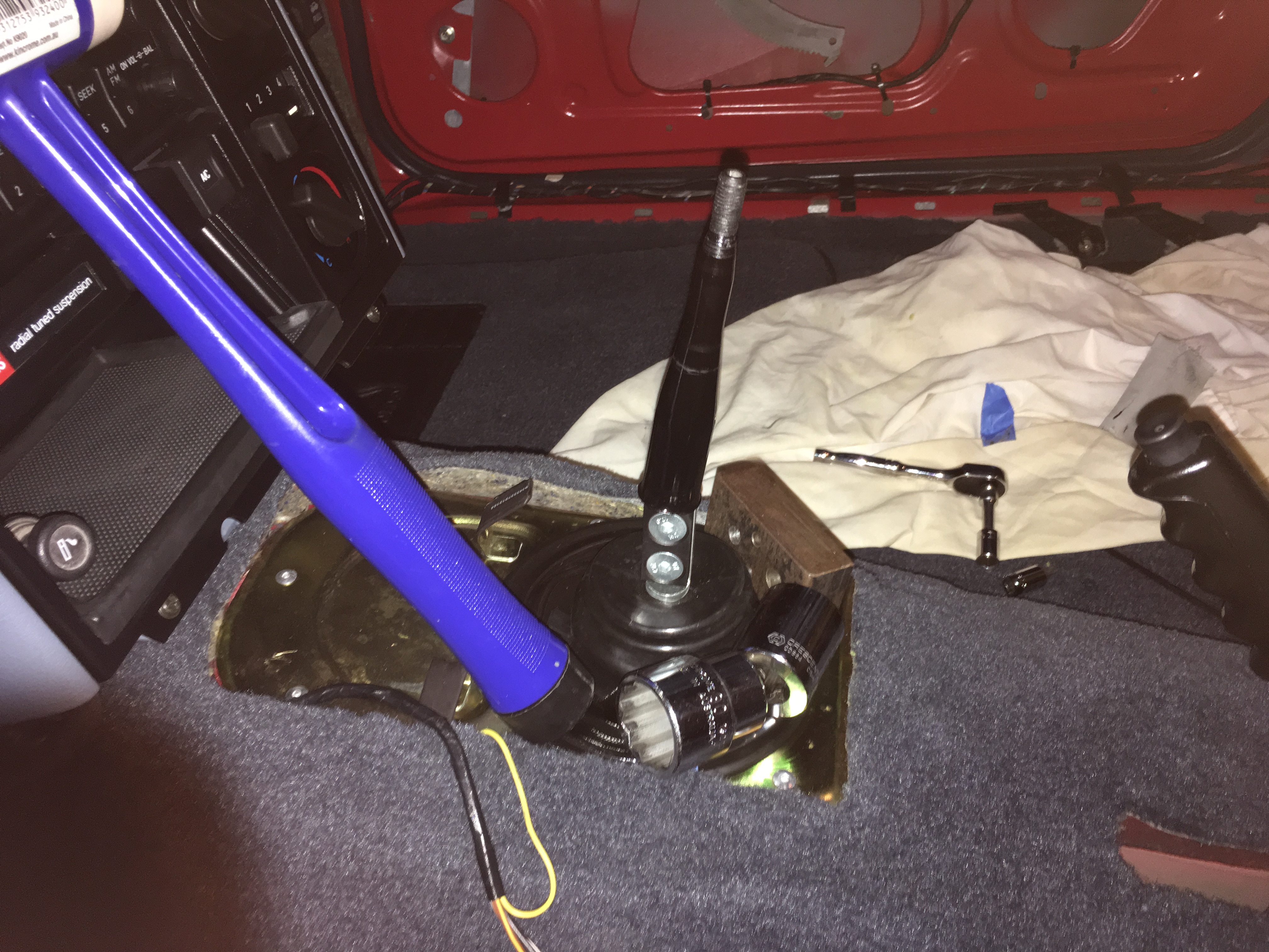

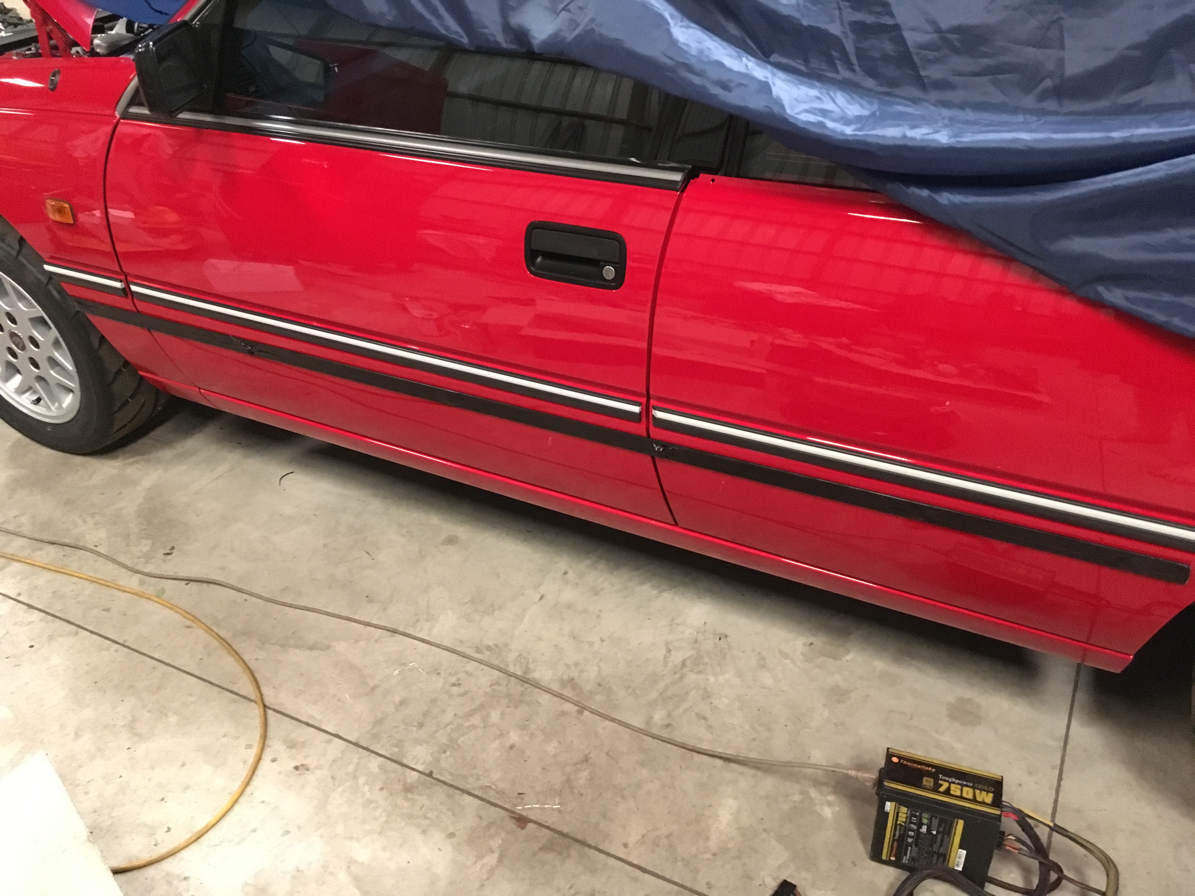

Had fun trying to get the intermediate shifter boot tucked into the lip of the lower one. Because of the solid mount still not quite the right height the shifter is a little offset to the right and made it very hard to get in there with pick hooks and a like to tuck under and roll over the lip on to it.
But got it in the end.
