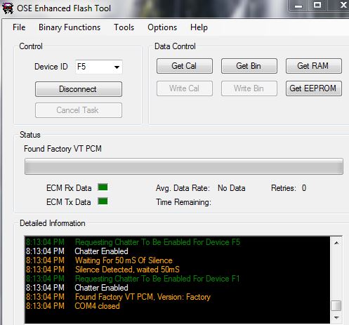

I tried connecting with Flash Tool it connected but the write cal box was greyed out & I couldn't upload the modified Cal file even after I tried downloading it 1st.

- NoWriteCal.JPG (51.25 KiB) Viewed 7431 times

The flash tool says its a factory tune, so thats why it wont write. it sounds like the abs error is real but you may have other problems still. Tell us a bit more about your setup and whats installed. Is it a reasonably new hardware in a known state? Is it our hardware? What does oseplugin say the hardware is when you connect? what xdf and adx are you using?
