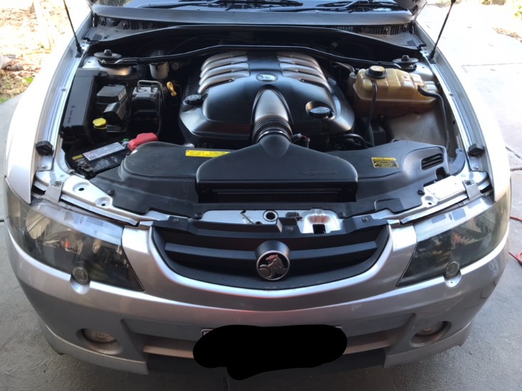

Post by Wade »
Here’s the new toy. So far I’ve only fitted a twin 2.5” red back catback exhaust, growler intake and mafless tuned it.

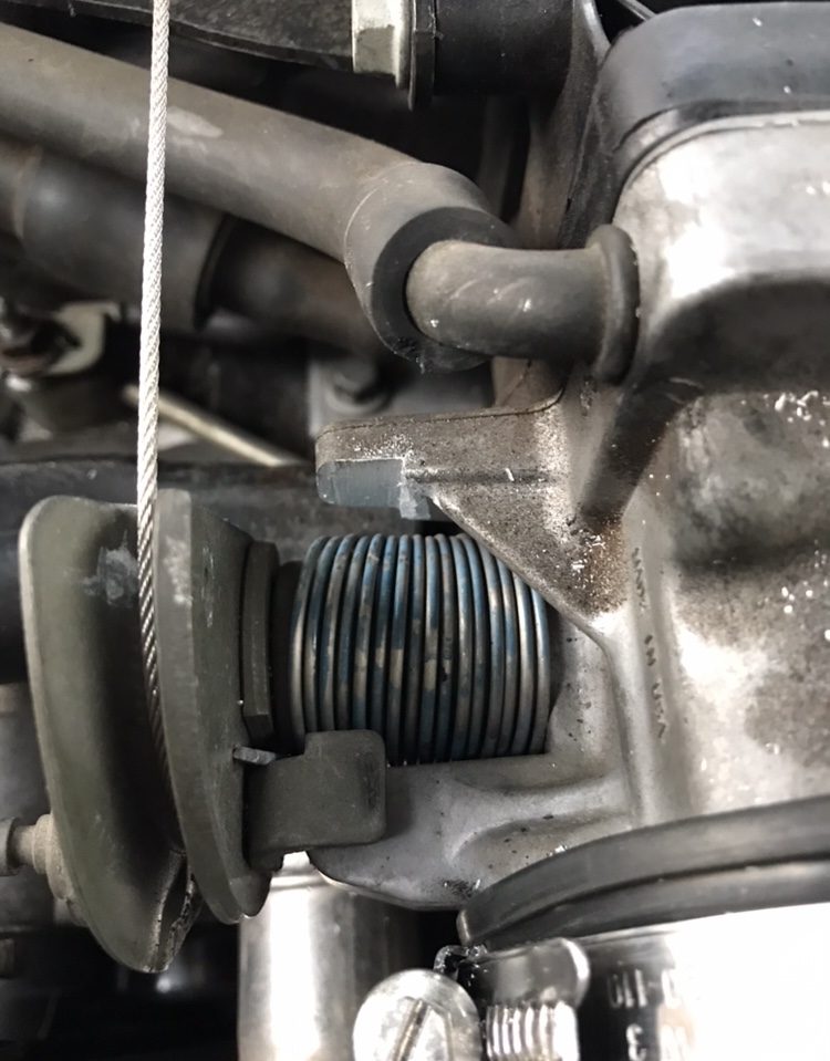

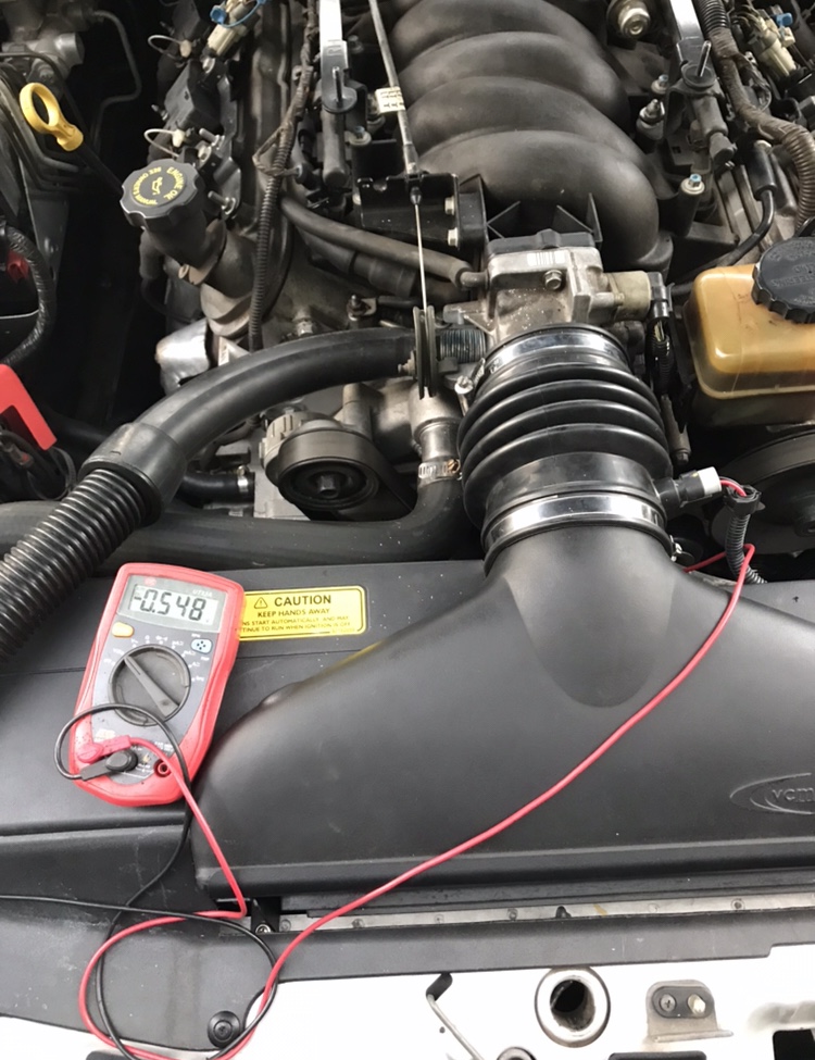

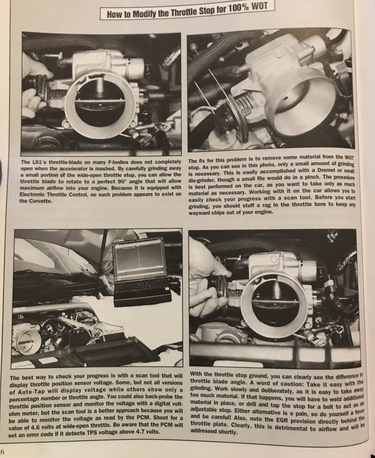

So I gave the ls1 throttle body mod a go

Post by Wade »
Needed to adjust the throttle cable once done

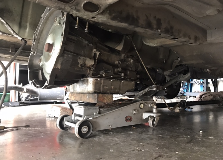

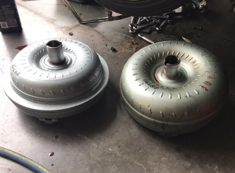

Next up is a tci 2800-3800rpm converter upgrade. Still retaining tcc

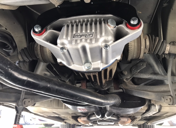

I also dropped past harrop for one of there diff covers. I’ve ordered a full 3” exhaust system from empire as well. Keen to comparing the empire exhaust to the difilippo one I have here. On paper they both have the same specs, so will be good to do a comparison between the 2. There’s a huge price difference between both systems so hopefully the empire system stacks up. Also a little worried about the fitment and clearance mainly around the diff cover area, as the harrop cover sits out a fair bit more

whats the advantage in the harrop diff cover other than the shinyness? holds more oil for better diff life or something? or stronger mounting points?

Holds more oil and is supposed to help with axle tramp
