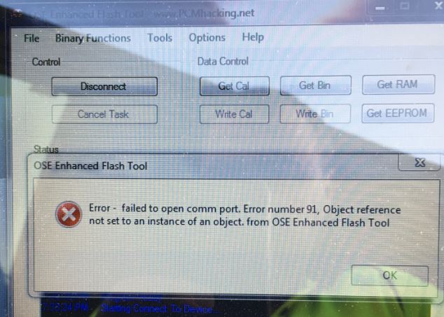

What I am stuck on at the moment is how to get a com port appear in the flashtool if you could help.

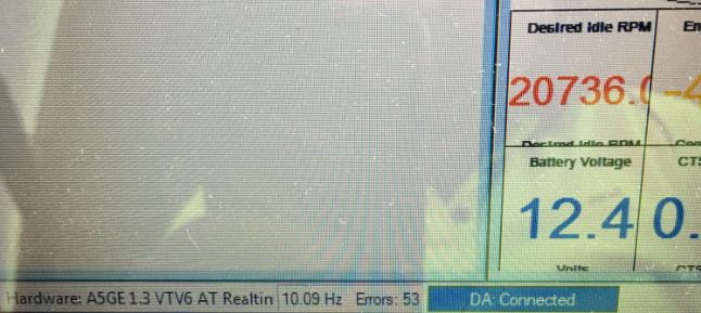

oseplugin is the plugin I wrote which you run with tunerpro to do the realtime tuning. it'll connect when you hit connect and its another way to see what code is on the nvram. See the first screenshot here viewtopic.php?f=3&t=590 (zoom in on it) and see down the bottom where it says "Hardware: OSE 12 Pro v1.1.0" In your case it will give you type and version number of the bin (if it can connect). If it cant, and your sure the right software is on the nvram, you should take it up as a comms issue with the person who sold you the cable. The fact it has been getting worse does sound like a degrading interface and most the other, cheaper ALDL interfaces are based on a simple diode and resistor circuit with a cheap usb interface chip and dont work very well. 3rd party aldl interfaces are probably the biggest cause of problems we see on the forums and it wastes a lot of our time for hardware problems which are outside of our control. See this thread for another just days ago. viewtopic.php?f=7&t=6123

HI Antus Tuner Pro RT gave me the details you said to look out for see image it was A5GE 1.3 VTV6 AT Realtim.
I tried the flashtool again & rec a error msg again see image I then went into flashtool & the comm port appeared I retried flashtool & it brought up RT A5GE 1.3 VTV6 A PCM instead of "Factory VT PCM" yet it was still the same NVRAM with no changes from before.
I had a look at the threads you linked & open up my cable it is a combination of the 2 shown & has a diode with a wire to pin no.9.
So I am still unsure where my issue is, the car, cable or laptop. Cheers

Well that proves you have the right thing on the nvram, and the data is being corrupted (different results at different times). I would stand fairly sure its a cable or cheap cable chipset driver problem. If not its a car problem. But from here you'll need to take it up with the cable vendor.....
