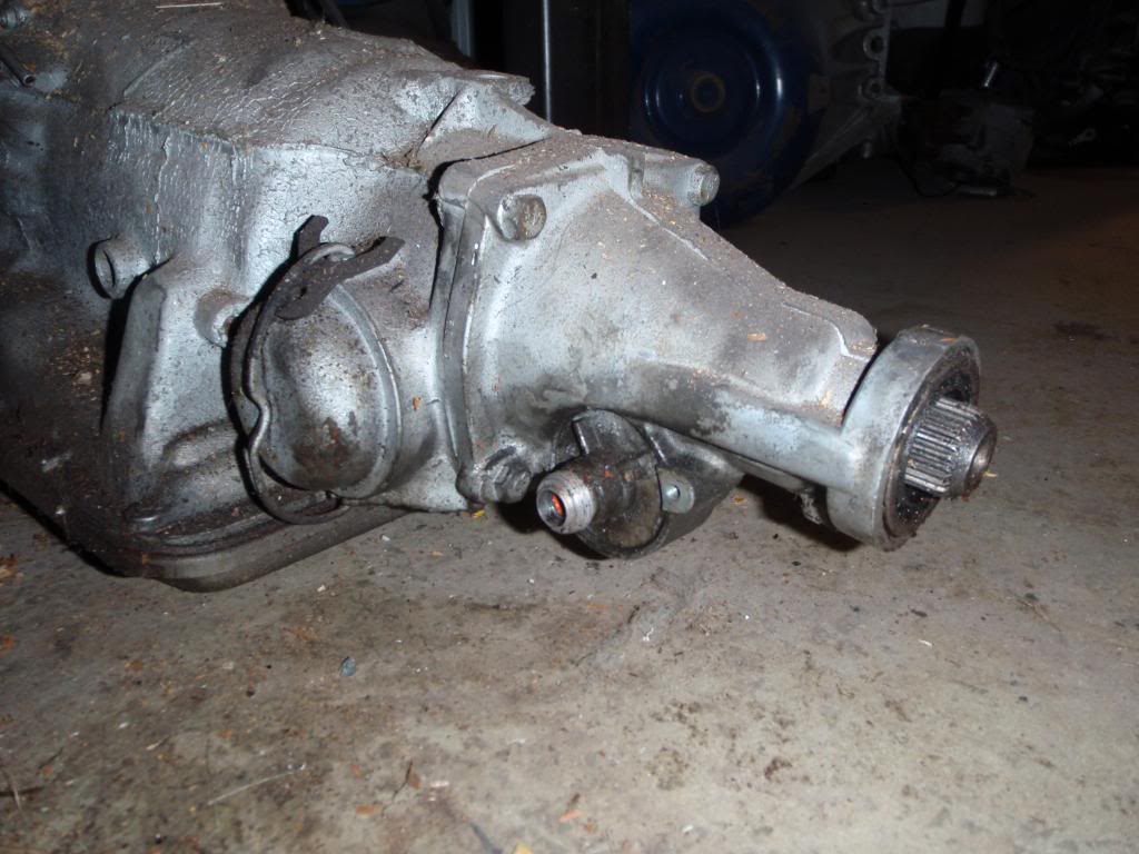

I was using a t5 vss in my vr with manual Ecm 12p and th400 if that helps. Screws straight in
Re: Vss

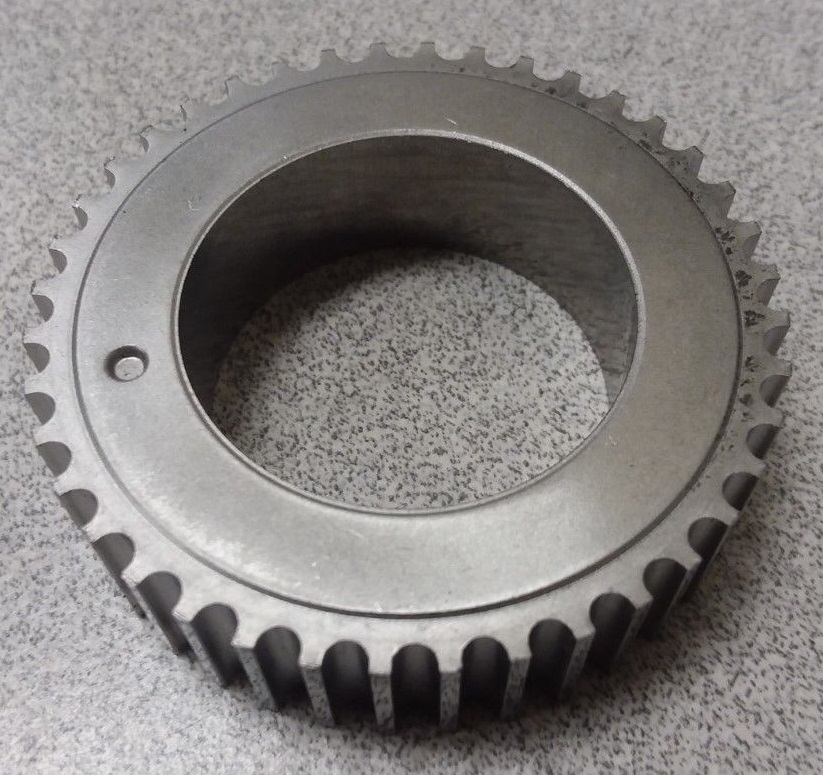

its going to be a different one for the pass through ....
my theory was this ..... with the box I had was the following:
remove it and install this:
and press this onto the shaft:
now I have done similar in the Bedford, its got a VR computer and T700 hydraulic box, so I put a 4l60e extension housing on it and the speed sensor ring and its done, the question will be if the T350 speed sensor hole is the same, if it is I would suggest it will work, you cant use the whole extension housing though as the length is different to a T350.
unfortunately I never got to trying it out before I sold the LS1 & gearbox and went turbo 202
