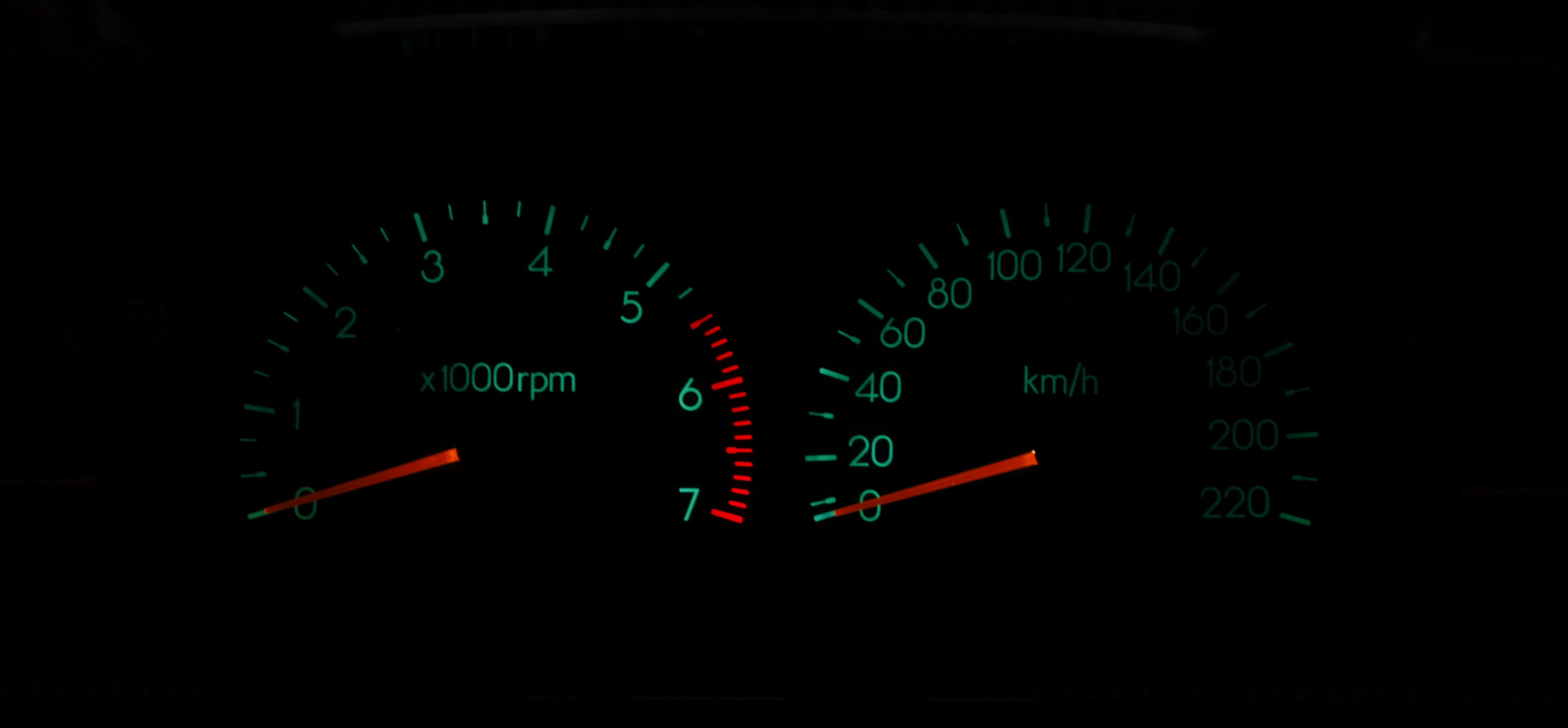

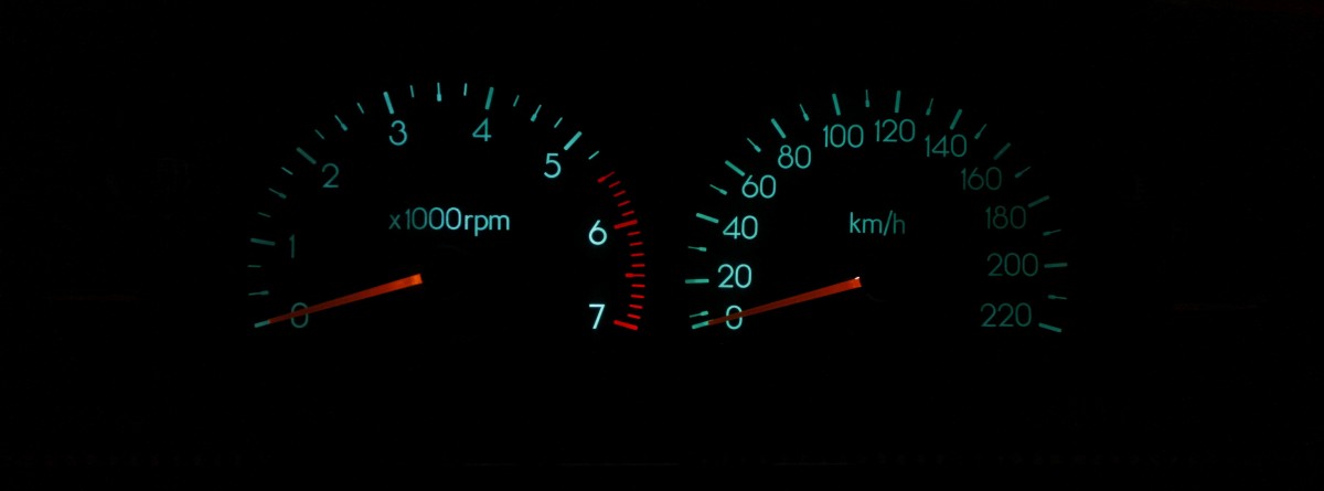

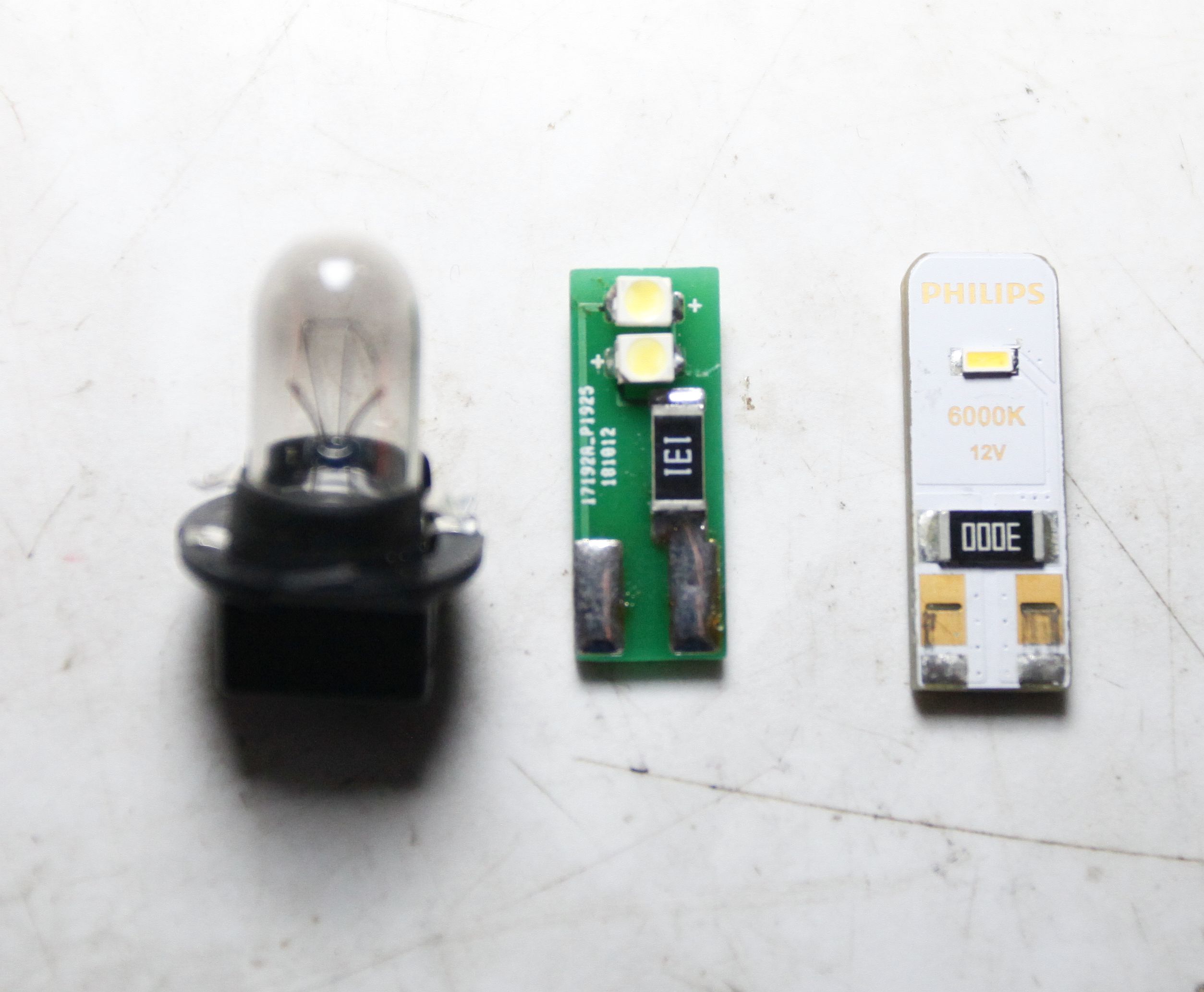

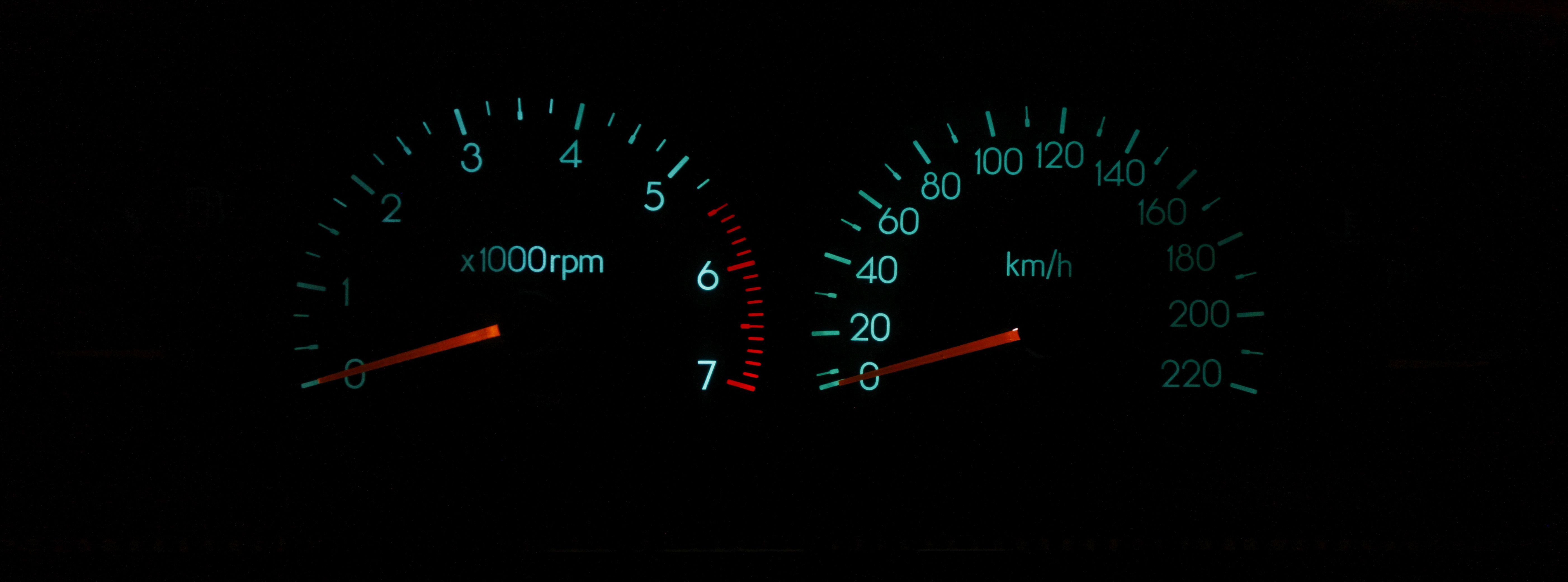

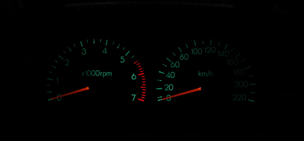

Been looking around a long time and never found anything great, most dont fit into VS clusters as they are to wide or long and hit the tacho and speedo housing and others that do are to dull or cheap and narsty and dont last, the only half decent LED's ive found is the phillips ones but they are to big for the cluster. So it came to this point when i decided to make my own so i can drop in and run and it's a fair comparison to bulb, i got a few boards done while i was ordering memcal boards. Here's a comparo. Mine is Dual Sided Dual LED. Thoughts?
Using this LED here.
OSRAM 5600K 120Degree
https://au.mouser.com/ProductDetail/720 ... V2BAJKPLZI
LED VS BULB, TOP LED, Bottom Bulb.
Both Done at 1/30 F4 ISO-2500
