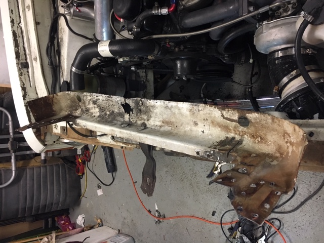

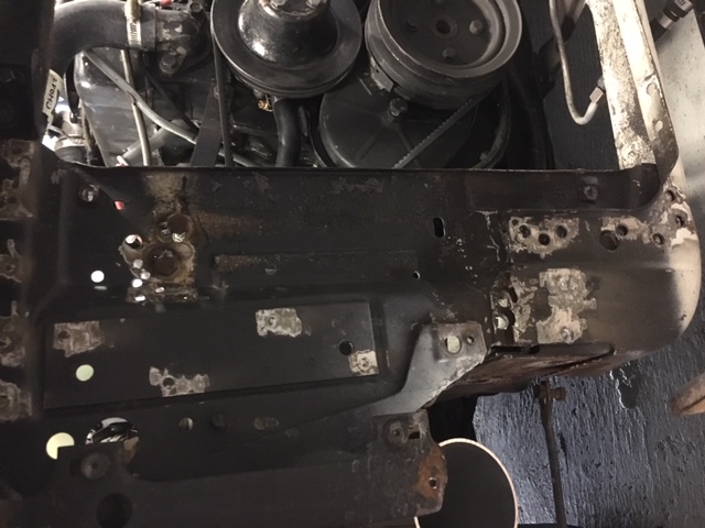

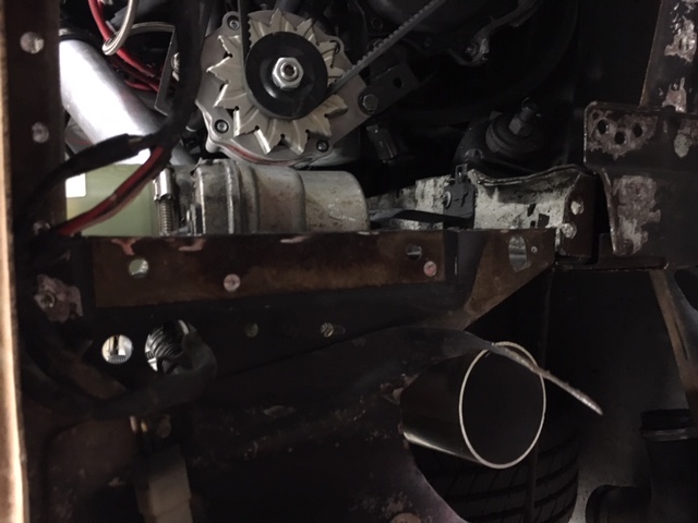

Bit of an update before going back to work tomorrow.

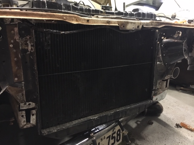

I am increasing the VK radiator hole to take the larger CL radiator.
Starts with drilling out lots of welds.

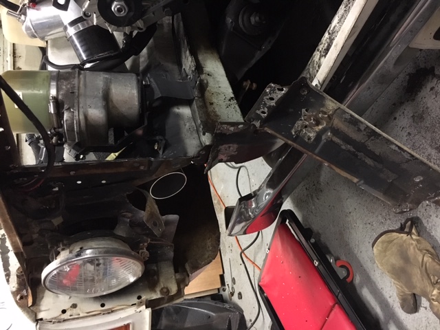

Cut out the old existing panel.
Cut down and reposition

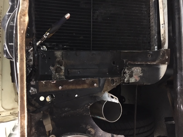

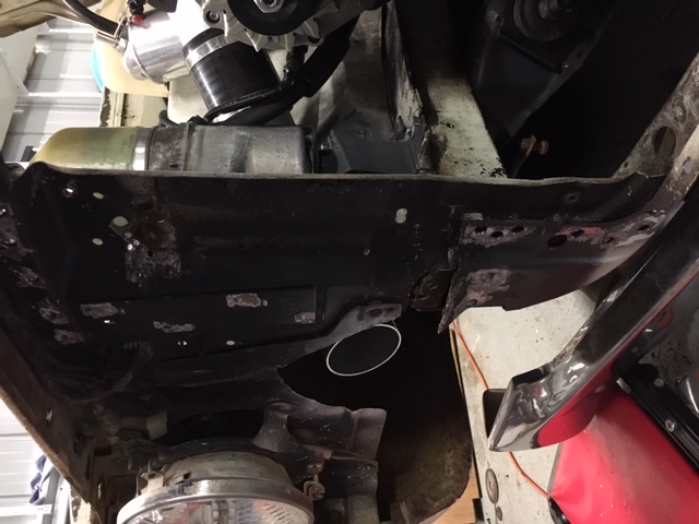

heff0018
Posts: 1045
Re: 265 Hemi to efi
Post by heff0018 »
Continued
Radiator bottom panel will get repaired
Both sides need trimming to get the desired opening size.
Resized panel on the left is temporarily held in place.
I assume bigger hole means more airflow
