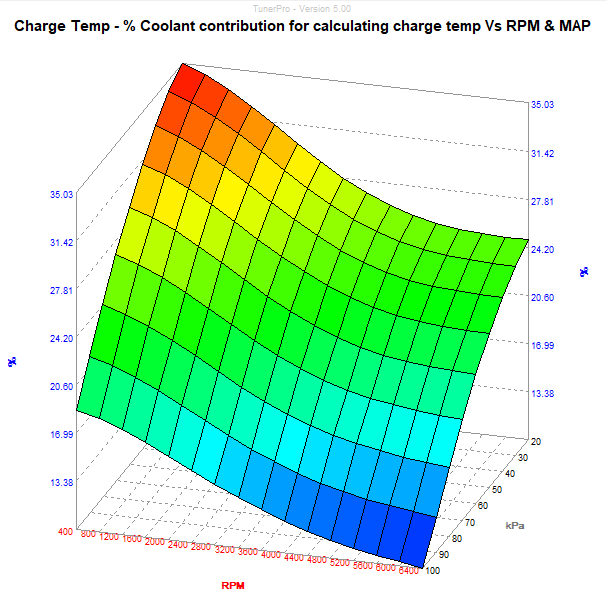

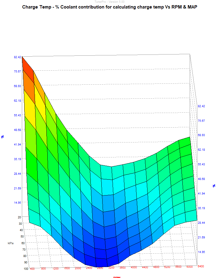

This is regards to the "% Coolant contribution for calculating charge temp vs RPM & MAP" table within OSE12P. I know that smoothing the spark table is something you want to do. That way there are no large jumps in between the spark table cells. Looking at the stock OSE12P % Coolant Contribution Table has not been smoothed out. Is there any reason to smooth or not smooth out this table. I have posted screenshots below.

Which bin is that in? The table itself tells the pcm how much to weight the temperature of the air and how much of the coolant when calculating the charge temperature in the cylinder. As its going to be used as a % reference to two other values, I dont think it is going to make a huge difference, but I cant see any reason not to smooth it, either. Essentially what its mapping is how the coolant has less effect on the temperature of the air when its moving in to the cylinder quicker (less time for the air to absorb heat up from the head and block before it is ignited).

This is from the OSE12P .bin (OSE $12P V112 BLCF V8.bin). So based on your description of what this table does I wonder if the table should have the general shape like the one I have below. The quicker the air is moving through the intake the less time the air has to absorb the heat from the intake, heads, etc. So the higher the KPA the closer to wide open throttle you are and the more you want to rely on the the air temp sensor. The original table has a dip near 2800RPM near 100KPA. Then as the RPM increases toward 6000RPM the table goes back to relying more on the coolant temp sensor again. Based on your explanation on how the table works this does not seem right to me. Unless there is something I am missing here of course.

Another thing at play along with air speed and pressure would be the resonance of the intake.
The dip at 2800rpm on the factory table 100kpa probably corresponds to where the resonance of the air pulses in the banana intake is getting the air in faster as the valve opens
