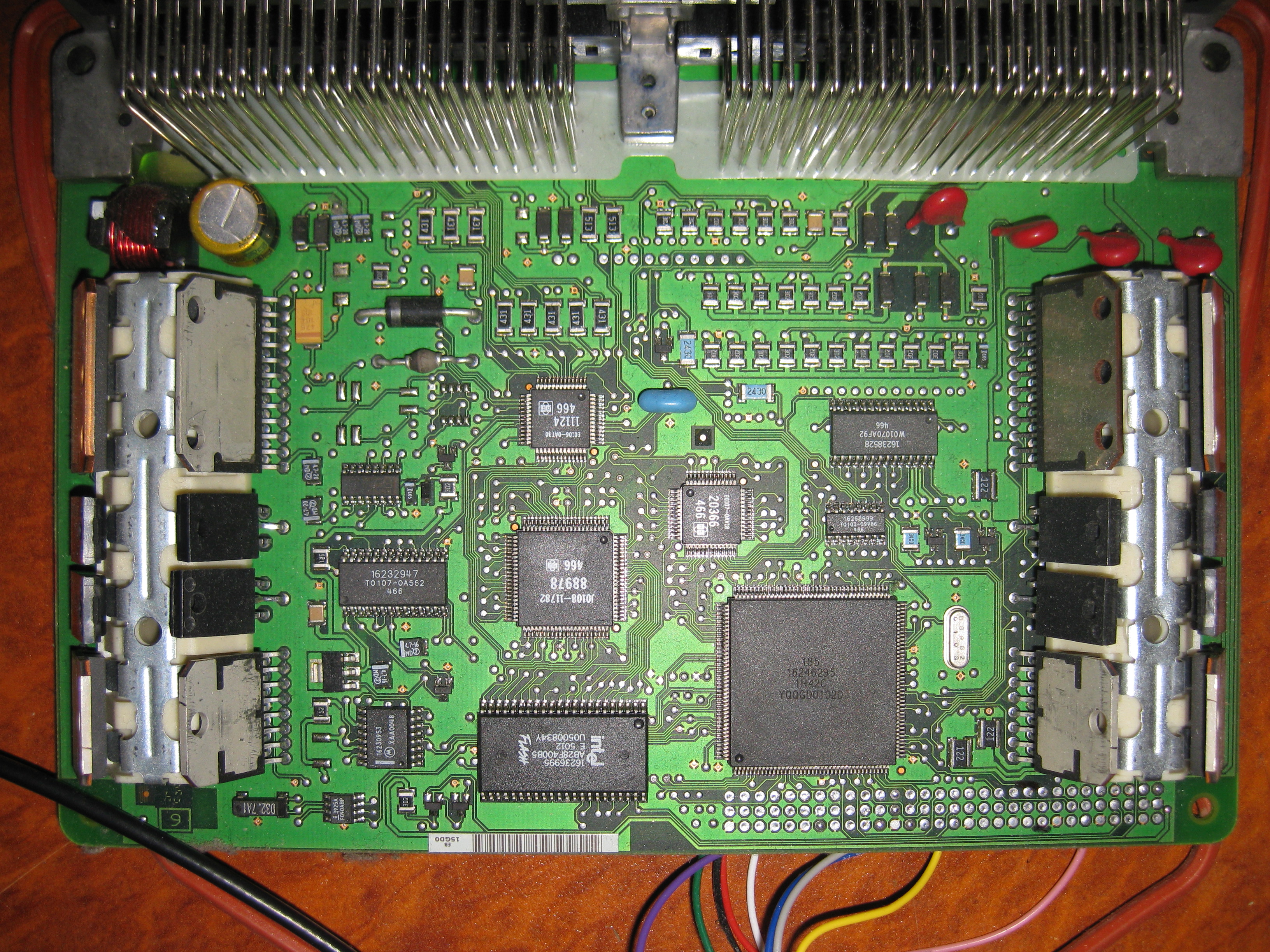

Posts: 9004
Re: PCM Hammer - new ls1 flash tool
Hmmm similar but different.
I'll post the 0411 top side here for easy comparison.

antus wrote:Hmmm similar but different.
Antus, I will get these 4896 ECUs open tuesday. I have had the flu and they are sitting on my desk at work. I can give you any info or test anything you want to these ECUs to further the project.
