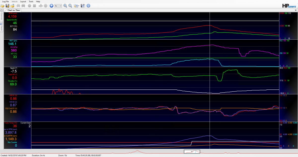

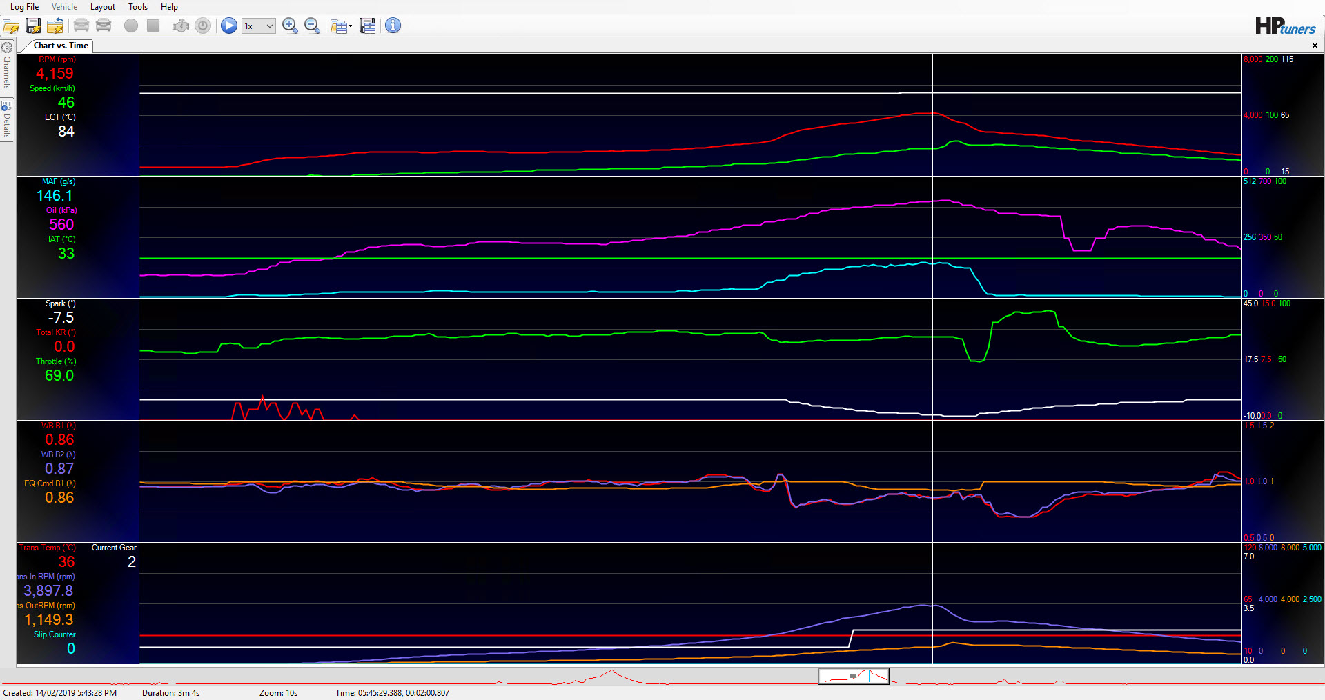

So i got to give the car a naturally aspirated run up the road and back before loading it onto the trailer to go back to my brothers place.
I wanted to see what the fuelling was like after the injector change, see how the trans shift mods went and also to make sure it actually went how it should after the timing kit work.
Its no world beater but its going how it used to again, and at least the 1->2 shift was nice and firm, unfortunately couldn't get a real long run but its better than nothing.
i need to fix a few sensors though, TPS is useless, and im not actually sure if the spark timing is working or not, it didn't drive like it had retarded timing!
i was interested to see though the engine v's trans input shaft RPM's, i will make a calc for these to show slip, and its handy to see the oil pressure too, this will be good to have once the turbo is on it.

The TPS issue is interesting, what do you think is the go there and why isn't it reporting as a fault???
Posts: 10435
Re: What to do with an old flogged out VZ SV6 Ute
no theres like 5 options for TPS, its probably just the wrong one for this ..... same with spark.... no dtcs anymore!
