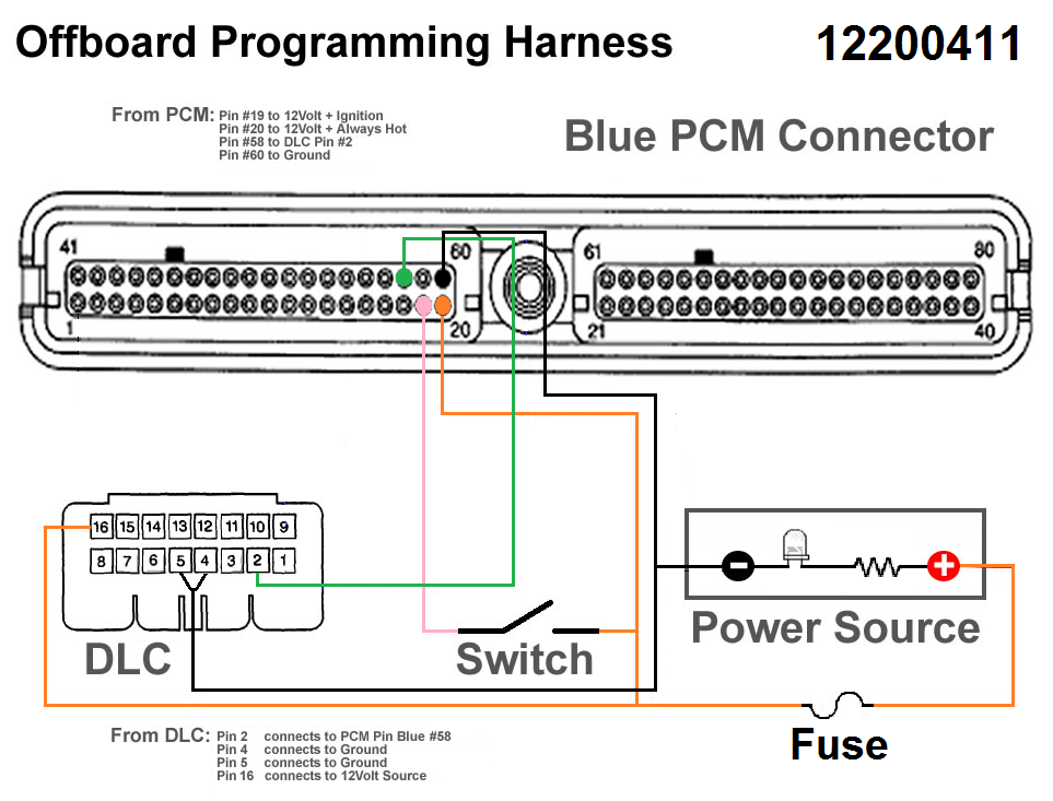

Hi everyone, and thank you to those developing this software! I've been following this thread since I discovered it about a month ago.
Since then, I made a nice little bench harness from parts Ive hoarded and info from Sloppy's site
and have access to an mdi2 at work. Im completely new to aftermarket tuning whatsoever and my budget wont allow hptuners etc but I have an lm7 that I'd like to get running on more than starting fluid.
I have a used 0411 pcm and just tried a read on it today with a fresh download of release 4 on my work computer. Upon clicking read full contents, it quickly makes its way to "...kernel uploaded to pcm sucessfully. Requesting data..." Thats when theres a seemingly long 35sec pause and it says "Something went wrong. Index was outside the bounds of the array. Clearing trouble codes. Elapsed time 00:00:35... Read failed. Error" The first error i see in the debug reads "ReadMsgs OBDError: ERR_BUFFER_EMPTY No payload following read request." Has anyone seen this? I hope its something Im just missing or doing wrong
Thanks in advance for any help!

JonnyB wrote:Hi everyone, and thank you to those developing this software! I've been following this thread since I discovered it about a month ago.
Since then, I made a nice little bench harness from parts Ive hoarded and info from Sloppy's siteand have access to an mdi2 at work. Im completely new to aftermarket tuning whatsoever and my budget wont allow hptuners etc but I have an lm7 that I'd like to get running on more than starting fluid.
JonnyB,
I too am very new to this, and when I did my research for building my bench programming harness, I compared the schematics/pinouts of several bench harnesses and found that the bench harness that Sloppy uses didn't match the others. In the picture below is the bench harness I built. It's very close to the Sloppy harness so you will not need to change much. It works with both the Blue/Red P01's and the Blue/Green P59's. You might make yours like this one below and try to read again? Also, make sure your power supply is something reliable, above 12 volts, and able to put out at least 1.5 amps.:
If others have had good luck with Sloppy's bench harness, please speak up. I have no experience with it.
-David

I am currently using one I built from the sloppy wiki. I just followed the picturesDavidBraley wrote:JonnyB wrote:
- DavidBraley
- Posts: 174
- Joined: Thu Jun 07, 2018 8:15 am
- cars: 1948 GMC
Re: PCM Hammer - new ls1 flash tool
That's good to know!brandonwh64 wrote:I am currently using one I built from the sloppy wiki. I just followed the pictures
