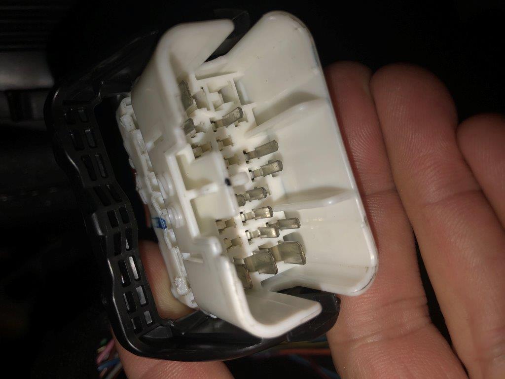

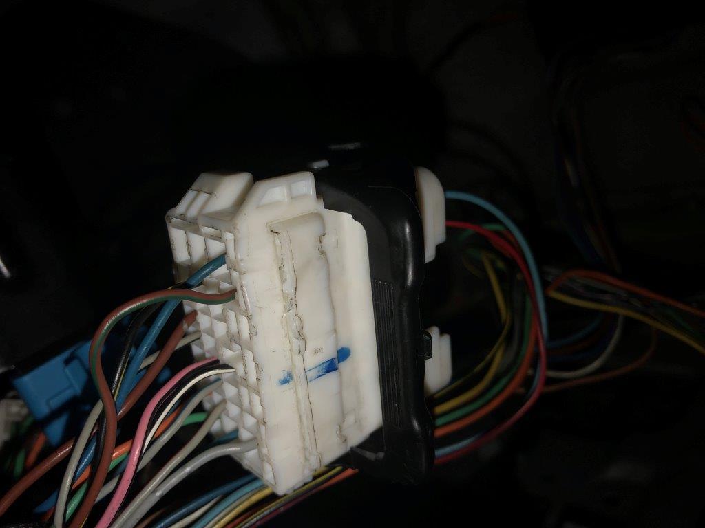

Does anyone have, or can point me in the right direction for a drawing of the Body side of the main engine to body connector for a VZ SV8 sedan.
I am putting a VY LS1 and T56 into a vz sedan body and the plugs are different, the schematics in the gregorys/ellery manuals don't go into this detail.
Also the drawing in the VY/VZ connector post is different to my sedan one. mine is a 26 pin connector with a black swivel locking tab.
I will try to upload a picture tonight.

Hi pman92,
yes it was different, but, I used your drawing (which was the same as my engine side) and extracted the the same circuits from the VZ body plug and installed them into a VY body side plug from the wreckers. (just swapped the pins over).
Turns out all the extra wires are just not needed, and I left them in the original VZ plug, and tied it up under the glovebox.(must be for electronic throttle/traction control etc, and I just done need them for this race car project.
All good, or so I thought..... Turns out the engine control relay ground is different between VY and VZ, no ground means no energised relay, means no 12V power to ignition/injection plugs on the coil packs/injectors. I think that the VY ECR is ground direct to chassis and the VZ is ground through the BCM. so once i converted that back to VY spec all good.
Then I found another difference between the models, the VY engine loom has the PCM ground run back over to the battery/relay side of the engine bay,and it is the brown wire in the plug with the purple start wire from the start relay and i completely missed that when i did the wiring.
So with all that sorted it finally roared into life tonight
I still have some small issues to sort as the alternator wiring is also different as the PCM controls it in the VZ, and my running gear is all VY.
So in summary, can you put VY running gear into a VZ body.......YES
Is it easy..............................................................................NO
