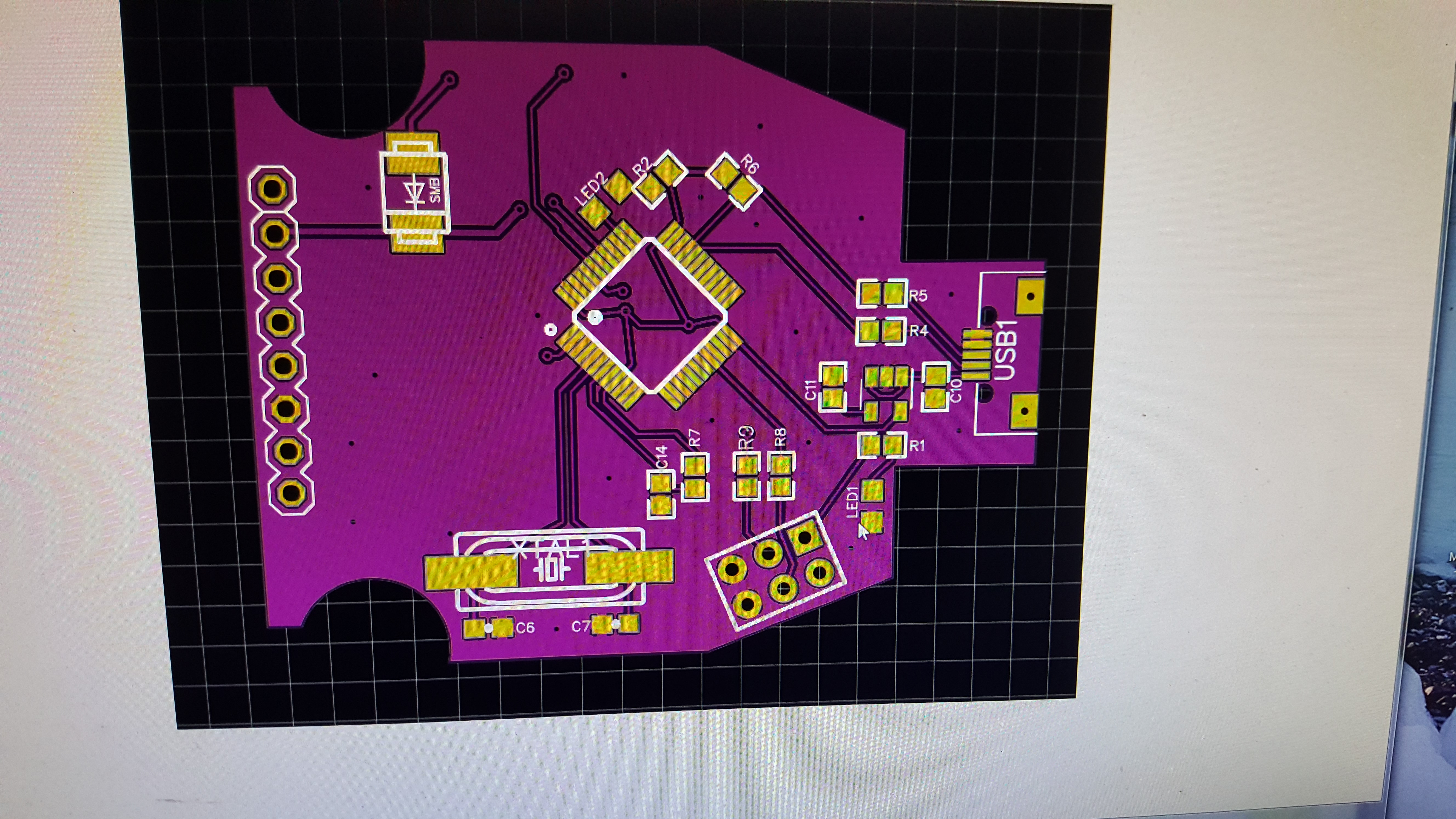

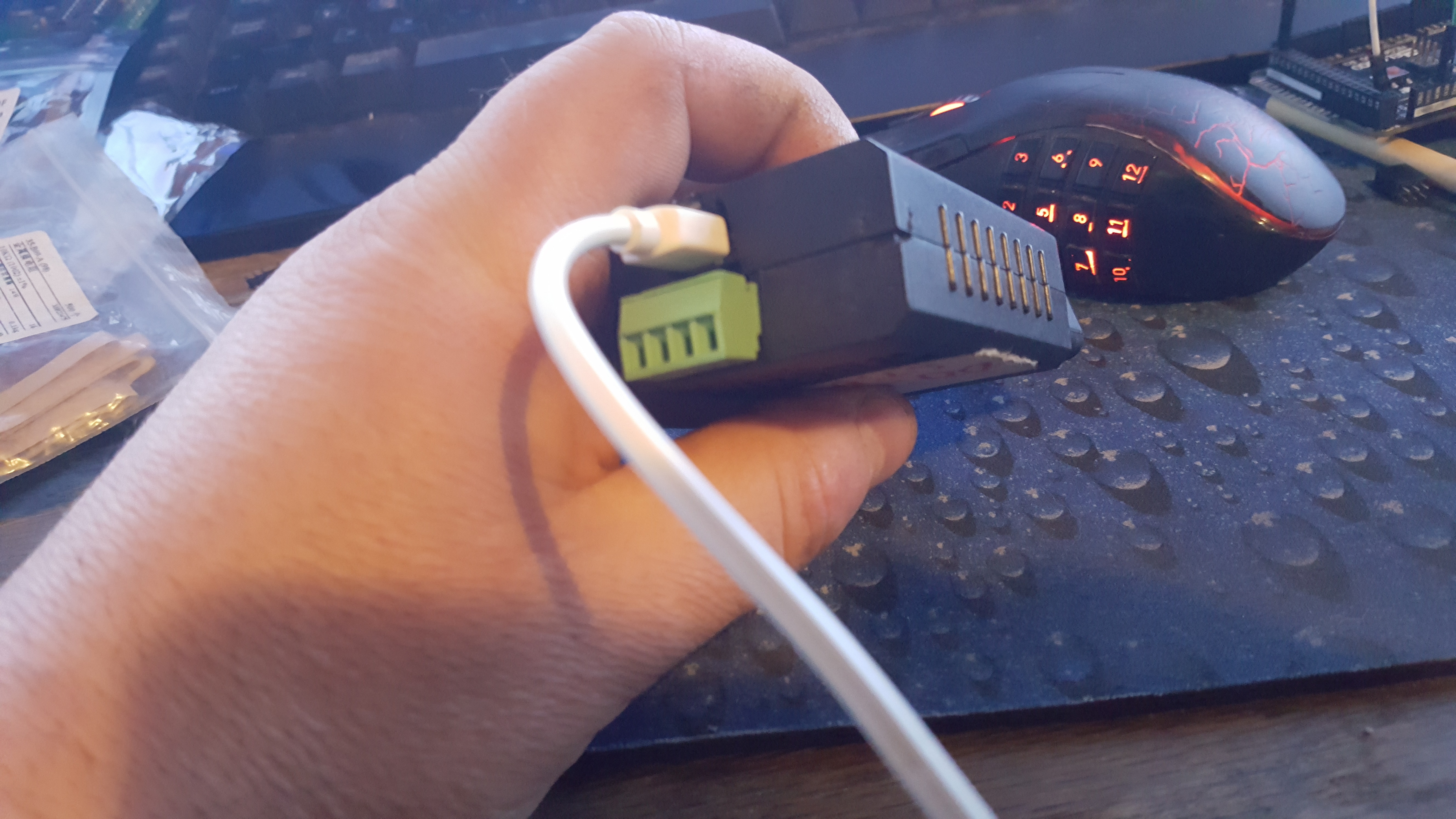

I would have liked to bring this up under better circumstances but an far better alternative to the Allpro has been in the works for some time now.
I have been working with Envious Customs on the development of a tool that could be priced similar to the Allpro but offer AVT 852 level of performance.
While we don't have any thing ready for prime time yet we have developed a number of proto types over the last couple of months while we refined the design and improved performance.
Here are a couple of pictures of some of the prototypes we've been through so far.
This is more along line of what a final production design will likely look like and is the most recent version we are testing.
And here's a short clip of one of the early prototypes to give you an idea of the type of performance were seeing from some of the more recent designs.
