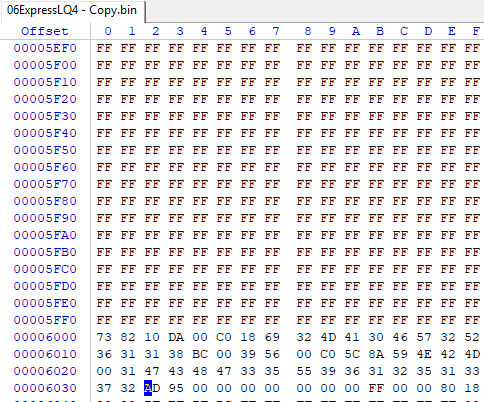

So, I found my VIN starting @0x6021 dump, can you help me figure out where to go next?
31 47 43 48 36 33 35 55 39 36 31 32 35 31 31 33 37 32 0A
