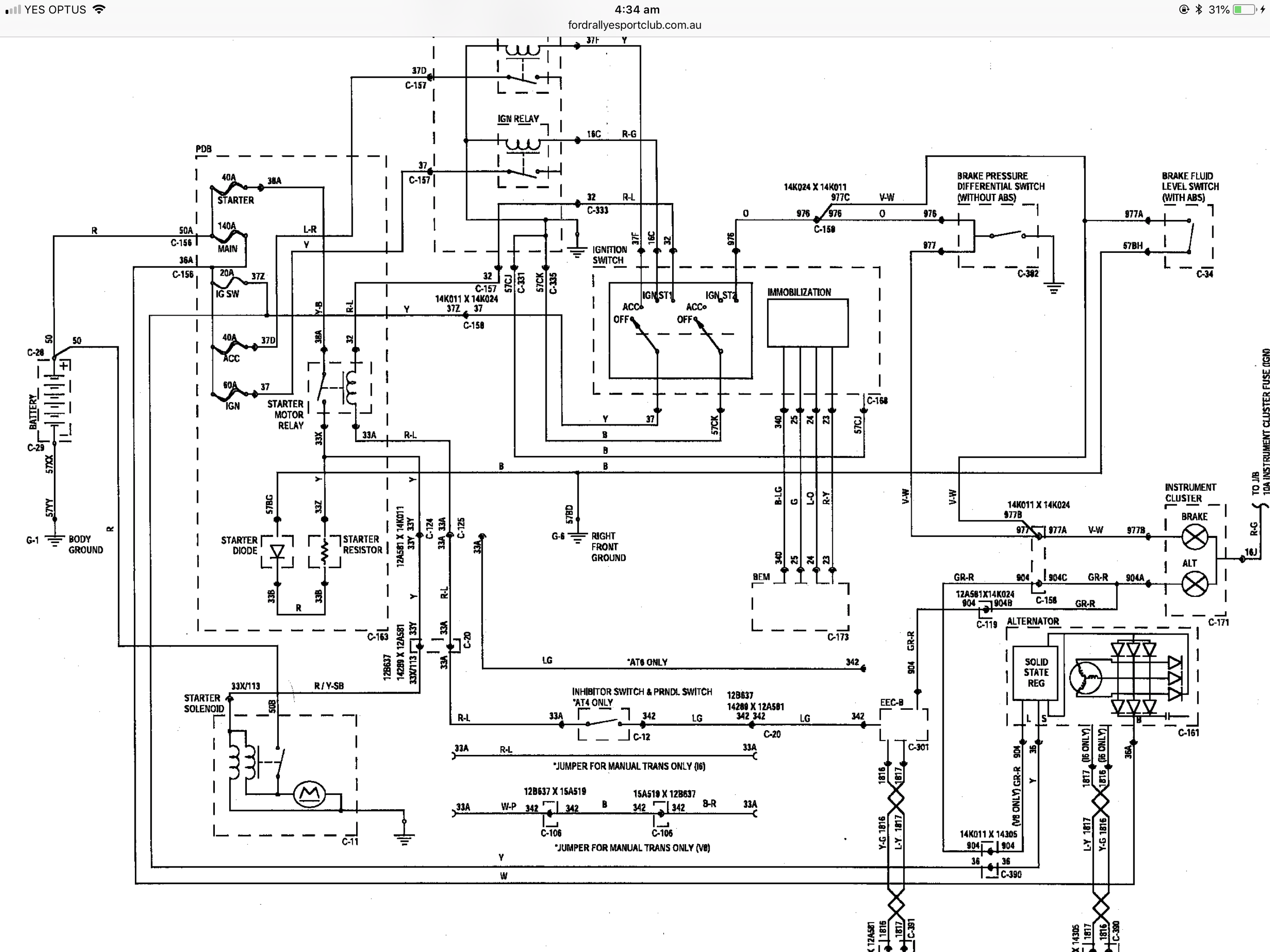

Can someone help me my friend did a bf 6 speed manual conversion the car was 6 speed auto where does the start signal come from can’t find anything in diagrams
holden08
Posts: 175
Joined: Wed Jun 16, 2010 9:17 am
Location: kempsey nsw
Re: BA-BF -FG Falcon ECU Bench testing harness
Post by holden08 »
Looks like B04 but it doesn’t match for 6 speed auto

Just transplant the whole loom. Be much easier. You'll be missing half the loom connections.

Sorry to convert to a 6 speed manual do you mean the whole engine loom and dash loom the 6 speed manual loom doesn’t match up with the dash harness

holden08 wrote:Sorry to convert to a 6 speed manual do you mean the whole engine loom and dash loom the 6 speed manual loom doesn’t match up with the dash harness
I think most the guys just swap the whole lot. I've not personally done it but the last workshop I spoke to having problems converting to manual told me it only took them 2 hours to pull the whole thing and install it from a half cut. If you are paying by the hour these headaches quickly make it cheaper to do so, you could burn a whole days labour trying to patch a loom only to end up swapping the whole thing in the end.
You could make it work but I don't think anyone on here will have the answers for you. I guess it depends how valuable your time is.

Got it working just pulled the auto wiring out for zf6 speed and looped the can bus
