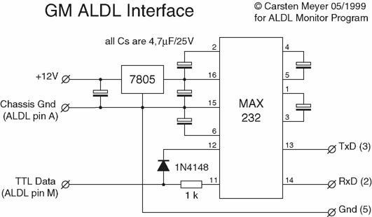

I would love you input on the transistor version of converting the ALDL to Serial.. with the 8192 I always used the MAX232 way of doing it. works well but components are getting expensive and Genuine MAX232s aren't cheap, last time I made a transistor circuit was for the 160baud ALDL in my old VN :punk:

this is the circuit I was using before I moved to a dedicated FT230X circuit and I never had an issue with it.. at least for the time being I might make one up with this, only because I have 50 odd knock off MAX232 chips around here :lol:
