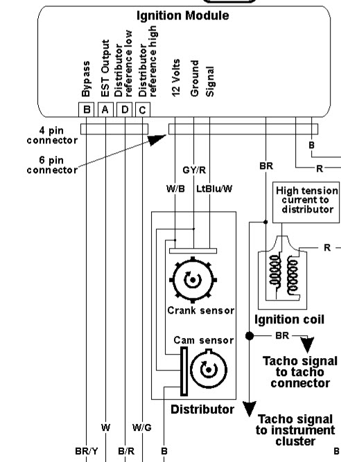

- The vs dizzy has a 4 pin plug - the vp only has 3 (can anyone help me wire up the 3 to the vs dizzy please)

with the 4 wire plug, i believe that is the series 3 VS which is the same as the VT series 1 motor.
If that is in fact correct, in the below picture, the three wires going from the crank sensor to the ignition module should be the ones you need - someone else please correct me if im wrong.
my diagrams show the colours should match, its just the 4 pin plug has the extra black wire in it for the cam sensor.

Had a quick look and the vp wire and the vs dizzy wires and they are different colours (the blacks there and I understand I do t need that one) go looms spears to be a light green, red n black or grey, and white the vs has Black, green, red, blue...

Trying to figure out which wire would go to what?

Sure it’s the right connector as they all have the same coloured wires light blue with white trace, grey with red trace and white with black trace and the vs/vt one has the added black for cam

Yeah 100% the the 4 wires coming out of the dizzy army the same colour as the plug.
