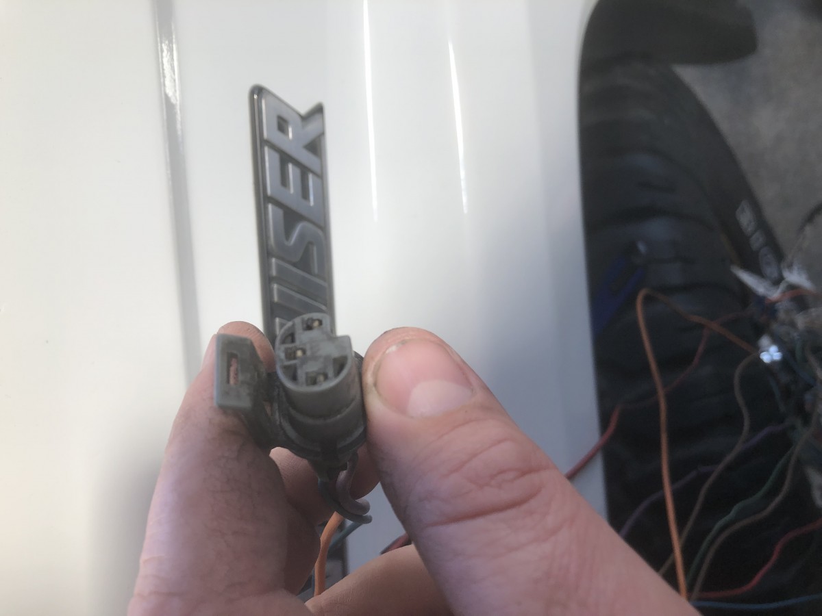

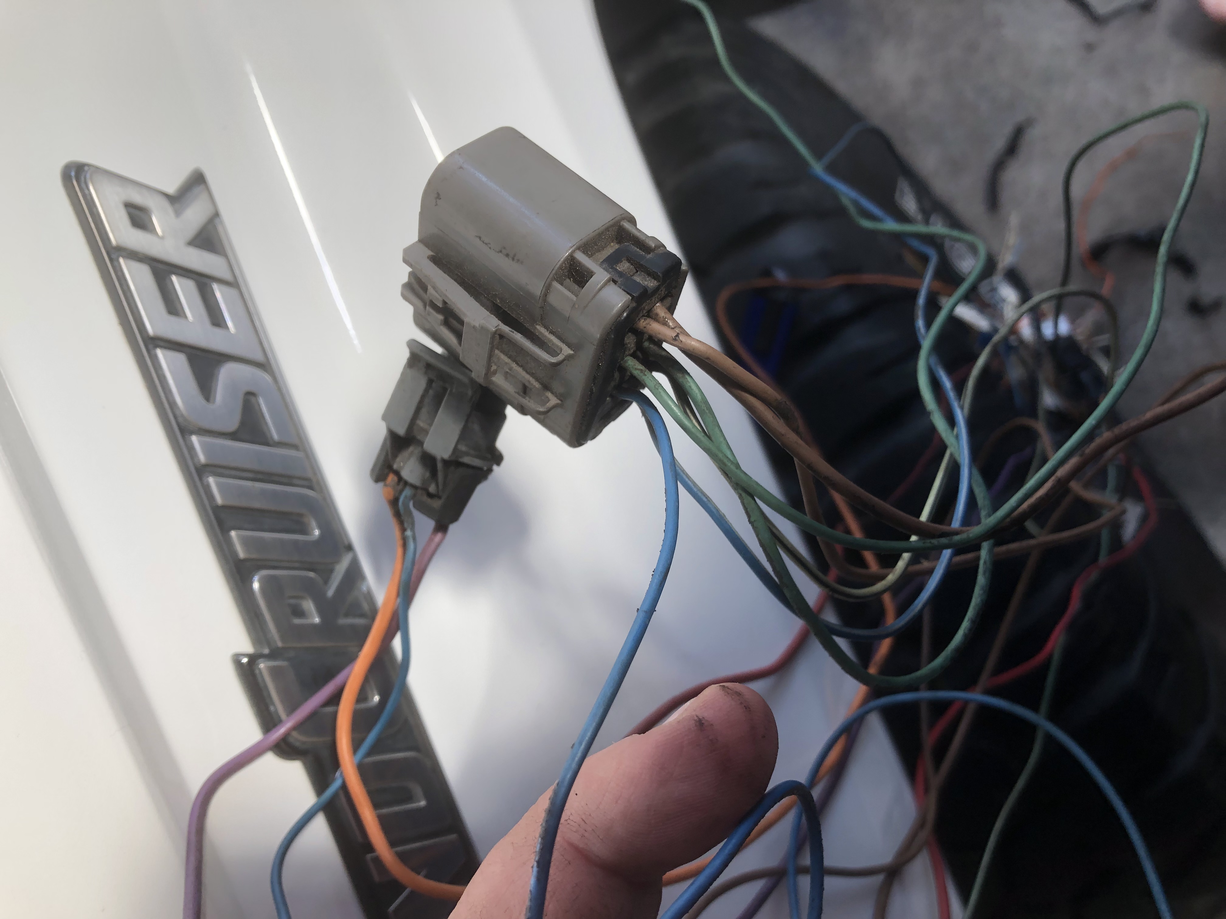

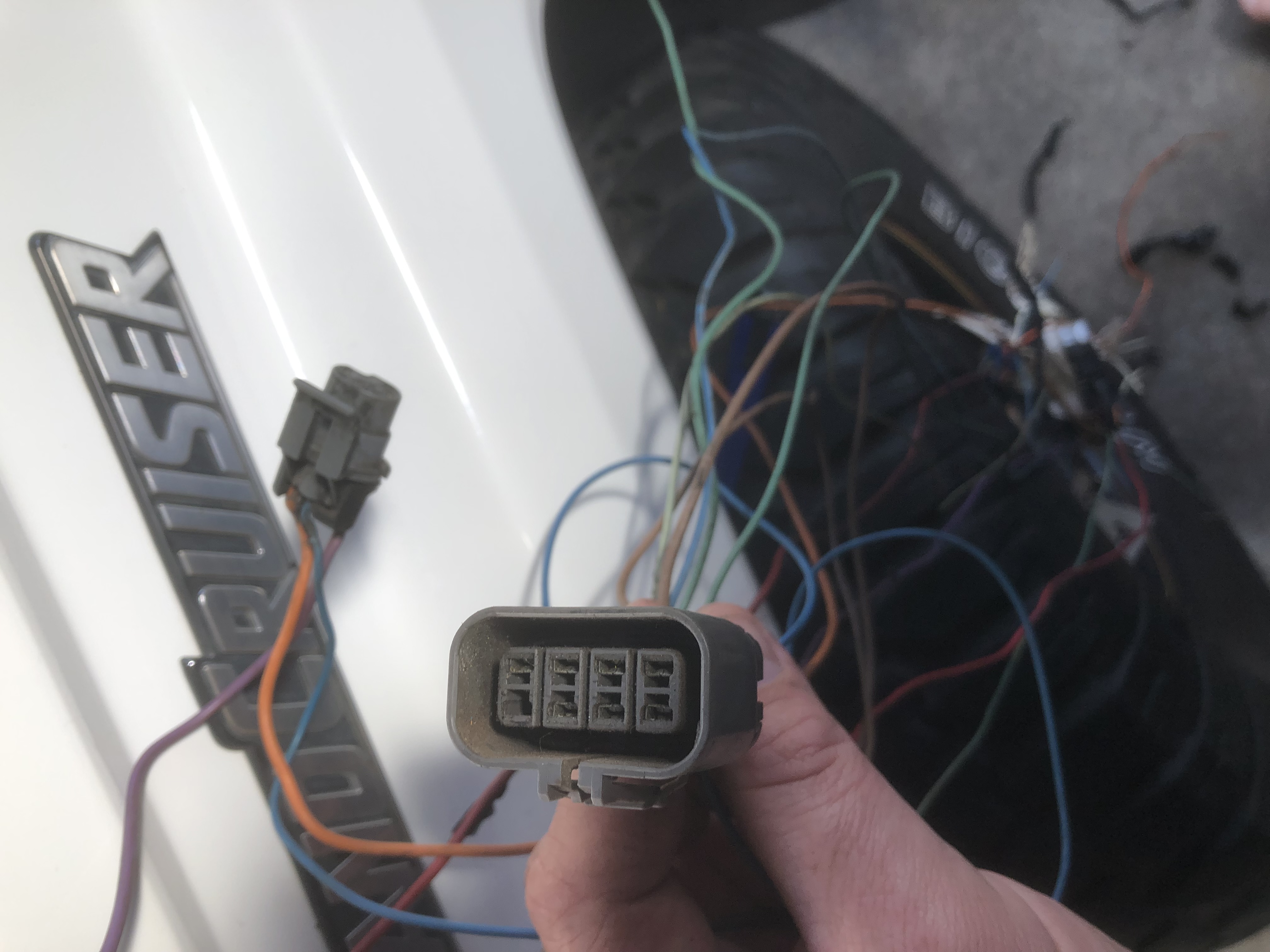

Another question in regard to the air temp sensor and o2 sensor wires - I’m sorting the loom out and found 3 wires to the sensor plug - 1 is a power supply(purple wire) then a blue one that runs to a rectangle plug (see pic) then an orange one that runs back into the loom - can some tell me how this all Works (that rectangular plug doesn’t go to anything that I have) and the purple wire in last pic is o2 wire?

The 3 wire plug is oil pressure sensor just use the thin wire to feed the oil light the other 2 went really needed they are just a backup power feed for the fuel pump

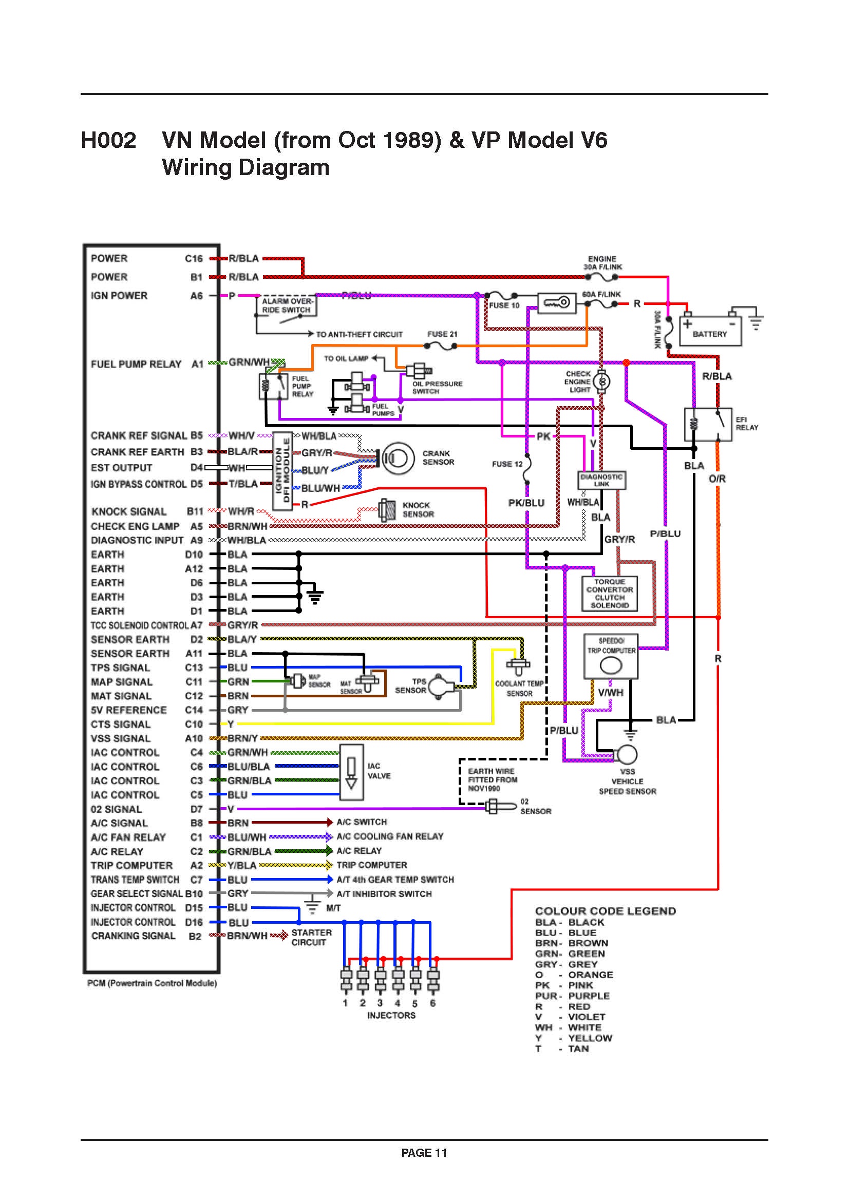

Re: Vn/vp Wirring diagrams
VN VP V6 ECU pinout
- VN VP v6 ECU pinout.pdf
- (448.73 KiB) Downloaded 862 times

Can anyone confirm this is the correct Wirring to power up the ecu and system On a Vn ecu and Wirring loom.
- Purple/violet wire goes to pin 30 on relay (plus a positive supply wire to fuel pump from this same pin)
- relay pin 85 gets the green with white trace wire (this should be the wire that switches on relay wen ignition on) this is on a timer wen ignition is first turned on to start fuel pump?) not getting anything from this wire.
- relay pin 87 gets orange wire from oil pressure switch - the other side of oil pressure switch is direct to battery +(switches relay on once oil pressure is up) goes to relay pin 87
- relay pin 86 to body earth?
What am I missing? The red with black trace is getting a constant 12v from battery - the red wire is getting power from 2nd relay which is switching on and supplying power wen ignition is on. Earths are grounded. Igniter box is connected, dizzy is connected, coil is connected n injectors all plunges in etc....
Cheeeers
Cheeeers
Re: Vn/vp Wiring diagrams
Fuel Pump Relay
- Relay pin 87 the orange wire should be live (fuse 21) when the key is on
- Relay pin 30 gets its power from the when Relay 87 is energised by the key. With the key off there should be no power at the purple/violet oil switch wire.
- Relay pin 86 connects to relay pin 86 of the EFI relay circuit, then eventually goes to earth.
- Purple/violet wire goes to pin 30 on relay YES - (plus a positive supply wire to fuel pump from this same pin, NO)
- relay pin 85 gets the green with white trace wire YES - (this should be the wire that switches on relay when ignition on NO ) this is on a timer when ignition is first turned on to start fuel pump? NO) not getting anything from this wire. This circuit only goes to earth.
- relay pin 87 gets orange wire from oil pressure switch YES - the other side of oil pressure switch is direct to battery NO (see Side Note) +(switches relay on once oil pressure is up NO) goes to relay pin 87. Pin 87 is live when the key is ON, then this in turns powers the purple wire and the fuel pumps. The orange wire goes to the oil pressure switch and to fuse 21 and the 60A fuse near the battery.
- relay pin 86 to body earth? Not directly, it first needs to join the the EFI relay pin 86, then it runs to earth.
SIDENOTE: The oil pressure switch is a backup for turning on the fuel pumps only if the Fuel Pump Relay can't turn on due to some problem getting power to the relay.
