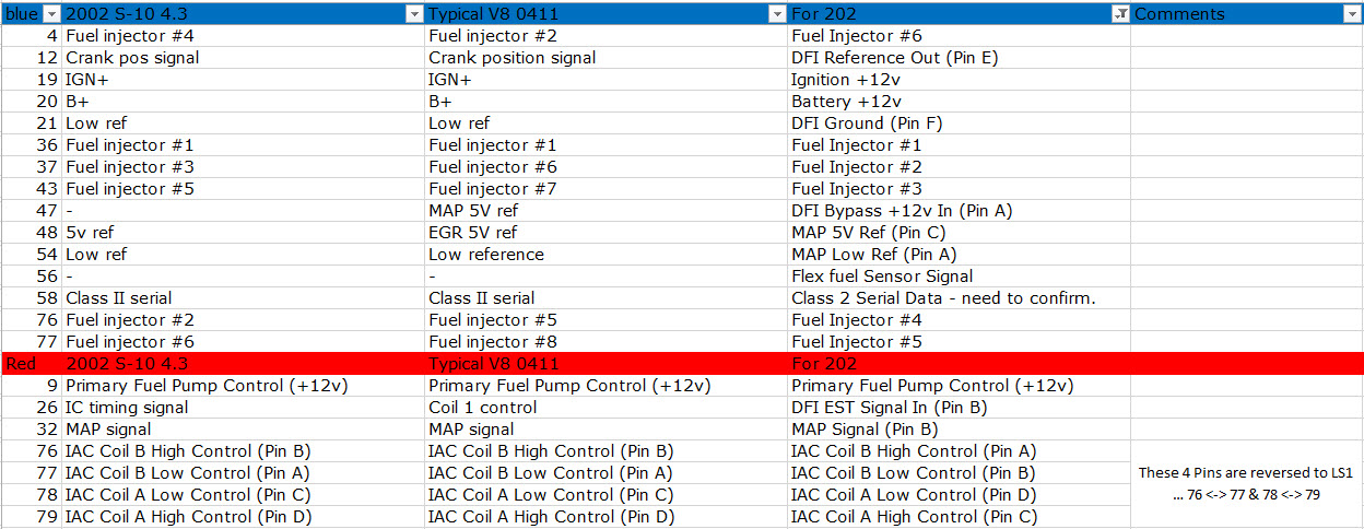

so now i've removed the delco and its loom, and started fitting up the 0411 loom, so far most of it is plug and play, MAT, TPS, IAC, and injectors are all the right plugs, MAP wiring colours are the same as the delco wiring colours, and the same pin outs, so that was a straight solder together job (just so i can use delco map sensor which i have, one day i'll probably modify the manifold to fit factory LS1 map sensor.
the injector wires are long enough but the power wires are too close together so i've cut all them and will re-run a new power feed.
i've worked out the wires needed to interface with the DFI module so just need to wire them up to the plug ....

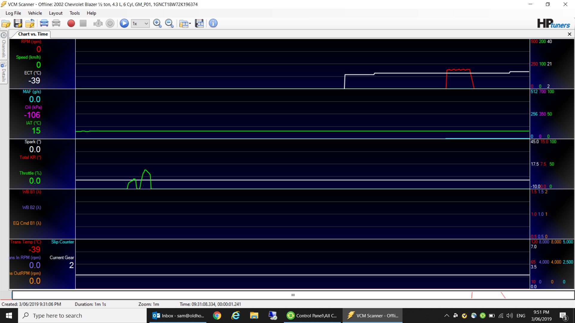

well i have some sensors reading, including the rpm signal from the DFI

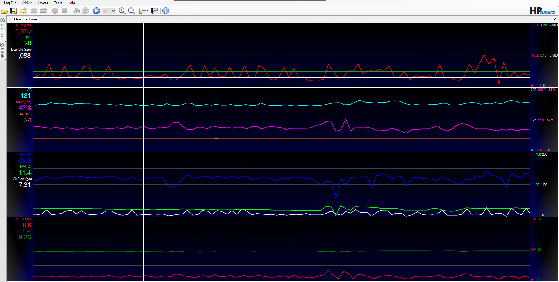

There has been plenty of progress on this, i have successfully got the engine running and i believe the 0411 pcm is controlling the spark, but it is also missing a bit and running pretty rough, but i believe this is my crank trigger more than anything else, so i need to get something a bit more reliable before i can safely say it all works properly.

you can see from this log that its got pretty steady tps, spark, iac etc and then the rpm just jumps up and down.
I think its getting trigger issues (and scope seems to confirm some odd readings) so i am putting a stop to progress until i can get a proper trigger wheel on it because its hard enough to get a new combo working without trigger issues
but i can definitely confirm that the est input to the dfi module is showing different spaced pulses so its certainly controlling timing by the looks of it, and the timing light seems to match the commanded spark advance.
i also found that the IAC pin outs are backwards to the earlier model so thats something to keep an eye out for.
i've been making a running list of what has changed for the 202/DFI setup, and any other wires i have added/changed or identified, eg. i dont have a cam sensor so using its +12v for the DFI bypass connection.
