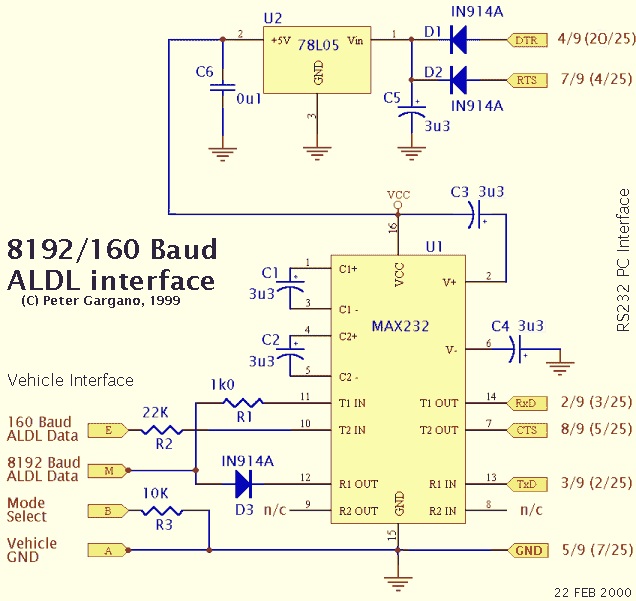

Here is the aldl citcuit that worked with Arrow ..other cables bought and diy were not successfull ...in fact they made the lights disfunctional perhaps noise?
I supplied the 5 volts via the 12 v on the car aldl port and used a 7805 regulator .
I used a usb to rs232 prolific cable for the computer end.
I can only hope that this may prevent somebody from having similar issues .

Even the old techedge 2 transistor design works with the arrow software and the usb aldl cable from here

Yes I had some success but the circuit posted gave much more consistant results .
I may have variables that are unique however,just reporting my experiences with almost bricking my cluster.
