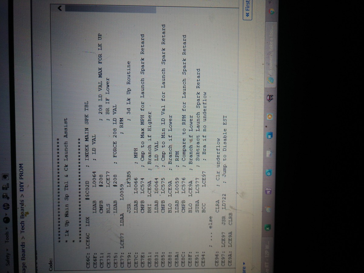

It's been a really long time, but from memory when I tried to get spark cut working on the '808/'165 I found that changing the dwell time via software was not instant and it started to do some really odd things. Curious if you have you looked at what dwell does on a scope with the code mod you mentioned? I couldn't find the dwell patch code in your link.

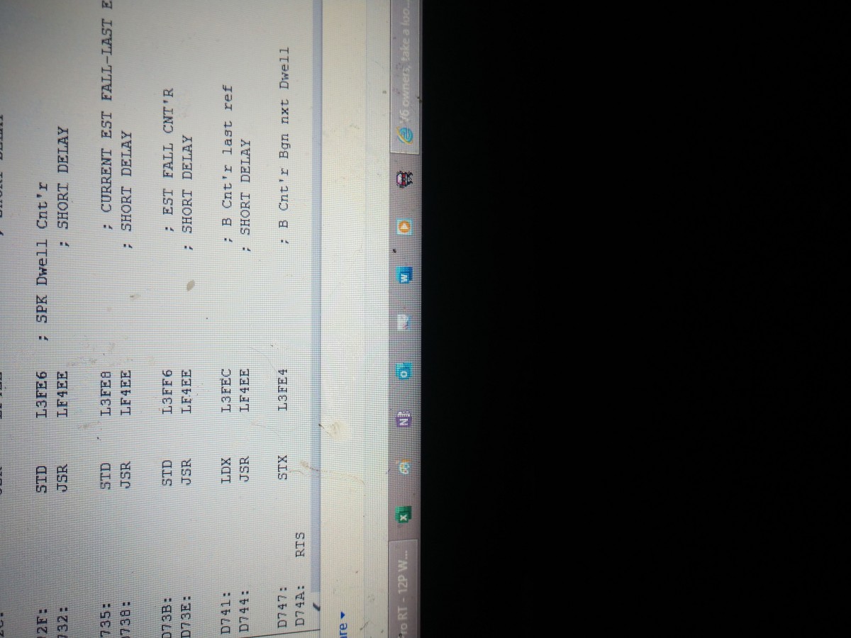

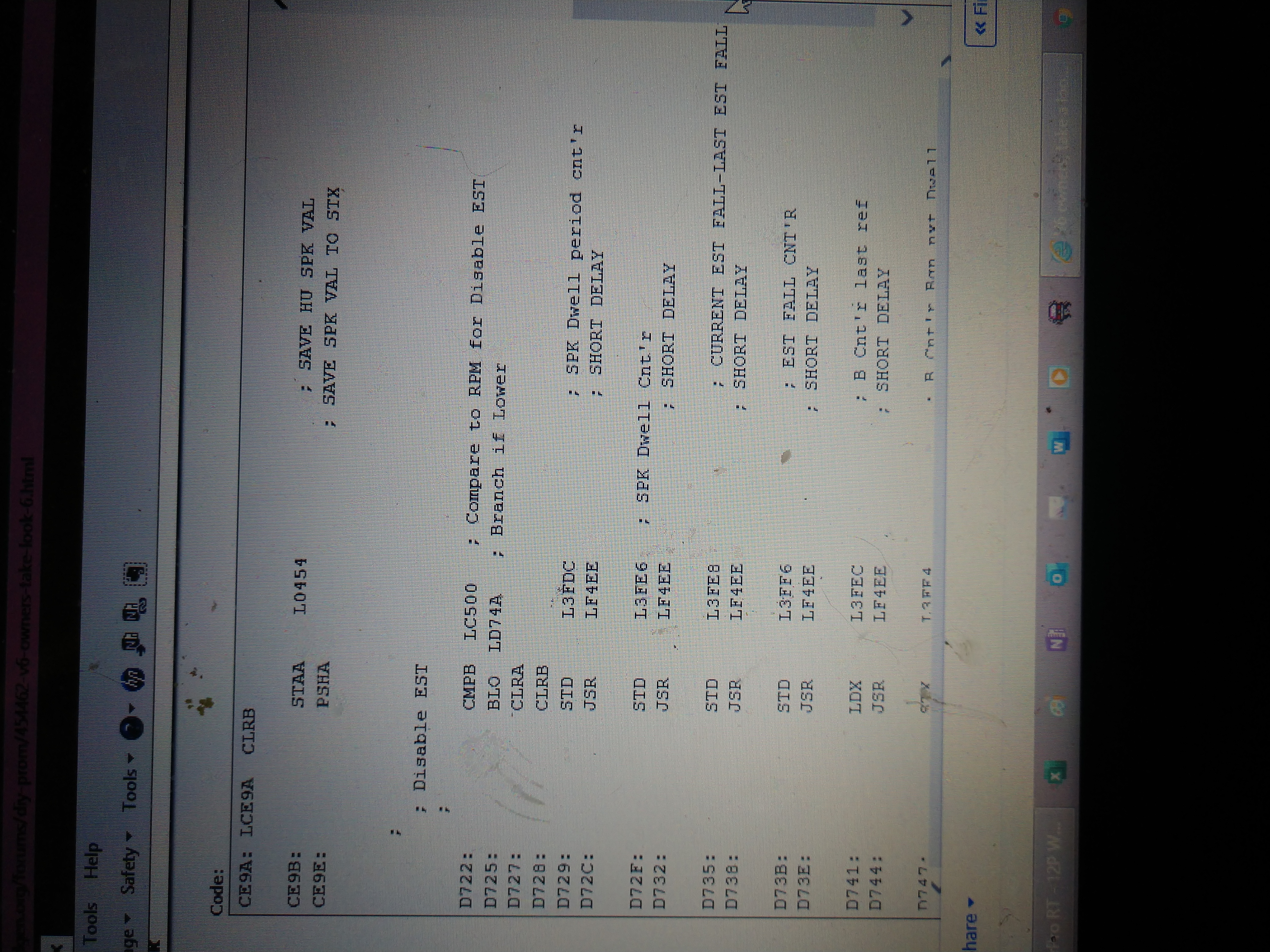

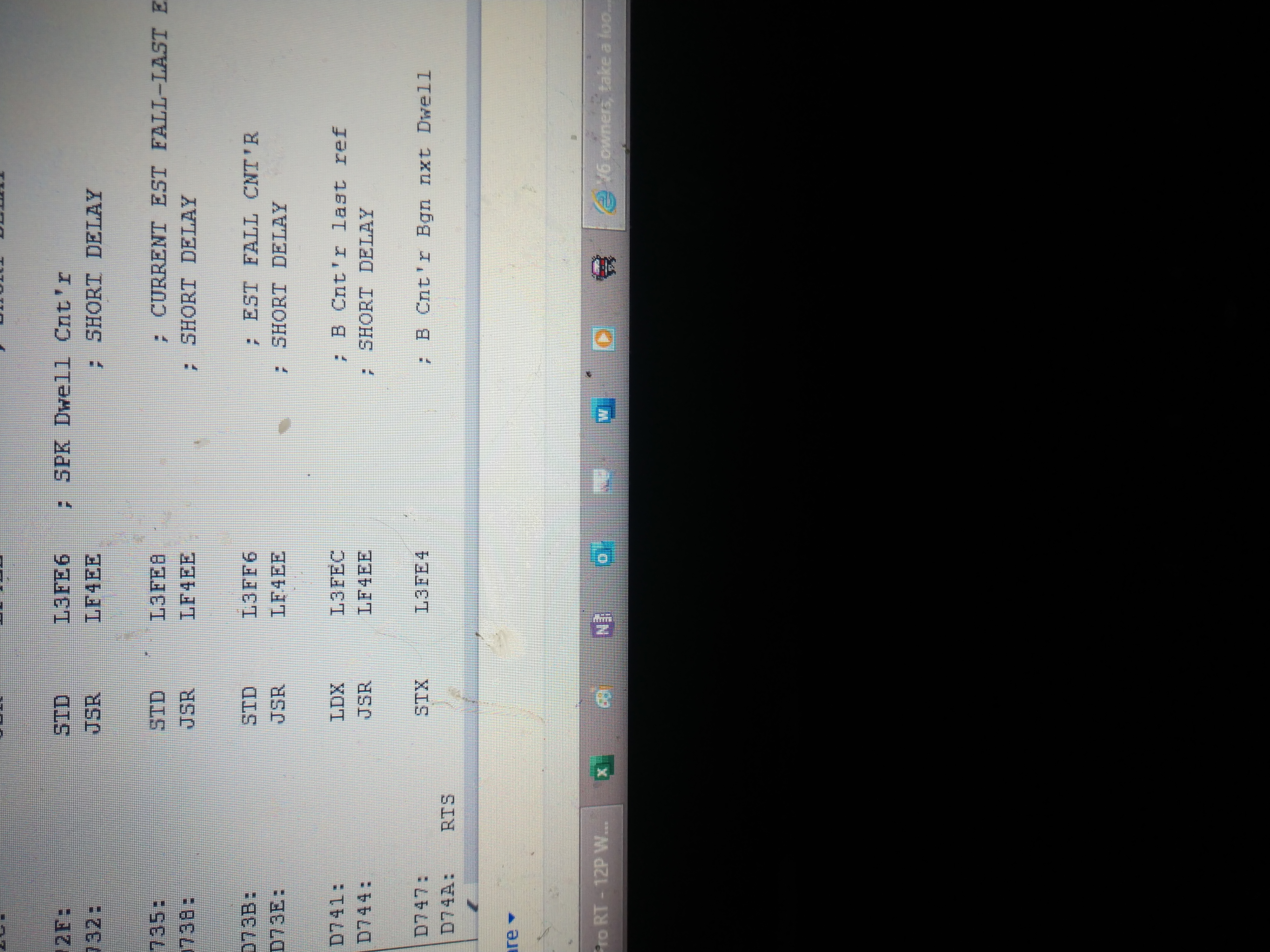

I took some screenshots of the code, but the gist of it was he had the EST signal held high and it caused the coil to misfire.

Yeah so thats the approach which we dont think the hardware allows to work like you would think from reading the code comments. I think we need to see a trace of the signal coming out of the ecm when running that code on the bench. Were talking years old investigation now and it looks like nobody saved the data, but we believe setting those registers to 0 didnt cut the spark and behaved abnormally. Have you tested it?

I do not have the know-how to write that to the code. The person that wrote that patch had it working on his TT Camaro, and a few others have used it. Originally BL85c wrote it to be used in 6E, which is used with a 165 ECM. A friend of mine was looking into writing that patch into 12P but it's a slow process since he has no notes to use.
