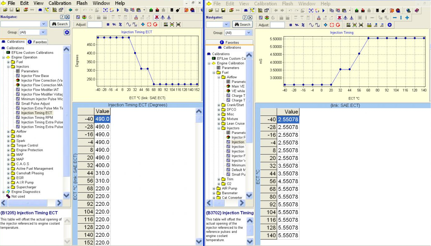

Informative video, thanks, I'm surprised at how large the scale of crank timing ended up being with the temperature change, way larger than I would have thought.
I'm keen to see what the crank angle / timing ends up being when changing the EOIT 4 hex bytes at a time.
Thanks heaps for this.
One thing that does make me wonder though, is the reference used by EFILive regarding the math equated output figures used, eg: the scale of 2.55078 at low temp to 5.55078 at full temp, those figures are displayed as being a measurement of mS, which I understand to be milliseconds.
If that were the case, the crank angle at which the EOIT occurred would differ as the rpm altered.
On the setup you're using in the above video, does changing the rpm alter the crank angle of the EOIT.
Also when looking through the later LS2 tunes, I notice that the EOIT is oddly familiar to the earlier LS1 with regards to the plotted figures when displayed in the graph screen.
Also as a side note, changing the final figures of 5.55078 decimal / 058D hex to 0595 hex, has my L/100 figure drop by .3 /100, even when occasionally throttling hard off the line at times, and that's city driving, not highway.

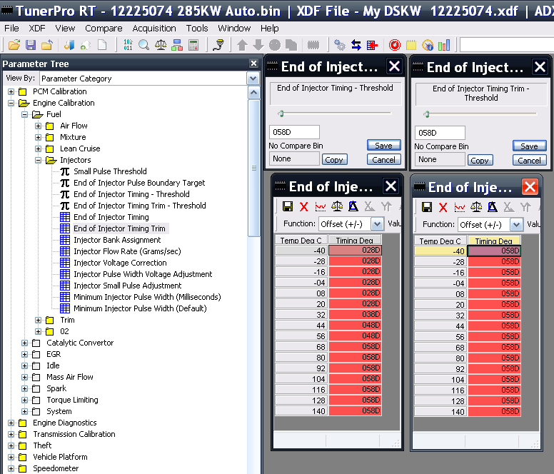

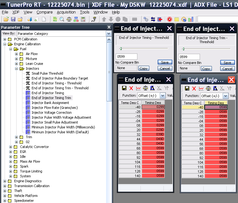

Still experimenting with the eoit settings, along with the 2 extra 16 bit blocks after the boundary block.
Not tried the settings on a roller yet, though the 2 extra blocks after the boundary definitely feels as though it's also further affected part and wide open throttle for the better.
STD settings, in hex view.
Current settings, in hex view.
Overall drivability and economy has improved further still.
Highway economy has reduced .9 L/100 further than it's best ever with above settings.
