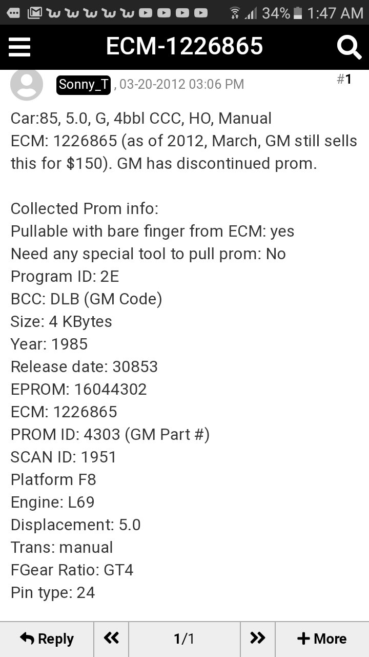

Sounds like that ecu doesn't have aldl here's so more info on it
Posts: 5630
Re: Trying to communicate with 1226865 ECM
There is a 2E xdf for old v4 and a v5 version and ads file here that may work if you import ads in tunerpro and save as adx.its for a v6 but the aldl hopefully is the same if it does happen to have it

I have a feeling it may not be the same 2e

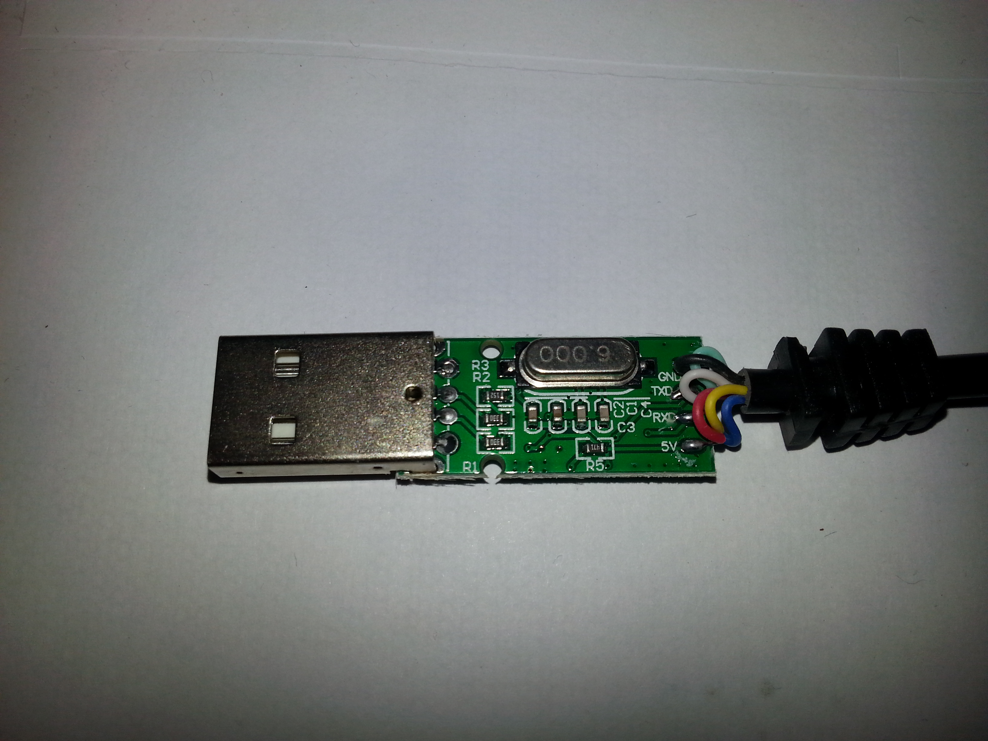

Well, I've had enough. Let's prise open the case.
Ah, so I DO have an FT232BL chip. And there's not that much in the way of componentry around it...
Reverse side:
Not much there either. Can anyone comment if this looks viable, or have I been sold a pup?
Hi ND,
What you have there is a bare-bones FT232BL circuit that lacks the configuration EEPROM portion. So not configurable at all. Even if it were the full circuit, this part doesn't support the RX inversion feature you need. So your options are to either change to a (genuine, not fake) FT232RL converter, or add a second transistor circuit to provide the inversion in hardware.
Joe.

Do I need another transistor circuit to invert the signal? I thought the 'Q1' transistor (2N3904) in the WinALDL circuit already inverted the signal? I was investigating inverting the signal so I could omit the transistor circuit and reduce the number of variables...
I guess what I'm getting down to is: does anyone know if this circuit should be working, even through the FT232BL chip?
Thanks for your continuing help guys!
