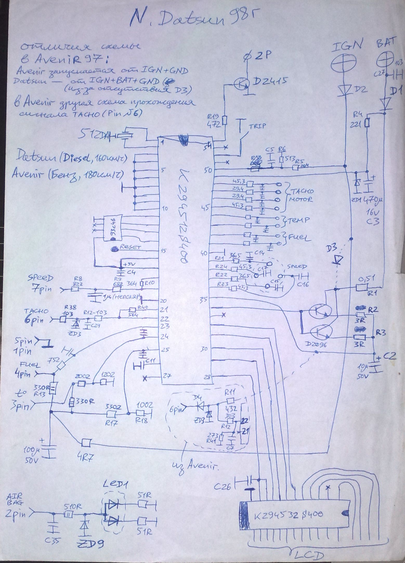

The 6 pin programming adaptor he sticks in the back goes through onto 6 pads on the PCB which are directly connected to the EEPROM and reset pin of the main IC. I haven't got his adaptor or software so I un-soldered the EEPROMs and used my TL866 to read them.
I've also attached a partial circuit diagram (comments are in russian) I found elsewhere online
