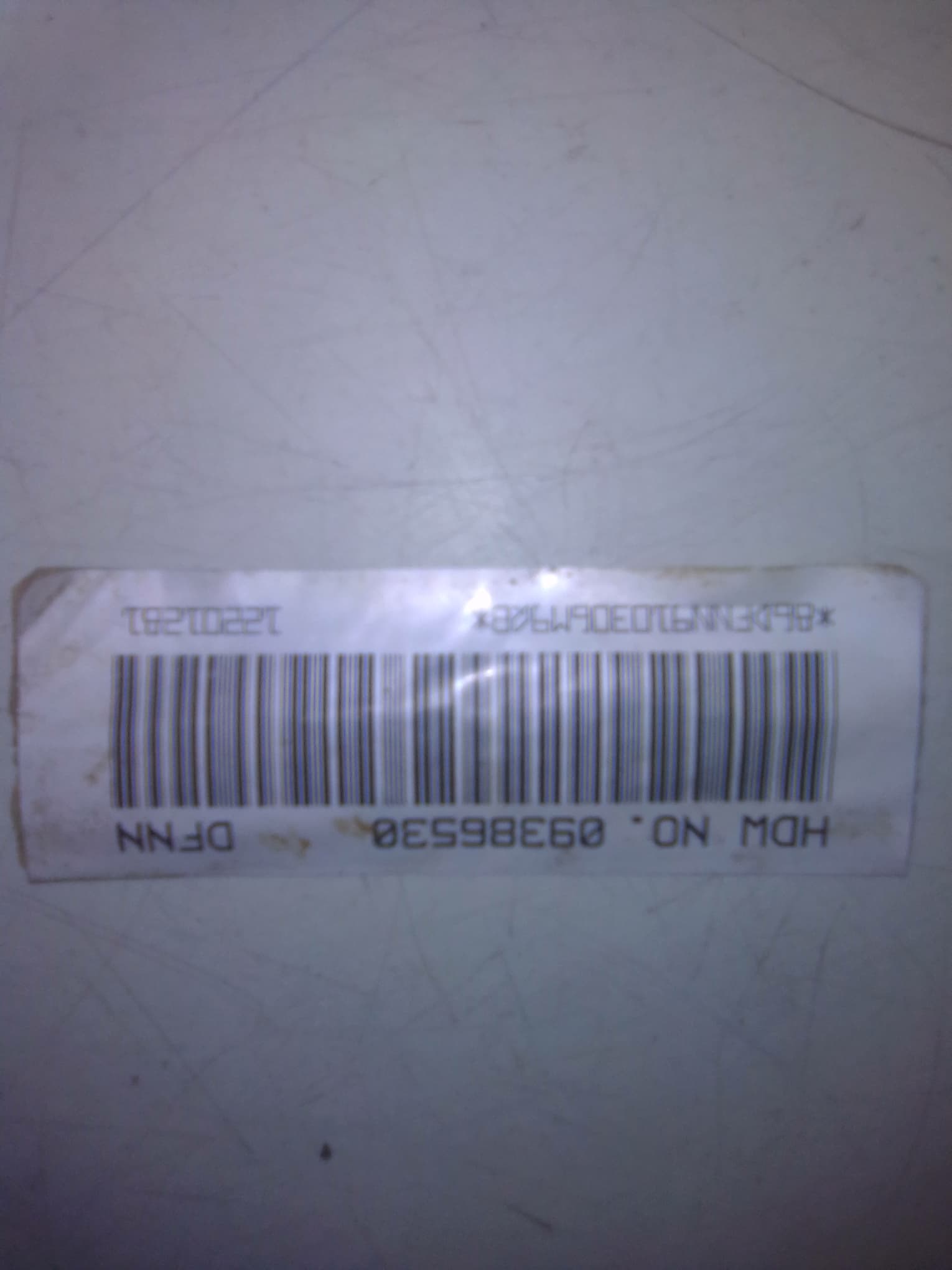

Hello guys,
First of all, I want to say Thank You for All the work you have been doing…
I´m new here and I just found info about this forum and software, but I’m pretty sure that has taken you guys many hours work to do this…
I´m new in the ECU/ECM mod world, so if I do some dumm questions, please bear with me. I’m still learning (and there is a Lot to learn…)
I live in Mexico, but I’m from Europe and I don’t have experience with Trucks/SUVs.
I just found your forum and software info, because I need to read/write the ECM from a 2001 Silverado w/ a 5.7L Vortec engine, and the ECM seems to be LS1 type.
The ECM has some numbers, but I think this is the proper “GM Number”: 12201281
I would like to know if using PcmHamme and ScanTool SX, I can read/write this ECM to change the maps/calibration in order to adjust the modification that the owner wants to do by replacing the camshafts with some “racing” type ones and we need to adjust the ECM parameters so that the truck doesn’t shuts down all the time, and probably some other changes…
I would also like to ask if anyone can give some tips on the best and easiest software to use to make these changes.
I have some tools to read ECM/ECU, but they are more focused in compact cars and they are also more for the European type cars…
Regarding PcmHammer, is this mainly/only for GM ECMs or is there any other brand/ECM types we can use the software? (I still need to read al the info about this Great Software)
Thanks for the support guys…

Hi all,
Boxsport,
First off, welcome to the forum.
As for the PCM , the number you want is the Serv. No. 12200411 which is followed by a 4-letter code - such as DFNN.
As for the OBDLink Scantool SX, YES it will work.
For tuning the engine, you would need to get TunerPro RT v5 and become familiar with it - assuming you aren't already.
And, yes, it is ONLY for the GM P01 and P59 PCM's - sorry.
Hope this helps,
Mike
Boxsport,
Hope this helps,
Mike

Hello there...
Thanks for the quick answer...
Ok. you gave me a Big Smile....
This means i can use all the tools i have...
I will need to see the software and get "inside" of it...
The ECM ref/codes are in this picture attached...
