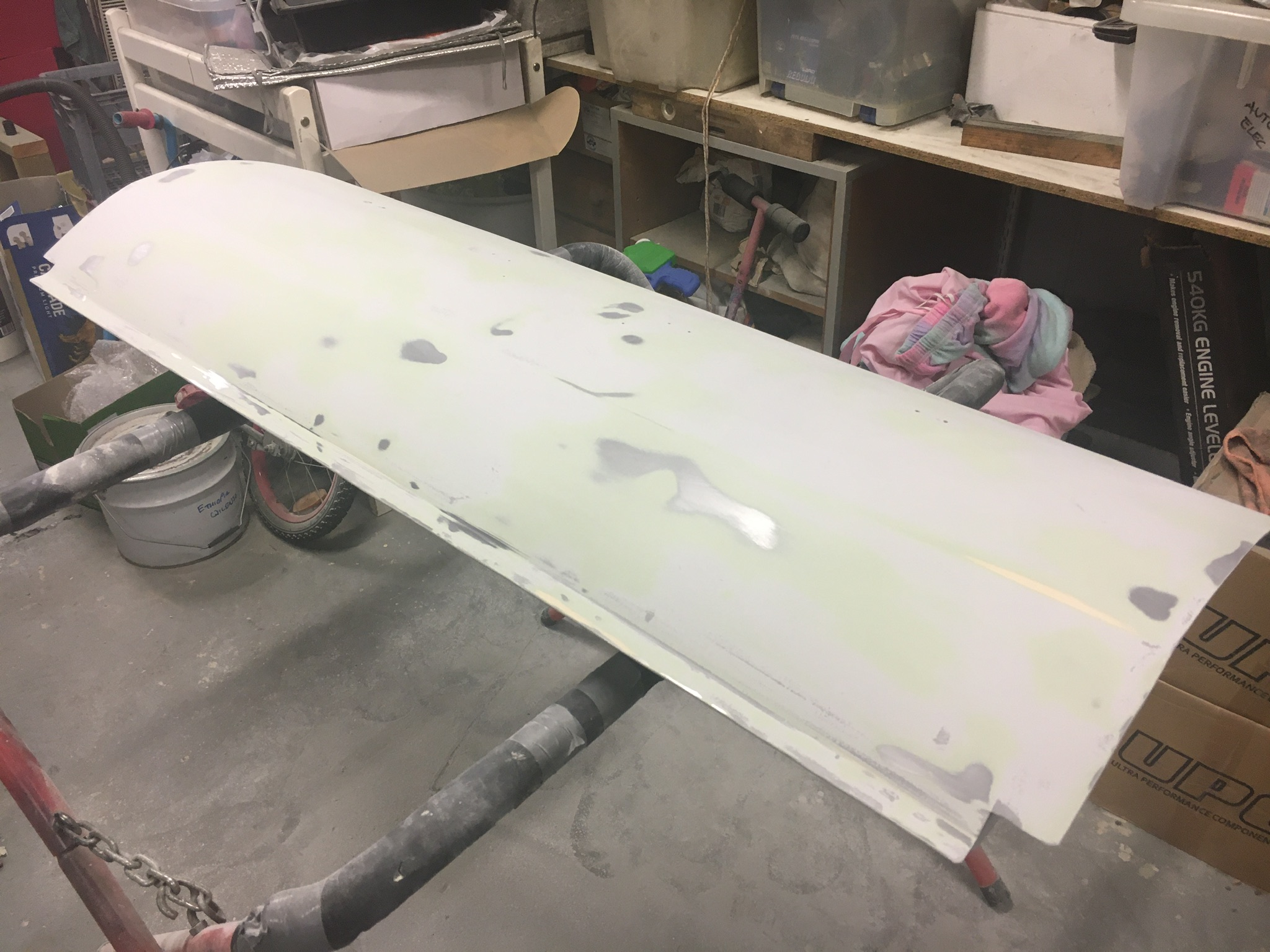

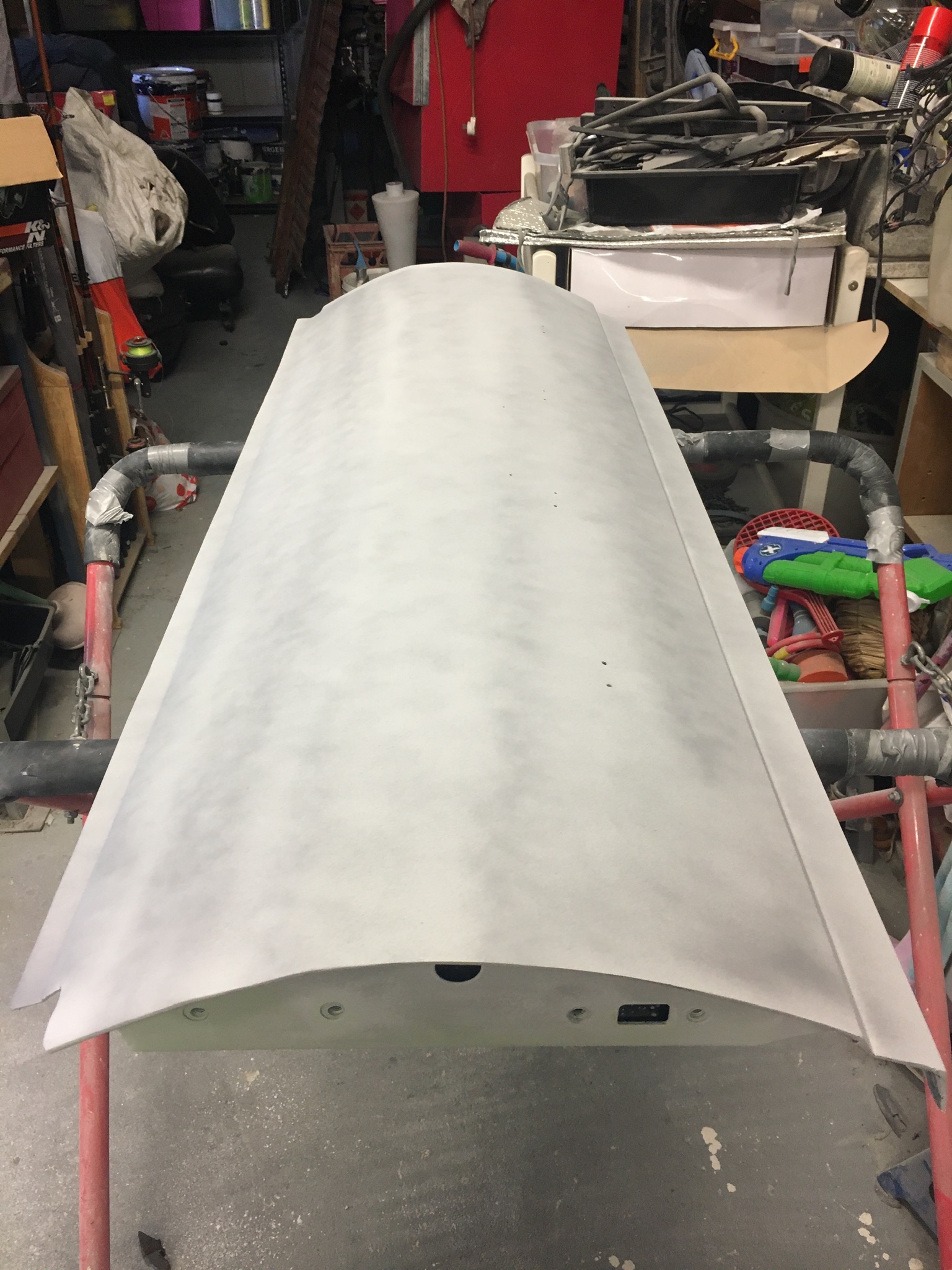

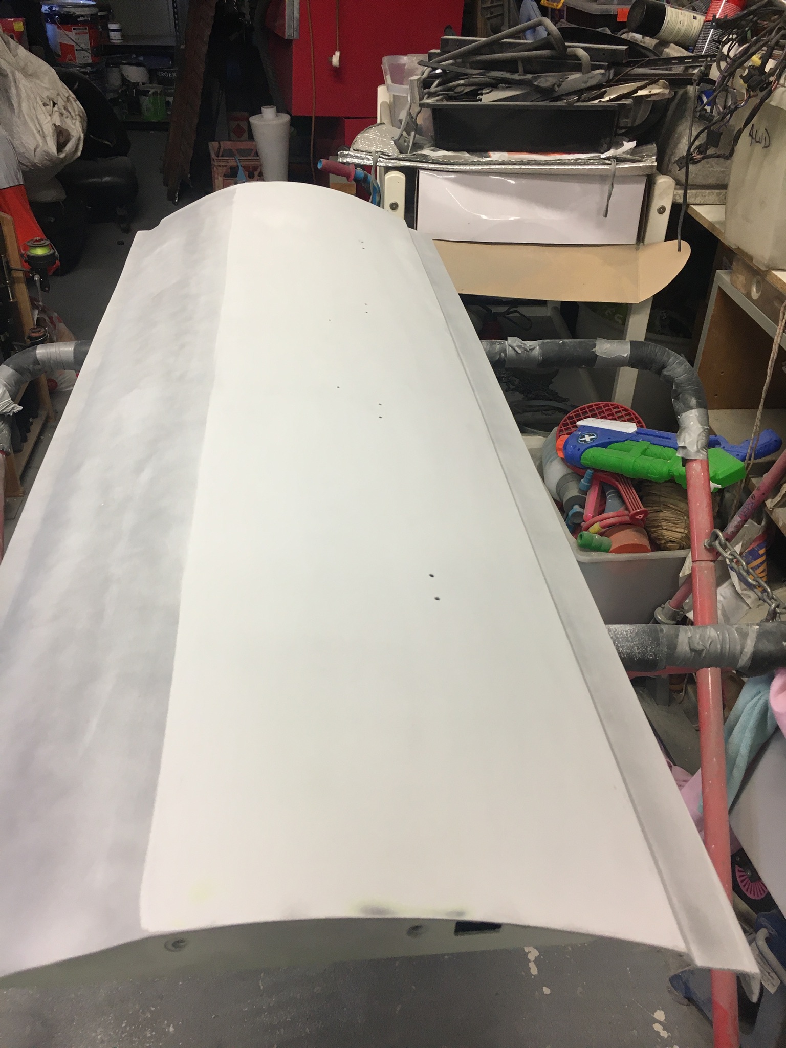

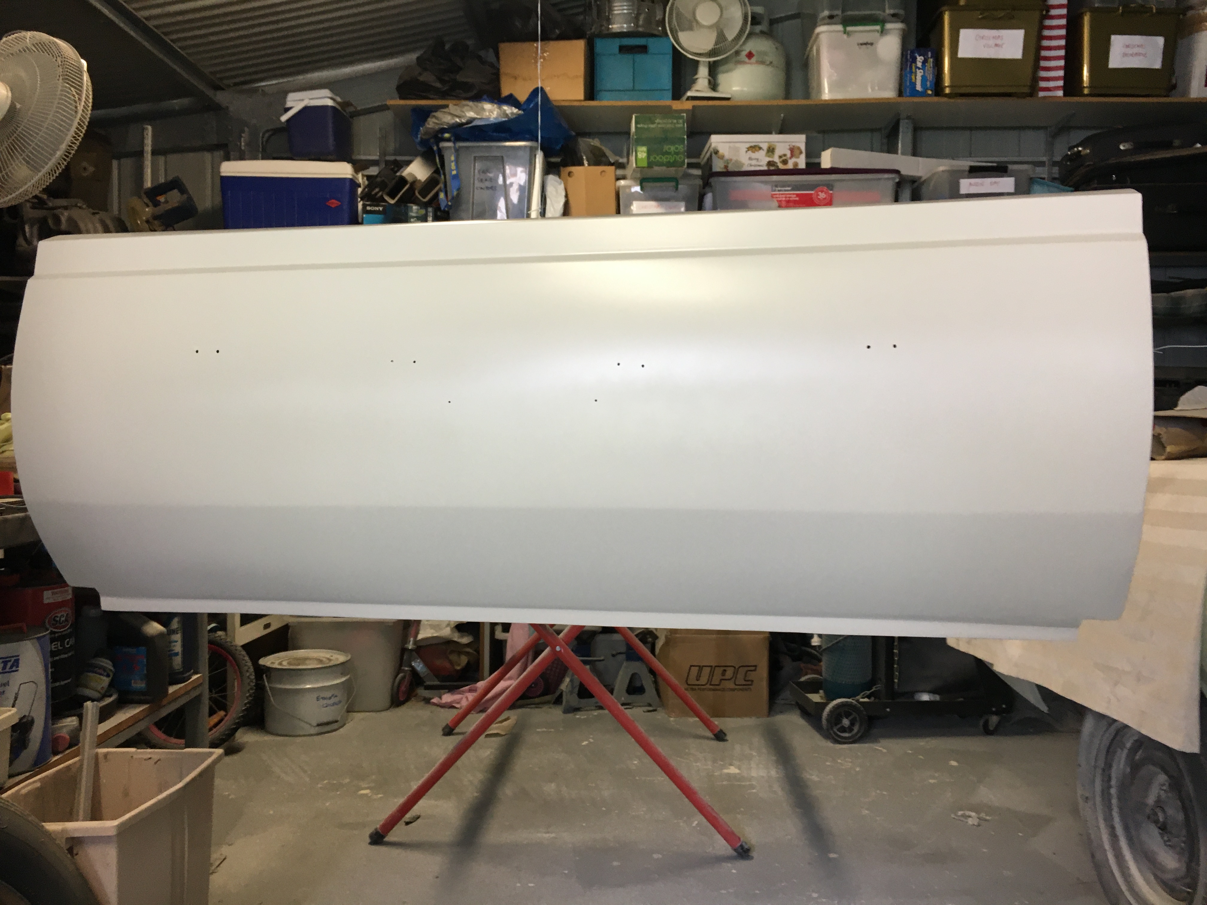

More progress with the tailgate

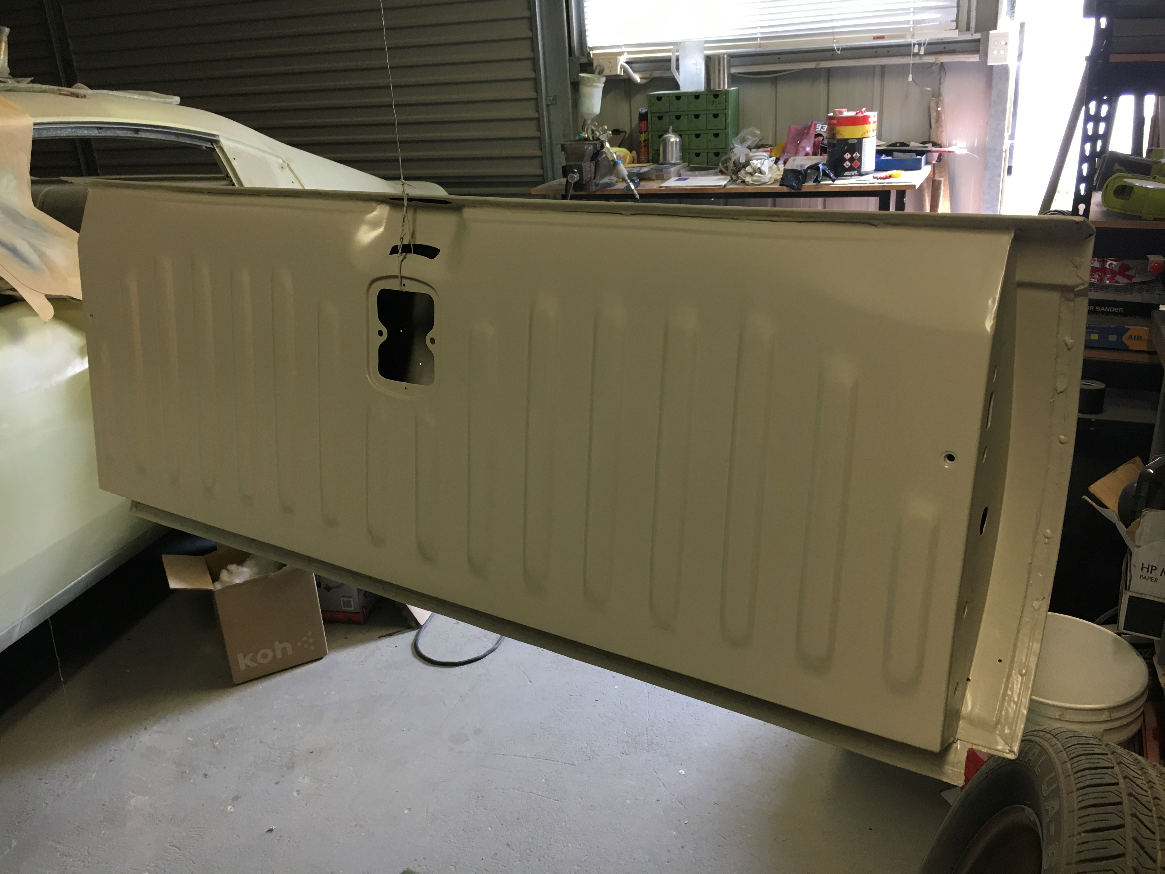

Postby heff0018 » Sat Jan 11, 2020 4:07 pm

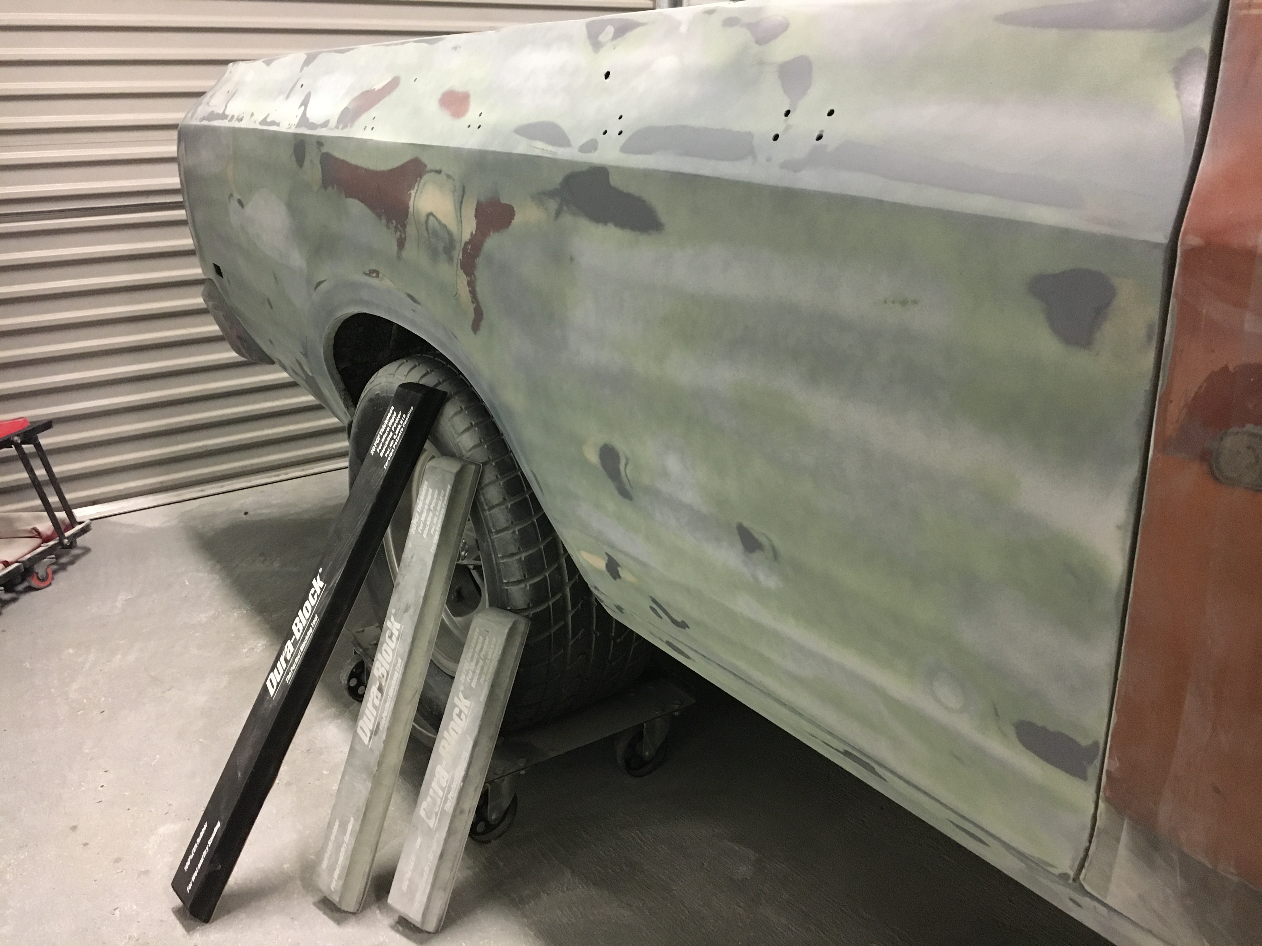

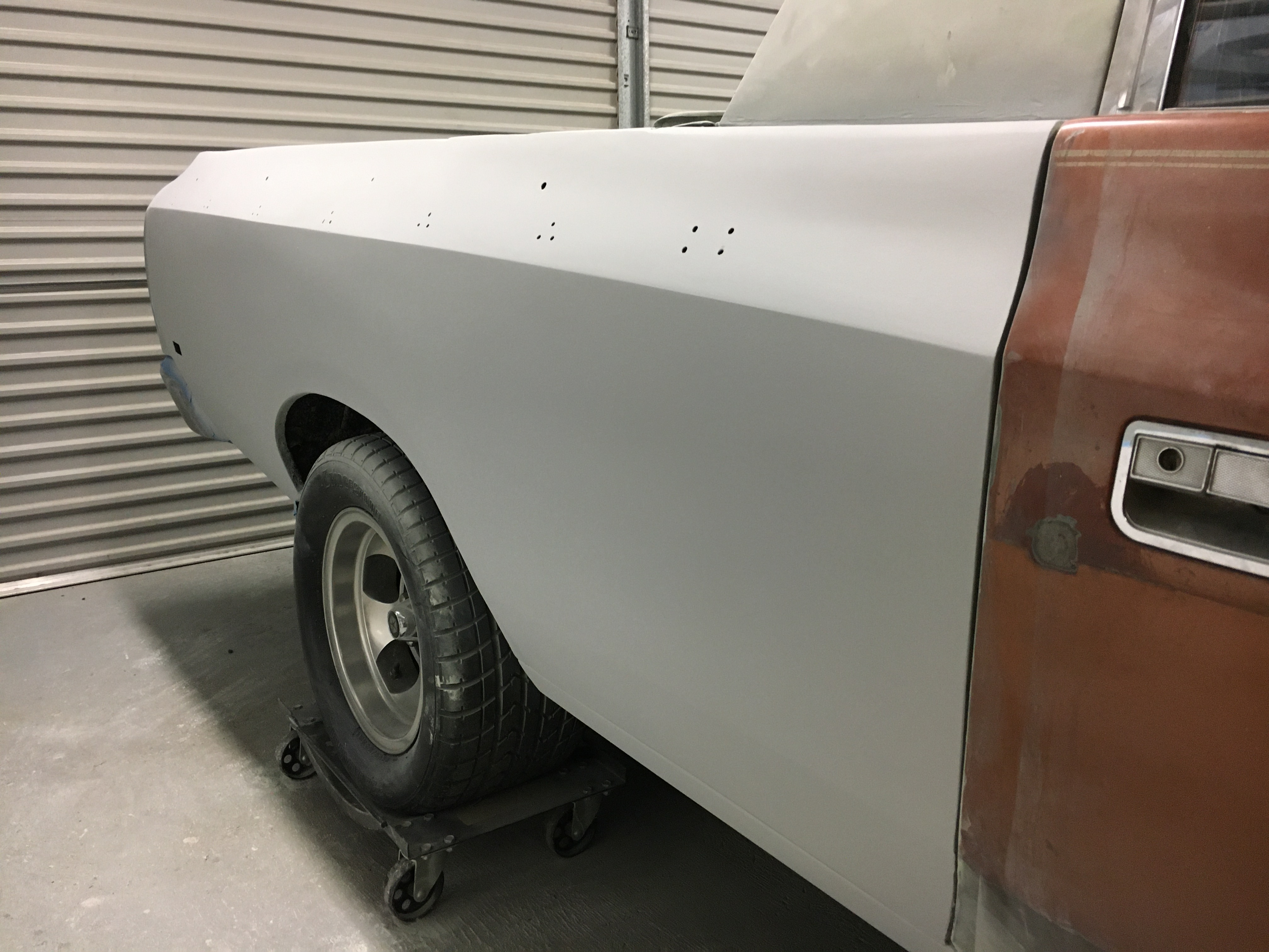

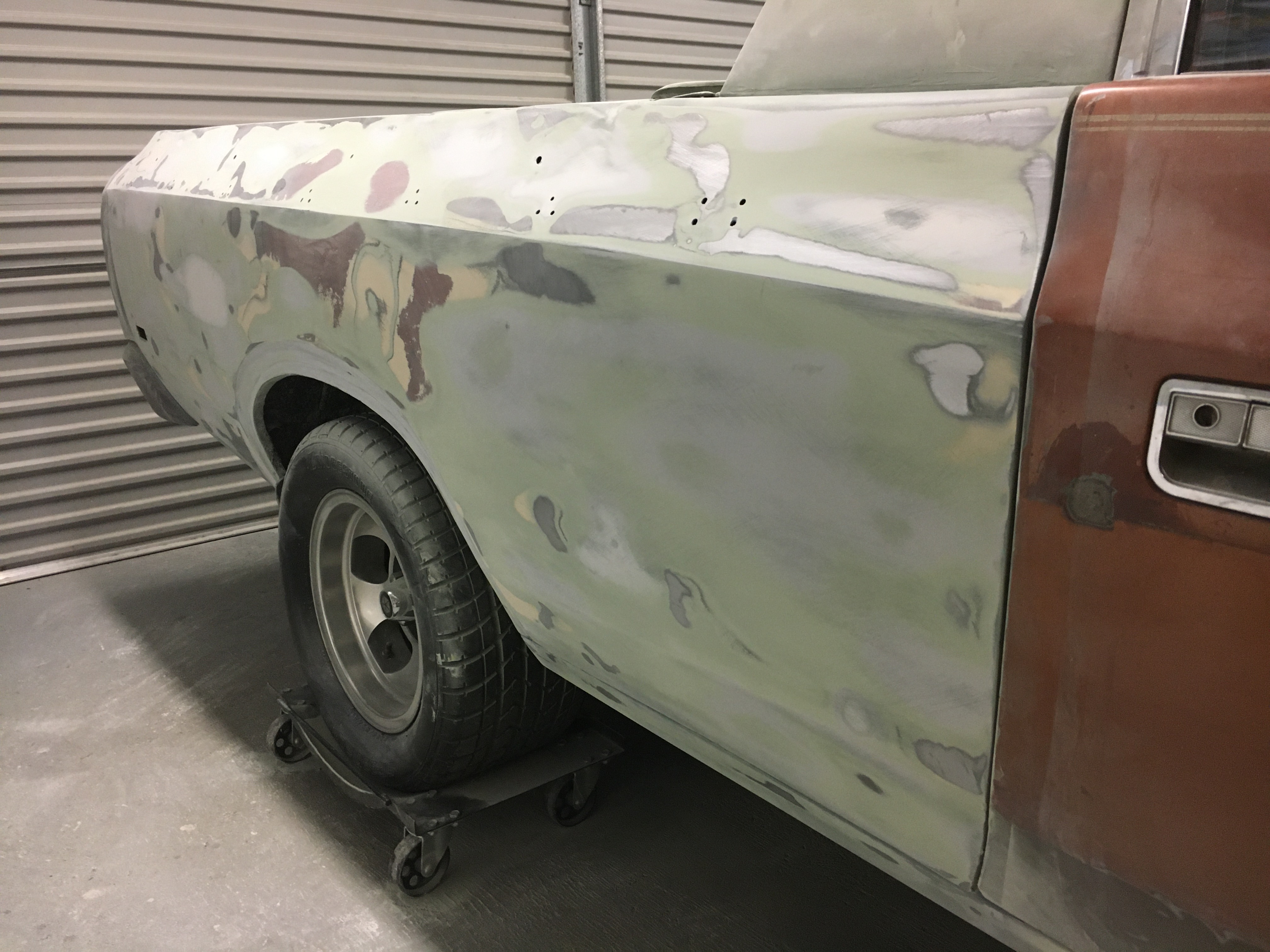

Spent lots of time blocking this rear quarter but I reckon it’s pretty straight now
Skim coat of Filler blocked down with 80 grit and guide coated.
Guide coat blocked back with 120 on the big block.
Polyester hifill primer which will be blocked with 180

Na leave it std. Love those durablock sanders. They seem to get a good line.

Yeah the Durablock's rock, especially the real big one although it kills your arms. I went back over the same area with the large block that I had finished with the smaller block and picked up a number of new low spots.
