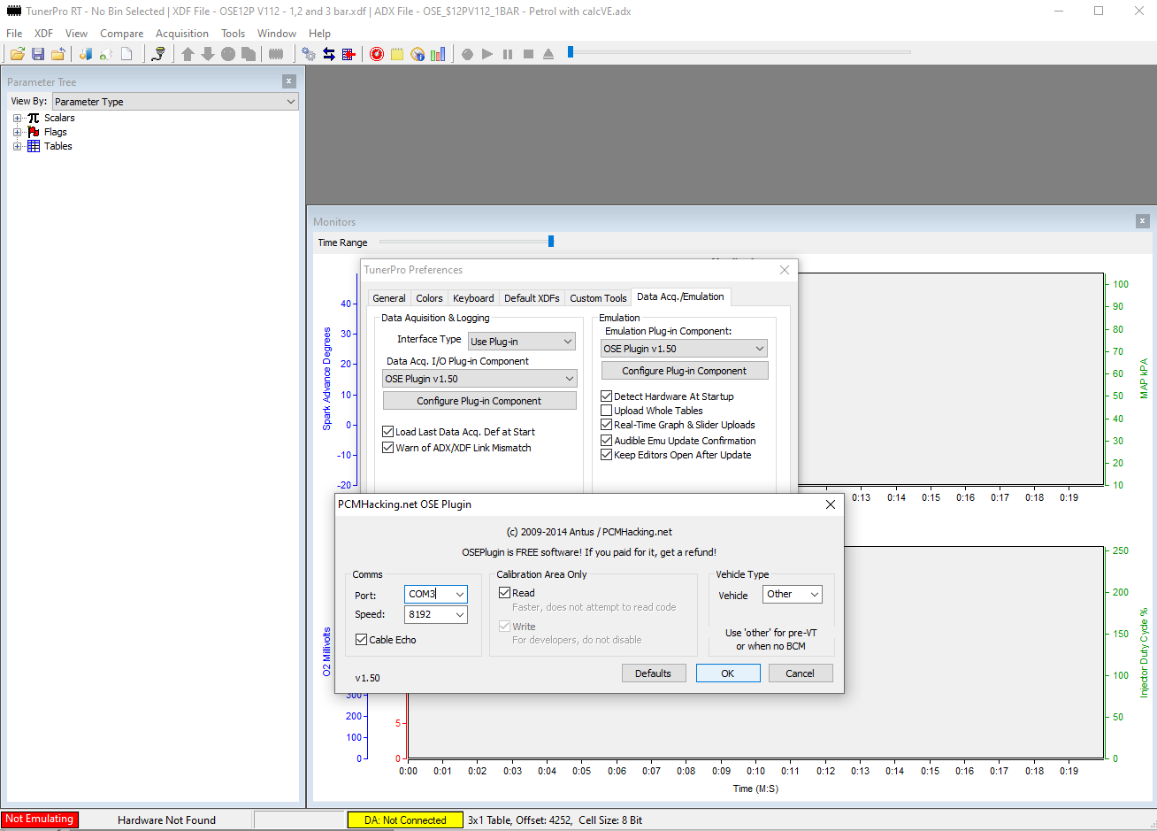

Yup sent it away and had it installed and a tune put on it ive had it connect when i very first got it done but its been so long i cant remember how i done it, i plug in the ecu turn the key on and the ecu then click the plugin icon and it says it analysing for hardware but comes back with no hardware found
Posts: 9034
Re: Connecting ecu (not emulating)
have a look at the oseplugin setup and make sure it has the right com port selected, and the echo checkbox is selected.

COMS3 is all that comes up I’ll attach a photo of what settings it’s currently on before i click save, and also do i use the OSE FLASHTOOL to export off the ecu to edit its quite alot to get the head around ae
Posts: 9034
I mean in oseplugin, in tunerpro.

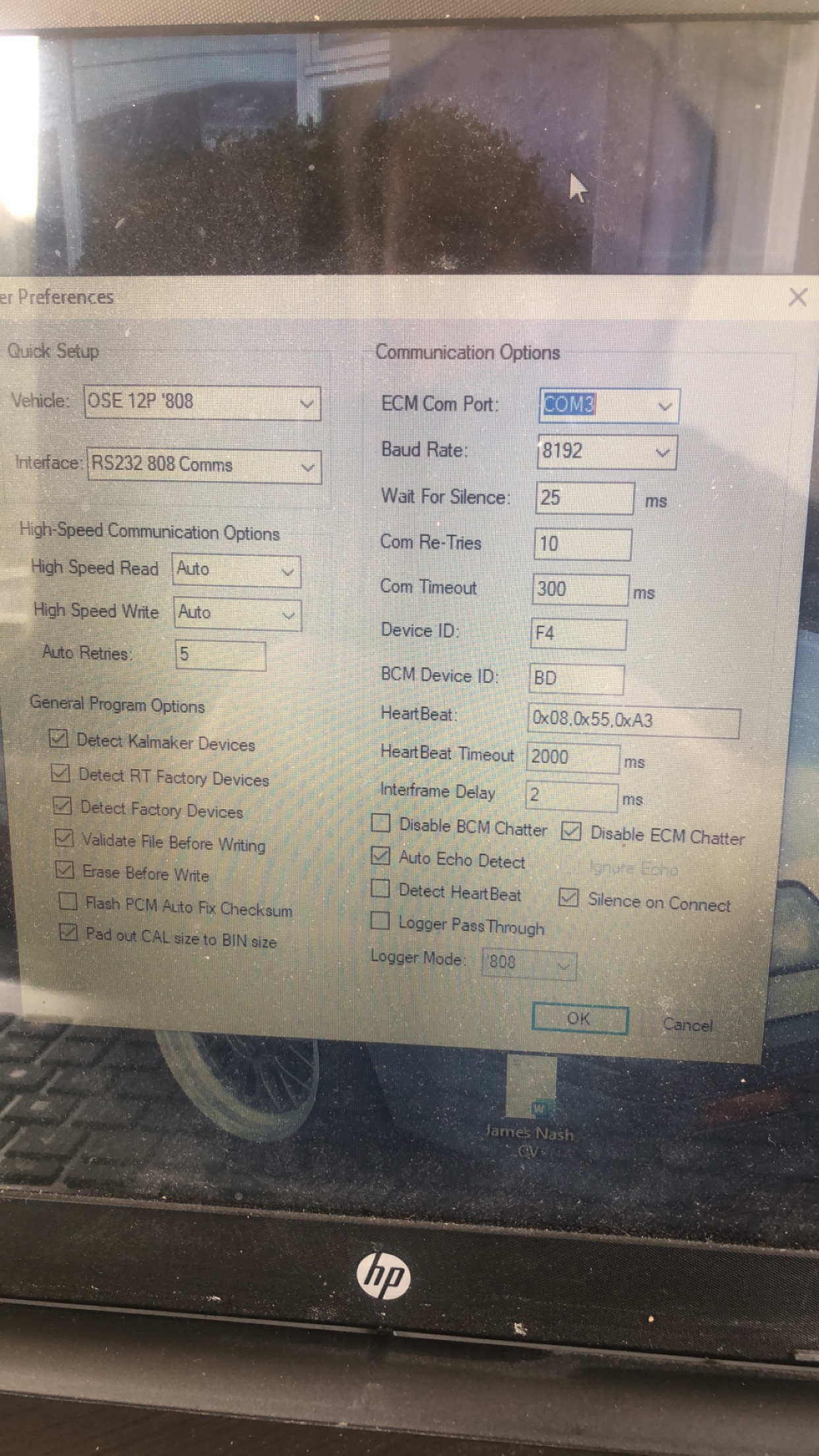

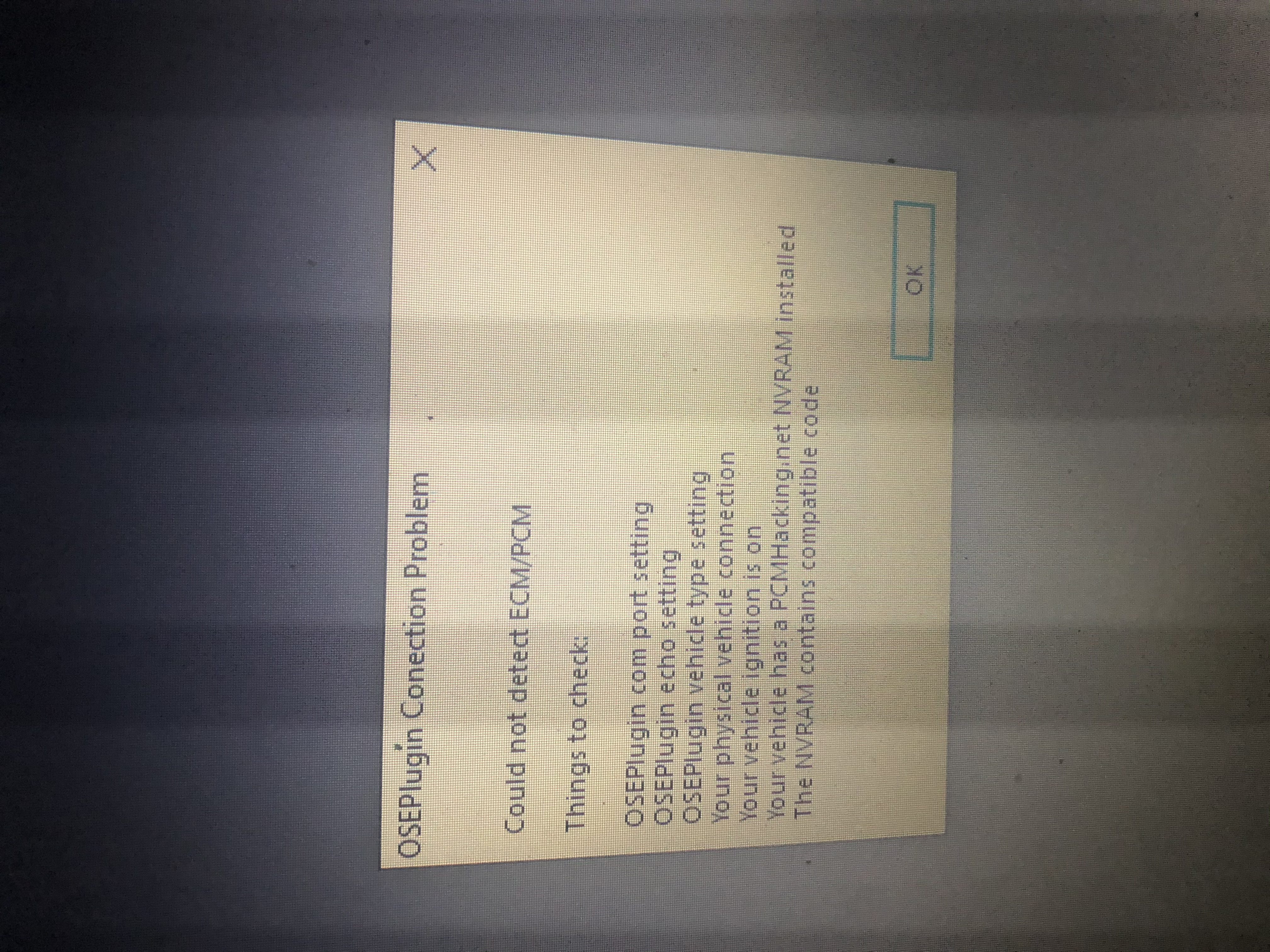

Hi im currently having a similar issue did you manage to sort it out? I have an ecu with all the coms board etc etc installed it has had a tune loaded onto it im just wondering how to extract it and also any ideas on what might possibly be my issue for not connecting as i have all the settings correct as far as im aware going off your picture antus, ill add a pic below of the error code i get butmy main question is how to exstract the file on the ecu to go over it
I dont have the file thats on the ecu on my laptop as i was given the ecu when I started looking into parts but anyway any helps appreciated
Posts: 9034
Ok, perhaps a silly question but can you verify each of those things its asking to check are correct? If you cant verify one of them, then that is the place to look.
If you can verify those things, can you validate the car is running properly, without the computer (to verify the ecu is working and running the enigne)? If that is good too, then check the hardware and make sure the comms board is connected properly inside the ECM.
