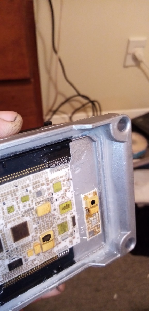

I have 2 here that were repaired by injectronics couple of burnt components have been replaced in one by soldering in new ones. They die from water ingress into the plugs corroding the pins plus heat and vibration damaging the tiny laser welded wires inside and obviously the odd burnt up resistor inside going by the 2 I have open

That looks to be the same PCM we have
Most of the ones I've replace have failed due to broken laser welded wires, crappy design.

As others have said, I would say 99% fail due to the small wires between connectors and PCB breaking

Im lead to believe the wires/pins are stainless steel so can't be soldered.
They are also very small and fragile.
There's a company in Aus that repairs them, IM group / Injectronics. They have very expensive equipment for the job

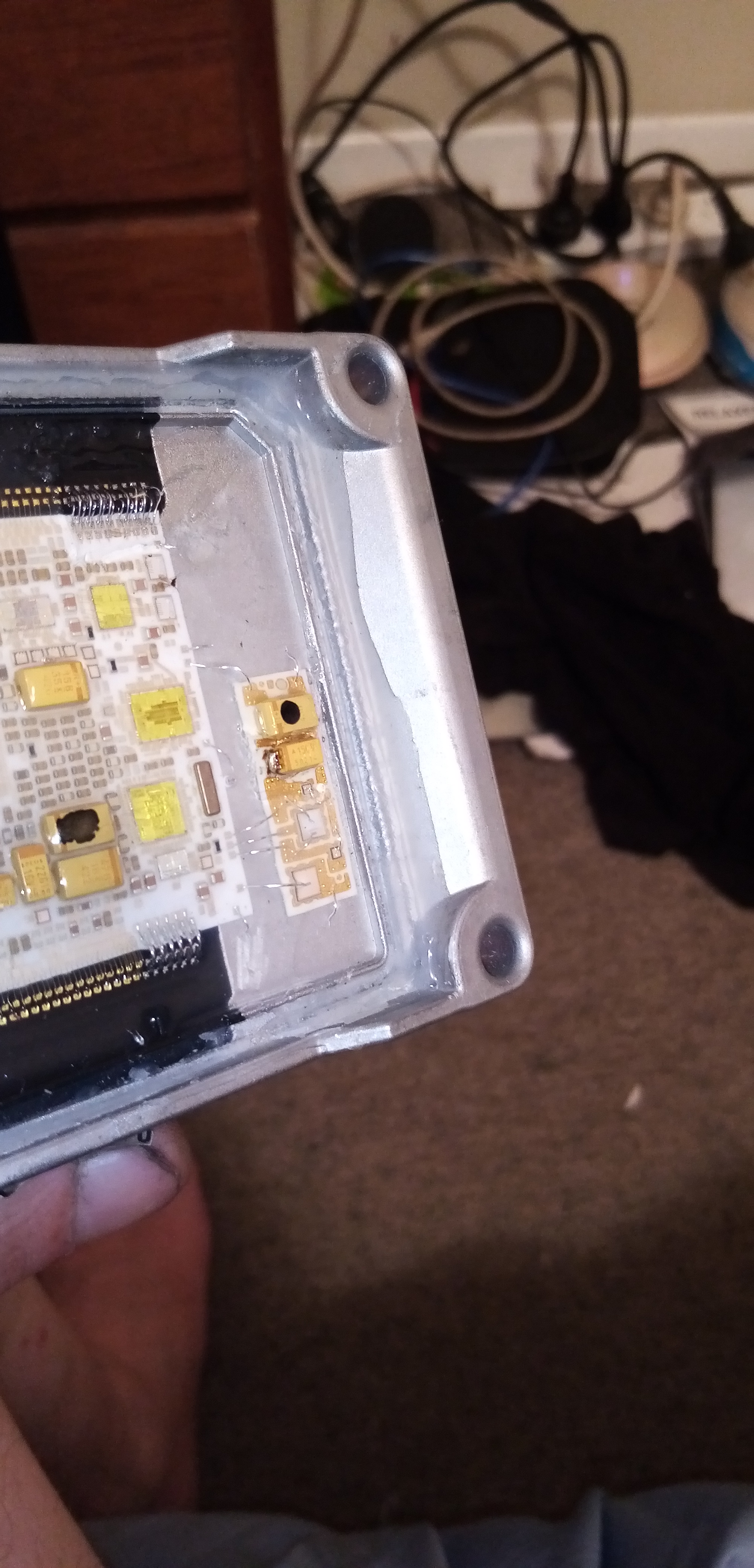

Re: Bosch LY7 (VE style) to Delco?
Here's 1 repaired one the yellow brick has been replaced hand soldered rough as lol. And looks like maybe the small batch of stainless wires top right been retouched
