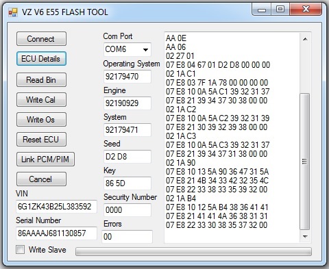

I had exactly the same problem recently programming e55 pcms .vxm wrote:So far, it's worked fine programming other modules in the car, and gets about 75% before failing on these failed ECU. Using passthrough fails at about 20% - but again, they're suspect ECM.
Programming routine should have been
Erase all modules
Flash o/system module
Flash calibration module
Flash slave module
Tech 2 would write os module then write cal module , it would stop programming at end of cal module (75%) with error and not write slave
I monitored can bus while programming and found that the entire cal module was uploaded with every byte being 0xff , the pcm would then give checksum error message to tech 2 and programming ceased. Os module was valid data and slave wasn't written
I wrote this app to solve the problem
- e55 ecu flash tool.jpg (83.99 KiB) Viewed 10391 times

OK, this is really interesting, vn5000!

Tell me more about your application?
Where do you have the OS / firmware from for the e55?
How could I use it / would it work for my application?
This is -very- interesting to me.

Re: Bosch LY7 (VE style) to Delco?
Does your program receive the immo code as per picture? For the likes of ecus that for eg dont hold a vin (security linking without actually being Tis'd) and or for unknown immo's etc? Pain when I receive a ecu with a incorrectly programmed vin or no vin and I cant delink it.vn5000 wrote:I had exactly the same problem recently programming e55 pcms .vxm wrote:So far, it's worked fine programming other modules in the car, and gets about 75% before failing on these failed ECU. Using passthrough fails at about 20% - but again, they're suspect ECM.
Erase all modules
Flash slave module
If so I'd be interested in purchasing?
I had programmed them before with tis and had no problem as well , maybe most of there files are complete but some are missing cal segmentvxm wrote:I used ACDelcoDTS' online subscription (40 USD for 2 years, covering one VIN) and managed to program a fresh ACDelco-remanufactured e55.
I use this tool to read and save the bin file , there is also a tool that Tazzie wrote that enables you to read bin using elmvxm wrote:Where do you have the OS / firmware from for the e55?
No , but to reset pcm you enter security code if known and click "Reset ECU" , if code is not known it will try all 10000 possibilities until found , catch is app needs to wait 30 sec before each retry. The 2007 ve e77 has very similar code structure to e55 and you can pull the security code using 0x1A7A command , however e55 wont spit it out with that command , neither does any e77 after 2007.hsv08 wrote:Does your program receive the immo code as per picture?
App is just a personal tool at the moment that uses my custom can bus cable , unfortunately not for sale at presently
