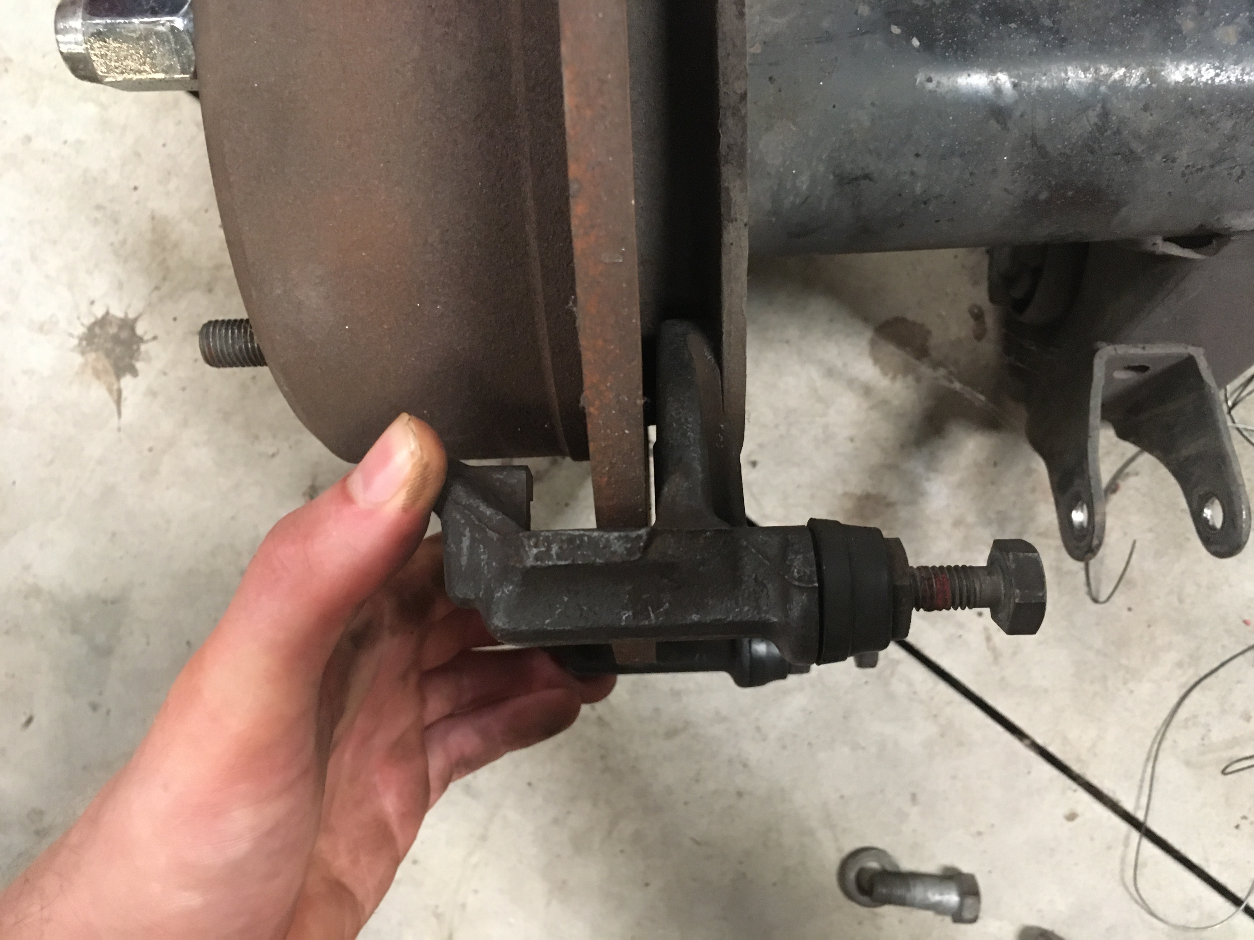

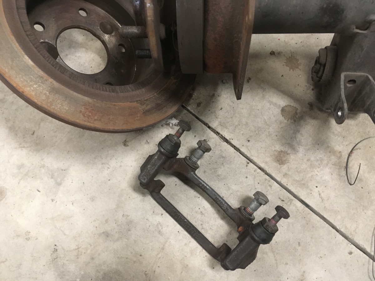

Finally got around to getting some Corvette C4 rear caliper brackets to suit my group A calipers.
FYI the stock bolts are class 10.9, M10 x 18 x 1.25. The Corvette/Group A ones are class 10.9, M12 X 20 X 1.5 (that's perfectly flush including m12 spring washer) So an off the shelf standard either from Wurth or ebay Uk.
The backing plate will need to be re-drilled to suit M12.
so i assume this needs a different disc which has less back space ?
Yes, basically the same backing just double the thickness and vented.
PN: DBA 020 is it.
Also the Group A caliper has around 40mm piston vs the 38mm in the standard type.
I'm going for VT front , Group A rear and VT master and booster conversion. My only concern is if the booster will work any good with the lack of vac due to the 308º, 258 @ 50, 106 LSA cam.

vlad01 wrote:Yes, basically the same backing just double the thickness and vented.
PN: DBA 020 is it.
Suppose I will just have to try and see :study:
You should be ok with vacuum, I run a larger cam in my Torana than this & still has vacuum. Another option is to use a vacuum tank in the system, fitted up under the guard out of sight.
The VT booster is quite large so it hopefully should store enough vac during peak vac. I'm sure even if it's not great it will be much better overall than the current "v8" stock VP brakes with 1" master which is already worse than the bad standard 15/16" single diaphragm setup. Almost can't stop in the car the way it is atm. I remember missing the owner's driveway on the test drive when I bought it and I was only doing like 30km/h :? :lol:
