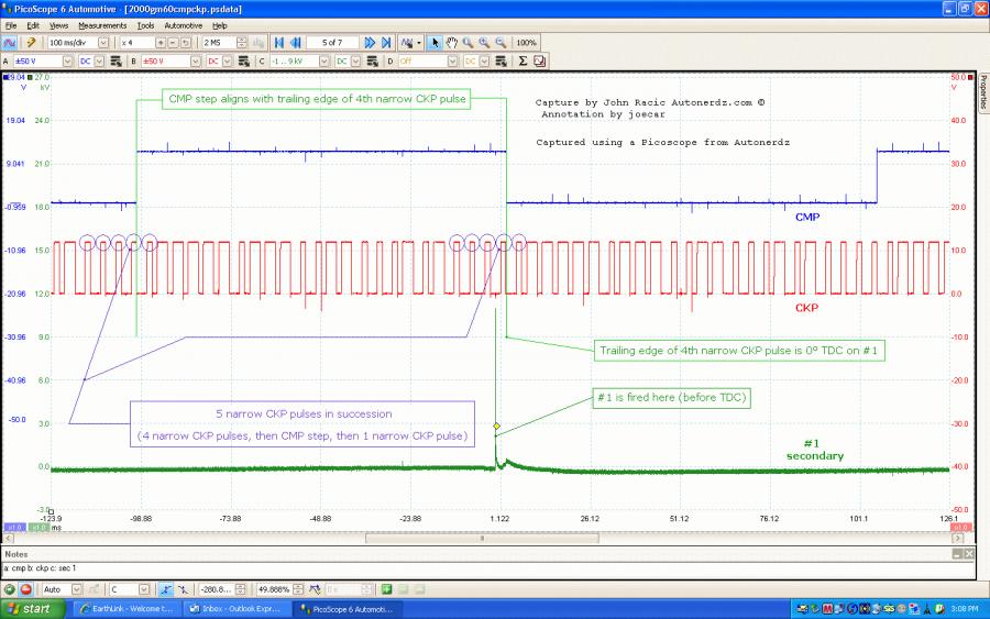

Now that makes perfect sense to me after looking at the timing diagram I recently found below. For the first 360 degrees of crankshaft rotation, the camshaft sensor sends a high signal to the PCM. The second 360 degrees of crankshaft rotation the camshaft sensor transitions to a low signal sent to the PCM. On that falling edge of the camshaft sensor from high to low, the PCM knows the #1 cylinder is at top-dead-center on the compression stroke and is ready to be fired. Except, the PCM actually fires #1 just before the high to low transition from the camshaft sensor, but I'm guessing that's all calculated internally as ignition advance.
I can see now why these two signals most definitely need to be separate.
