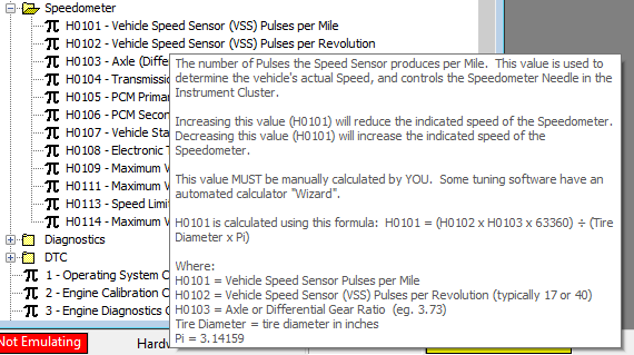

Re: gear ratio and tire size change
This is not unique to HP Tuners. These things can be changed in the OS using a program called Tuner Pro RT using several simple calculations within the speedometer tab. Please see attached pictures.
Rick
Rick
@B52Bombardier1 You are a hero! That is exactly what I have been hoping to find!
From the looks of your screenshot and some googling, it seems H0106 is the abs output I am looking for?
