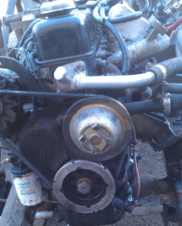

My mate got a new trigger wheel made up and installed it today, it works heaps better than the old notches cut into the skinny pulley edge. no more backfiring now. VL400's Logger sur eis gettin a workout on this project. its a bit sketchy to be flying round the paddock in this with a laptop...

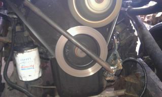

weve just solved the major problem that has been plaguing this setup... backfiring at high revs. turns out the engine was getting a harmonic vibration at high revs that was causing the sensor bracket to vibrate in and out. the module saw this movement as another voltage spike and sent it out of phase with a large backfire, then the CEL would come on with EST code 42. after much hair pulling we finally found this out and my mate implemented the proposed solution today :D result, high revs with no backfire and no check engine light.
:driving:
just goes to show, solid sensor mounting really is key to these DFI setups.
new sensor brace
new sensor brace

lol i think the fix is overkill but hey whatever works :P

its a pretty long mount and we were stuffed if we were gonna risk it moving again so stuff it :D
