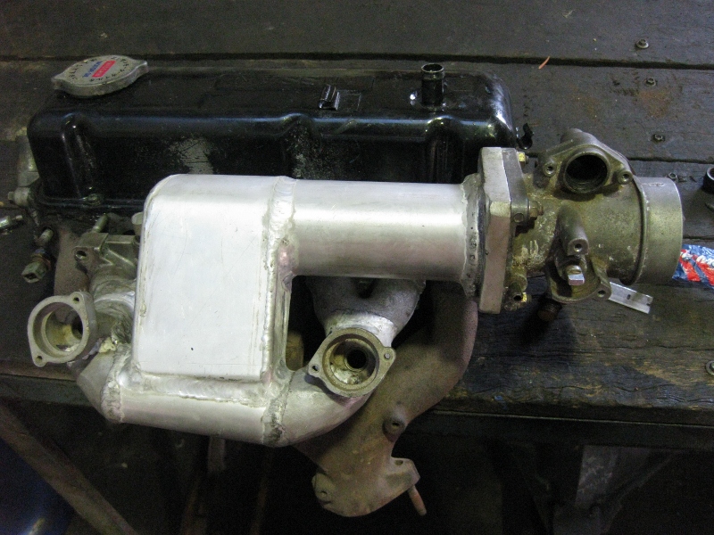

and the completed Injection manifold. im not convinced that the injector placement is going to be very ideal. its much of an experiment and this was the easiest manifold to make, so well give it a go, the way I see it, a datto 1200 engine is so small, 2x blue tops shoudl be more than enough fuel, consideirng 2x 304 culinders = 1250cc's anyway

been slow progress, working on other projects, this one is on the go again, he had a slight problem last week, sat there and ground up the balancer for trigger notches for the 4cyl DFI, looked over at his spare head/motor (which the injection imlet manifold was made for) and close inspection finds that the engine is different! so looks like we wont be injecting a 1200..... a bit of research finds the the new engine is a datto 1400! we just accidentally scored another 200CC's. the 1400 is nearly together now, wiring all done, DFI module mounted, dizzy deleted :D the goal is bolt the motor in and start it by thursday.
