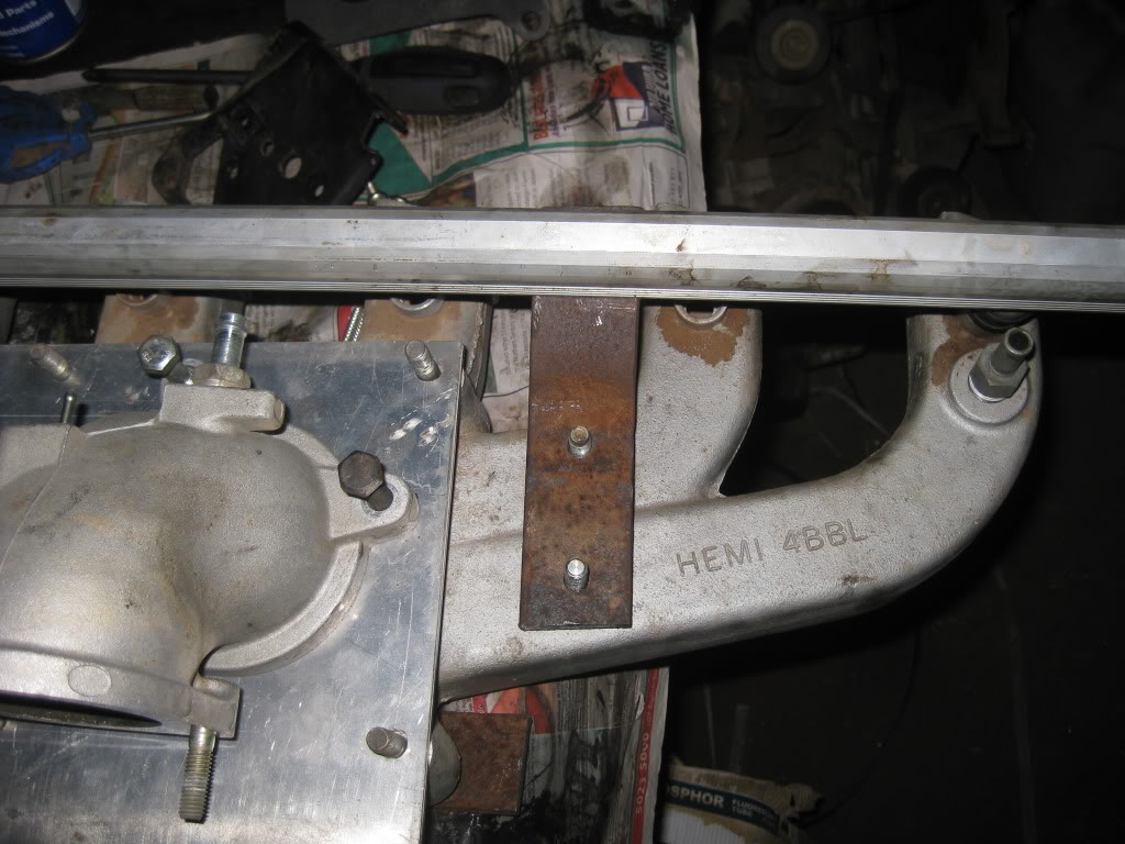

so i've been fiddling with this. i ended up tapping a couple of bosses for studs to hold one end down. made a little bracket and bolted it to the underside of the rail. it'll get a tidy and paint, but this will give you the idea.
i've started adapting the vn elbow as well. i reckon pointing it out toward the guard will make the throttle cable and air cleaner easier to fit. we'll see.

You can see the two 1/8" flat stock aluminum brackets that hold my fuel rail on here:
And here:
And here:

and they haven't popped off with fuel or boost pressure ? what else holds your injectors on ?
- Posts: 10111
Re: fuel rail clamping. how much is enough ?
The fuel pressure wont pop it off, because the injector is holding the pressure in the rail. the only back pressure is when they are injecting, and the mass of the fuel is so low it wouldnt push back much. I imagine it 'only' really has to stand up to the pressure of boost.
3 years in and never popped off.
The rail is on there quite solid actually.
ok. cool. thanks.
