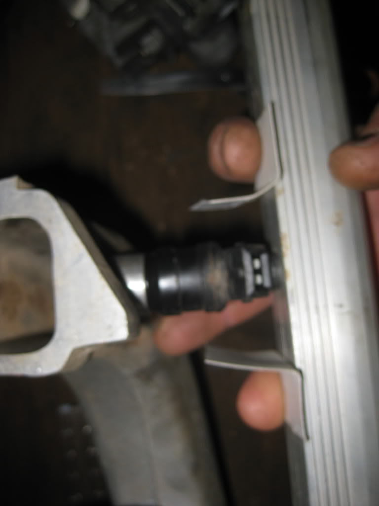

hi guys. i am in the process of converting a 245 hemi to efi. i'm using a cain 4 barrel manifold which has had bungs fitted for injectors. i bought some fuel rail extrusion and made a rail. my question is this, if i make a clamp which goes from the 2 carb mounting flange studs onto the rail, will this be enough clamping ? it just seems a long rail to only clamp near the middle. i'll get some pics up tomorrow.

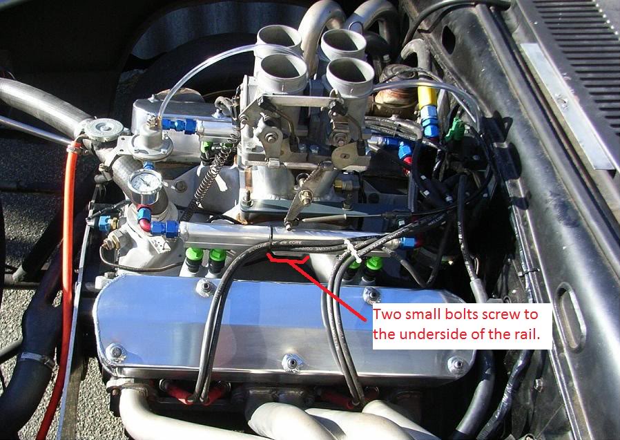

Have clamped the middle on a V8 and had no problems but the extra length of the 245 might be an issue - the rails we used had a ~10mm thick base to thread in to and for the injectors to be machined in to.

i reckon my rail stuff is very similar. i'll have a better look and see what i can do. some pics too.

the other question i have is, if i clamp it down solidly in the middle can i hold it down with strong springs at the end ? again, i'd better do a mock up and show you what i mean.
in this photo, i've made a (cardboard) bracket to hold the rail in place in the middle. one end bolts to the carb flange, and the other end to the rail itself.
another view. there's a heap of meat in the rail to drill and tap.
this is one end. the plan is to make 2 right angled pieces and wrap a long spring around the runner to hold down the ends. i'll check for extractor clearance before i get too excited.

after some discussion, i've decided to move the bracket attachment out to the next gap between injectors. more pics when it's done.
