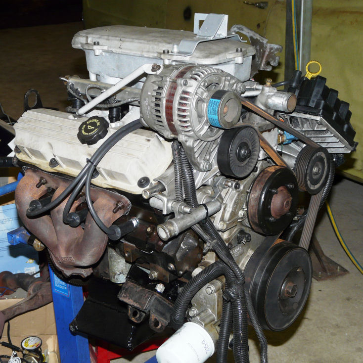

Well i been getting stuck into some last minute stuff before the weekends mission .... put convoluted conduit on the wiring loom, ran it all through the motor to all the sensors .... put the leads on and the alternator and stuff that wasn't quite finished.
really no more i can do till its in the car.... except i have to make a bracket for the map sensor to mount onto the side of the plenum.
few things to note that might stand out to those who regularly look at ecotecs .... throttle body has been fliped 180 degrees, mainly to allow me to connect a kick down cable to it .... thats also what the bracket is on the top of the plenum....
drive belt is a custom length to suit no p/s pump or a/c pump .... also a few less idler pulleys in there .....
custom sump to suit rear mount pan ... also its steel and not alloy like a normal ecotec sump.
engine mounts are custom to suit my application and use holden v8 rubber mounts.
oh and on an asthetics note, i'm quite happy at the topgun leads are dark grey rather than the bright blue im used to, blends into the motors colours better :)
so i'd say the next update here will be once the weekends 'festivities' are underway! :punk:

Re: Time for a change - Ecotec Torana
i see one thing not on there the metal plug lead protectors that slide on the ends :mrgreen: oh and a T3/T4 :mrgreen:

I see a nice sump and mount set looking good. :thumbup:
