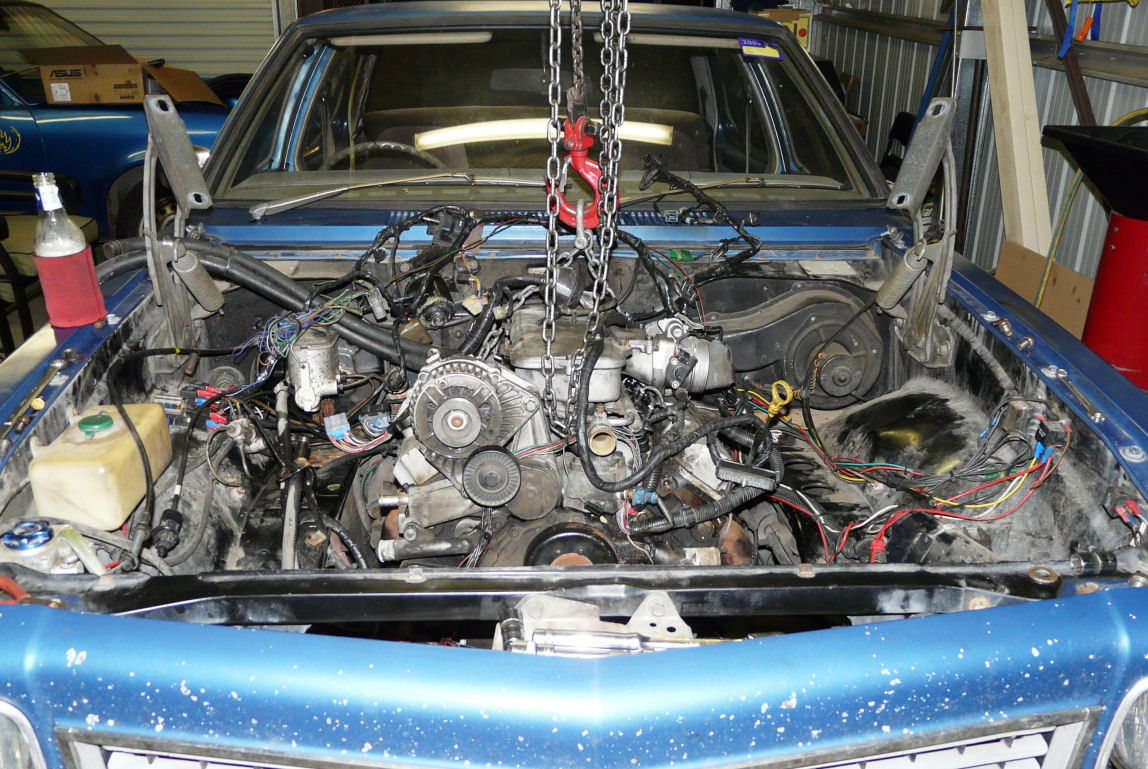

Over some holidays around christmas/new year i pulled the motor out of the Torana for a trial fit of the v6 and to allow me to get the engine mounts and sump perfect. It went alot smoother than i first envisaged and i was actually able to fire the engine up in the car with the VN wiring running on a VN memcal.

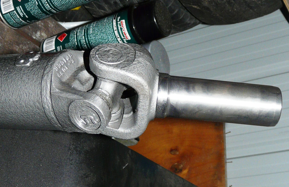

Just today i picked up my custom length tailshaft which was the last piece in the puzzle for the conversion .....

nice looking driveshaft there im waiting in anticipation for the outcome

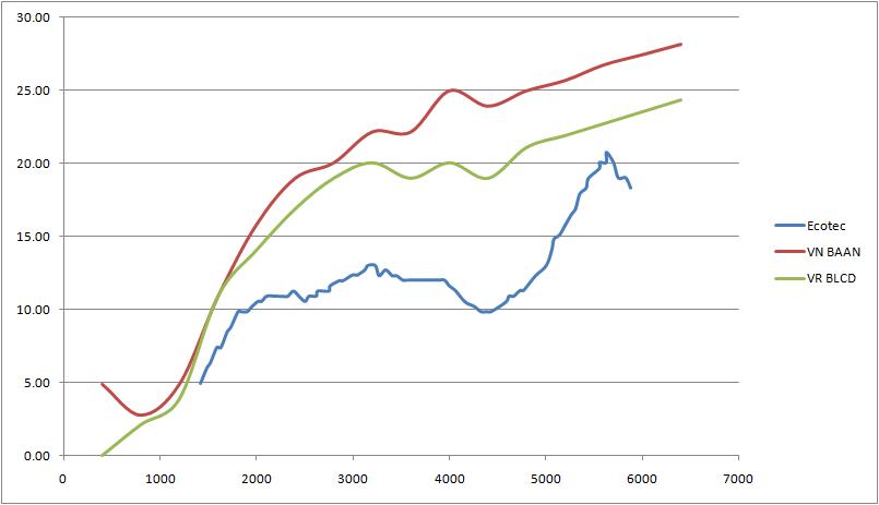

im addicted to nice graphs, to see the diff here is an ecotec WOT (effectively 100 kpa) spark map taken from aldl log vs VN and VR spark maps taken direct from tunerpro 100kpa column

Re: Time for a change - Ecotec Torana
there is a fair bit of difference there hey!! i'd say if its gonna ping it'll be in the mid range
also makes me wonder how much of that drop in timing is actually needed and how much of it is holden taming the motor down ....
