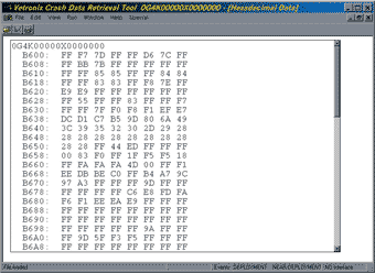

This is the data retrieval out of a GM SDM module. Courtesy of http://www.airbagcrash.com
