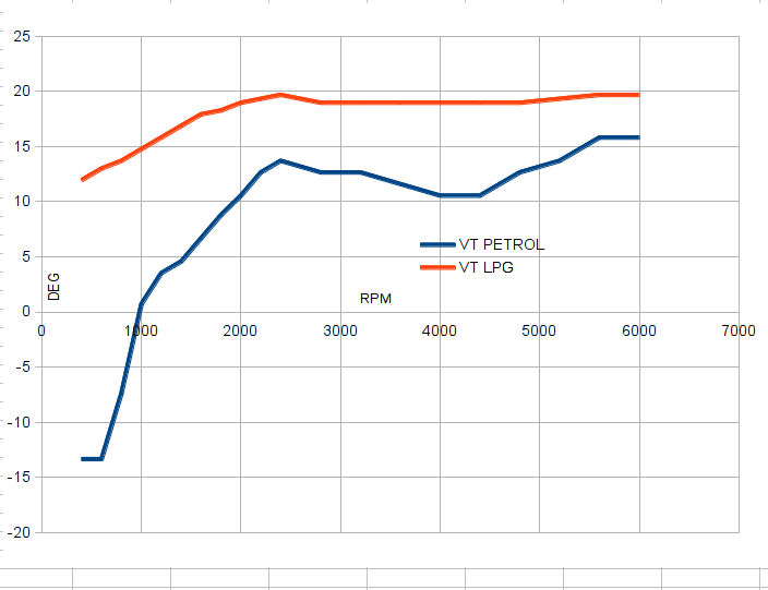

Re: LPG VP V8 - anyone have a spark table?
VT petrol and LPG WOT curves. The LPG curve looks as crude as mine. Why has it got more advance than the petrol one? And what's all this negative degrees in the table? ATDC?
They are way different things. I thought this was going to be easy peasy. How can I correlate one set of units with the other???Holden202T wrote:yeah mgc is a MAF axis.
thats the hard thing.... you cant mathematically line them up... MGC is how many crams of air is entering the cylinder, wheras map is the air pressure in the intake manifold... different cam / exhaust / engines all correlate differently. the onyl way we have been able to is if you run a map sensor AND a airflow meter on a car and log them at the same time while driving to figure it out.
you can get WOT pretty easily just hold it flat and log MGC and that will be equal to 100 kpa... its hte part throttle thats hard to get right.
yes the negative degrees is when it is firing after TDC...
i did the map sensor on ecotec for a while to get a nice map based spark table for the ecotec, you can use the injector monitor line input to do it if you wanted to.
