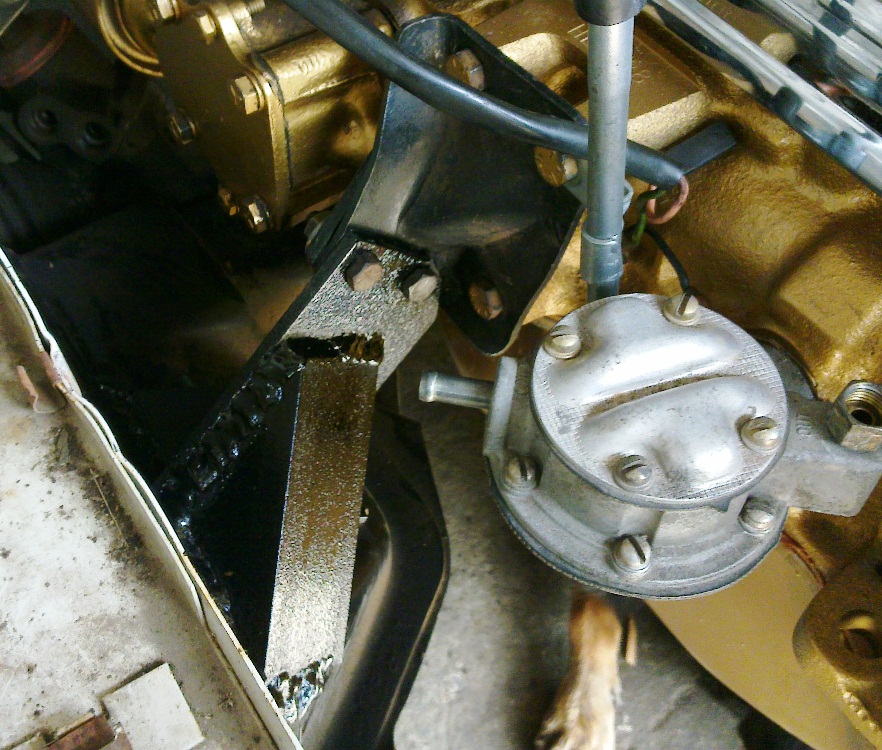

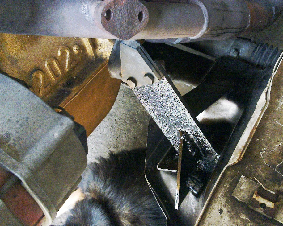

finally got a chance to work on this thing when its not 40 degrees!
so the mounts are done and gussetted probably more than needed :)
so we are now starting to work on all the extras, exhaust, fuel system etc.

I was expecting you to use a V8 cross member so you could use standard style mounts, I guess they'd bend if solid mounted anyway
Re: VS Commodore 202 Drag Car :)
yeah if we had a v8 crossmember we probably would have, but also we wanted to get the motor back as far as we could so they may not have lined up anyways, plus the steel came from the brothers work free of charge and solid mount means no breaking rubber mounts :)

I see a furry animal and a paw under the x-member :lol:
hahaha yes that is Harry my trusty sidekick i took him to my brothers place to hang out with my brothers younger brother of Harry (from the same parents different litter) and after he'd had enough he parked under the car in the shade!
