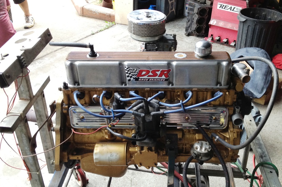

your probably going WTF .... but yes we are putting a 202 in a VS Commodore.
kinda related to my car but also not :)
this is the engine that used to be in the gemini, naturally aspirated on EFI methanol, so i have decided to put this in my brothers VS Commodore drag car that is in need of a motor :punk:
so first step was to get the carby manifold and got it running with a methanol 500 holley with the help of my mate at his workshop :), will soon be taking it to my brothers and installing in the VS, will be backed by a T700 with 3000rpm stall, 4.11 diff, slicks and approx 1200kg car so should do mid to high 12's i reckon!
http://www.youtube.com/watch?v=Y6rgCrrNHTY

Well thats certainly not something common! She runs pretty well on your test stand :thumbup:

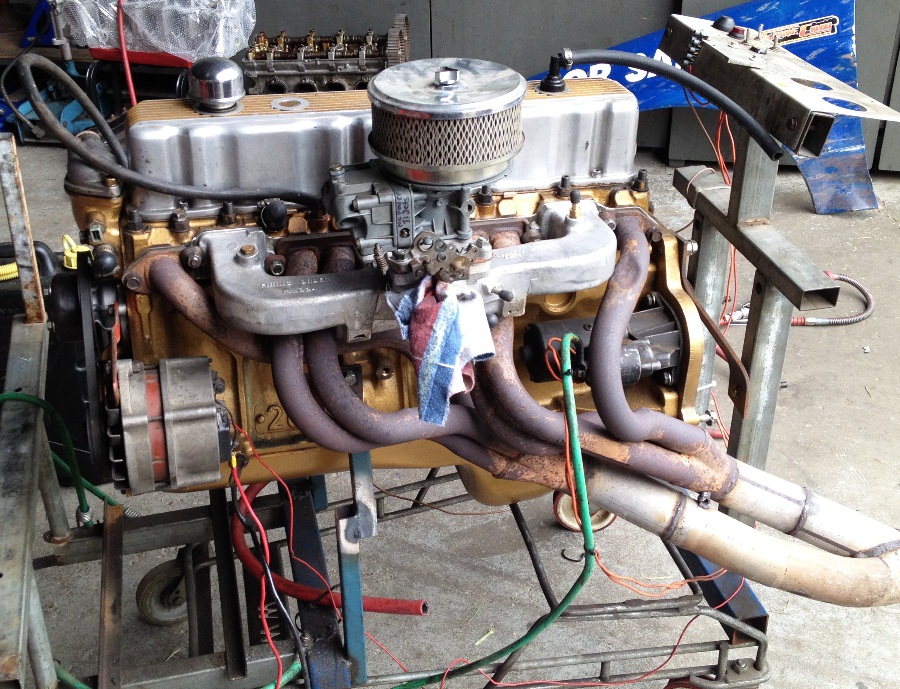

finally got some more progress :)
its only sitting there on the sump at the moment, but its pretty well in the location its going to go, and the gearbox is screwed into the V8 mount location so we are going to source a v8 tailshaft (easy) and then just make some solid mounts for the front of the motor.
i can't believe how nice it fits, about 2 inches at the back of the tappet cover and the water pump is about 3/4 in off the thermo fan. we cut approx 1 inch off the fan shroud and shes magic!

LMAO, that looks so weird retro fitting a late (ish) modeled car!
Wonder how long the gold paint will last?
Nice work though plenty of room to fit some good air pumps! :punk: :punk: :punk:
