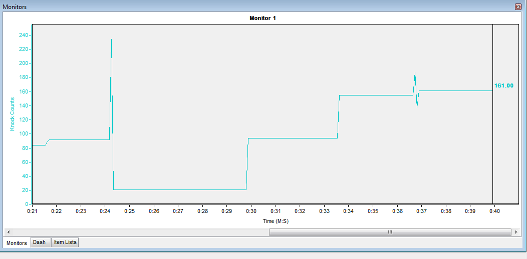

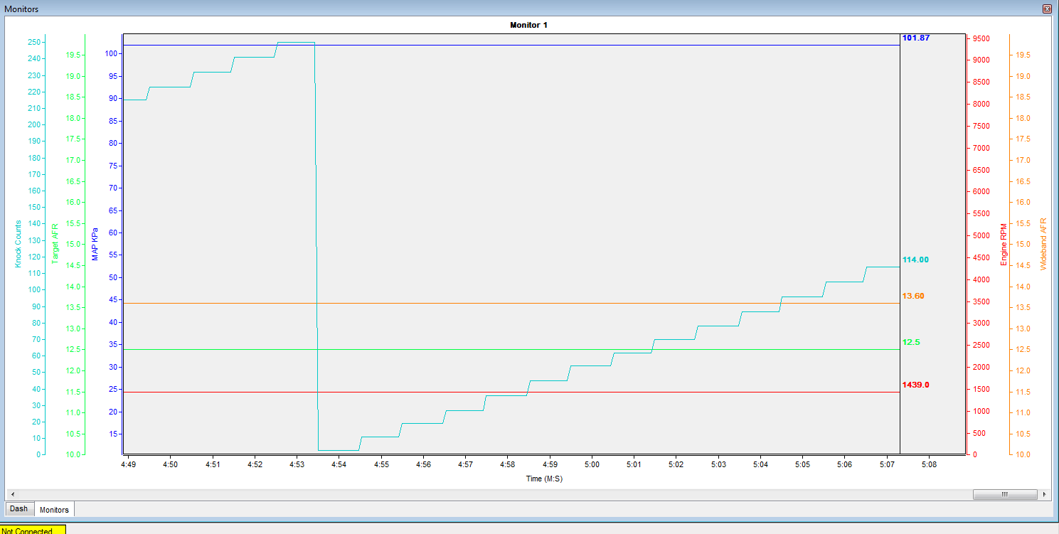

Well in the flashtool i tried adding both of the bkrtd and the knock counting however neither seemed to work in the logging.. The bkrtd would sometimes show a constant 171 or 150 in different logging sesions but it wasn't enabled so im not worried but coyld there be a conflict between knock an knock counting as they were both in it.

budwizer wrote:Well in the flashtool i tried adding both of the bkrtd and the knock counting however neither seemed to work in the logging.. The bkrtd would sometimes show a constant 171 or 150 in different logging sesions but it wasn't enabled so im not worried but coyld there be a conflict between knock an knock counting as they were both in it.
There wont be any conflicts, you can even have multiple bytes in the data frame defined as the same thing if you wanted.
Did you add the BKRTD and knock counter as new items or replaced existing? If you added them as new items the message 6 frame would then be two bytes larger, did you setup the TunerPro listen message to the new size when adding them in?
I setup a proper test with a generator and it steps through nicely with some knock pulses. Starts at 0, counts to 255 and resets like it should. I dont have a running vehicle to test this on though.

No i don't think I setup tuner pro to listen to 2 extra bytes.. However i shall suss it out and do some logging for you and ensure it works..
