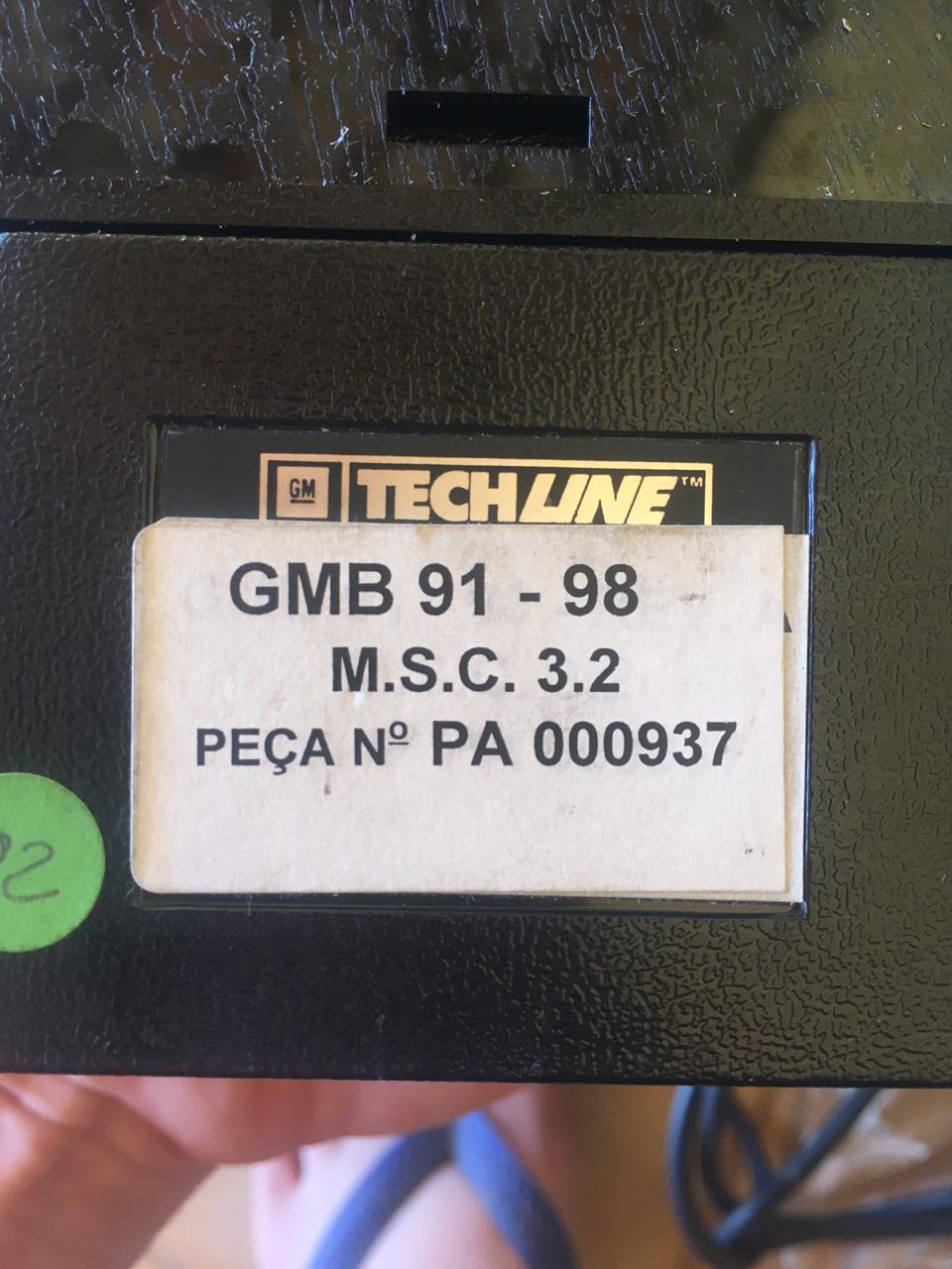

Anyway, GMB Tech1's covered from 1991 to 1998 and I don't know what size a regular cartridge would be. I think all were replaced by MSC's. And even those, are very, VERY hard to find. I just bought mine and I am reluctant to make any attempt of reading it, because I'm afraid of damaging or erasing it.
I have a spare GM/FORD/CHRYSLER PT cartridge that uses a larger AMD Flash (don't remember the size now) that may be useful to write this dump. Probably it is in the 512kB-1MB area. As I said before, the challenge is to fit the data in the right pages, because code runs from the cartridge and any wrong byte could crash the application.

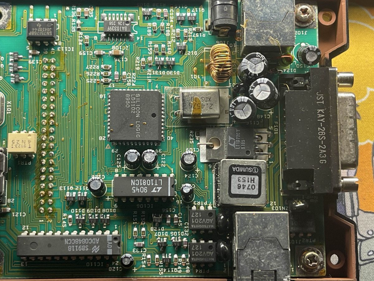

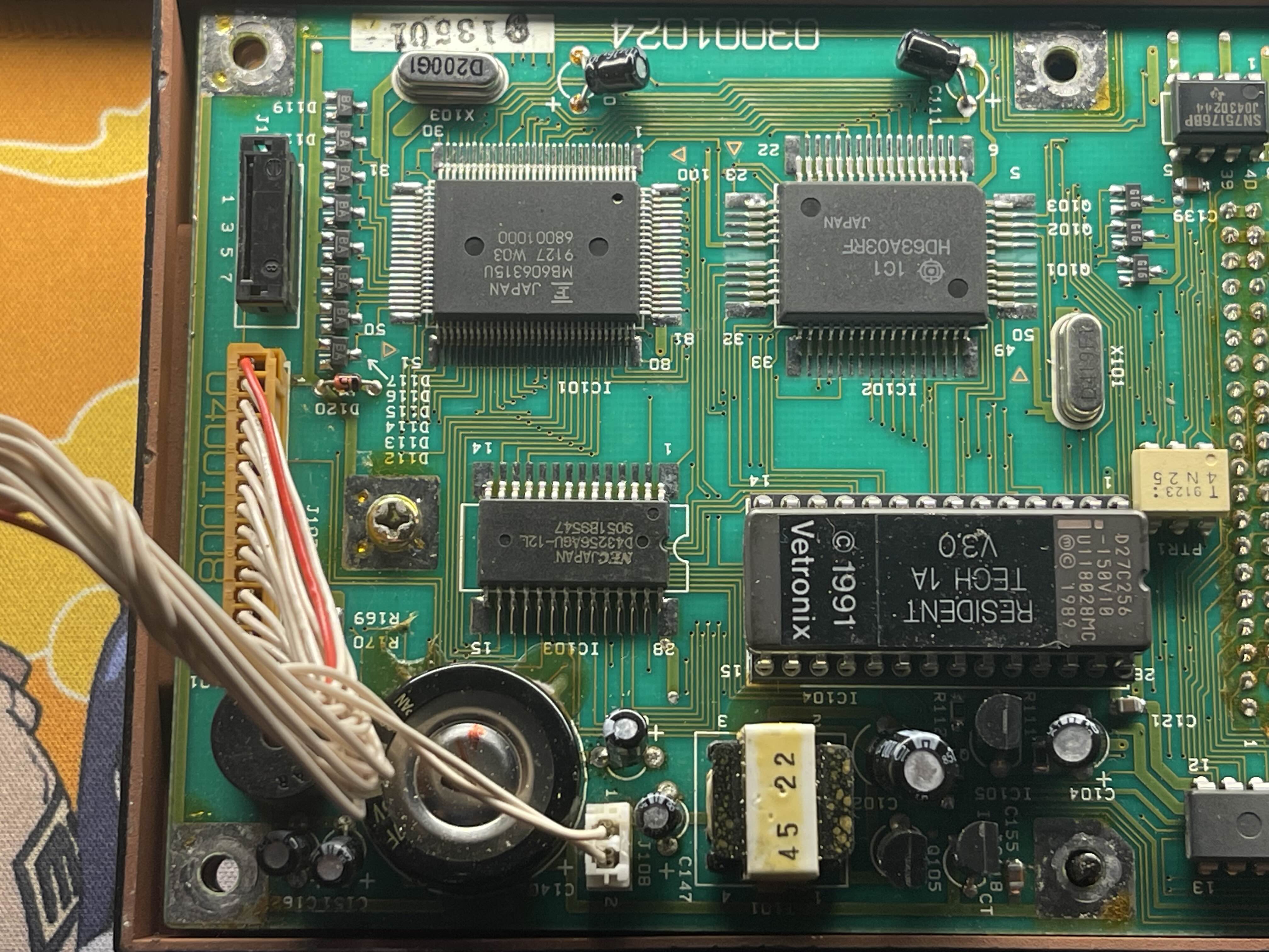

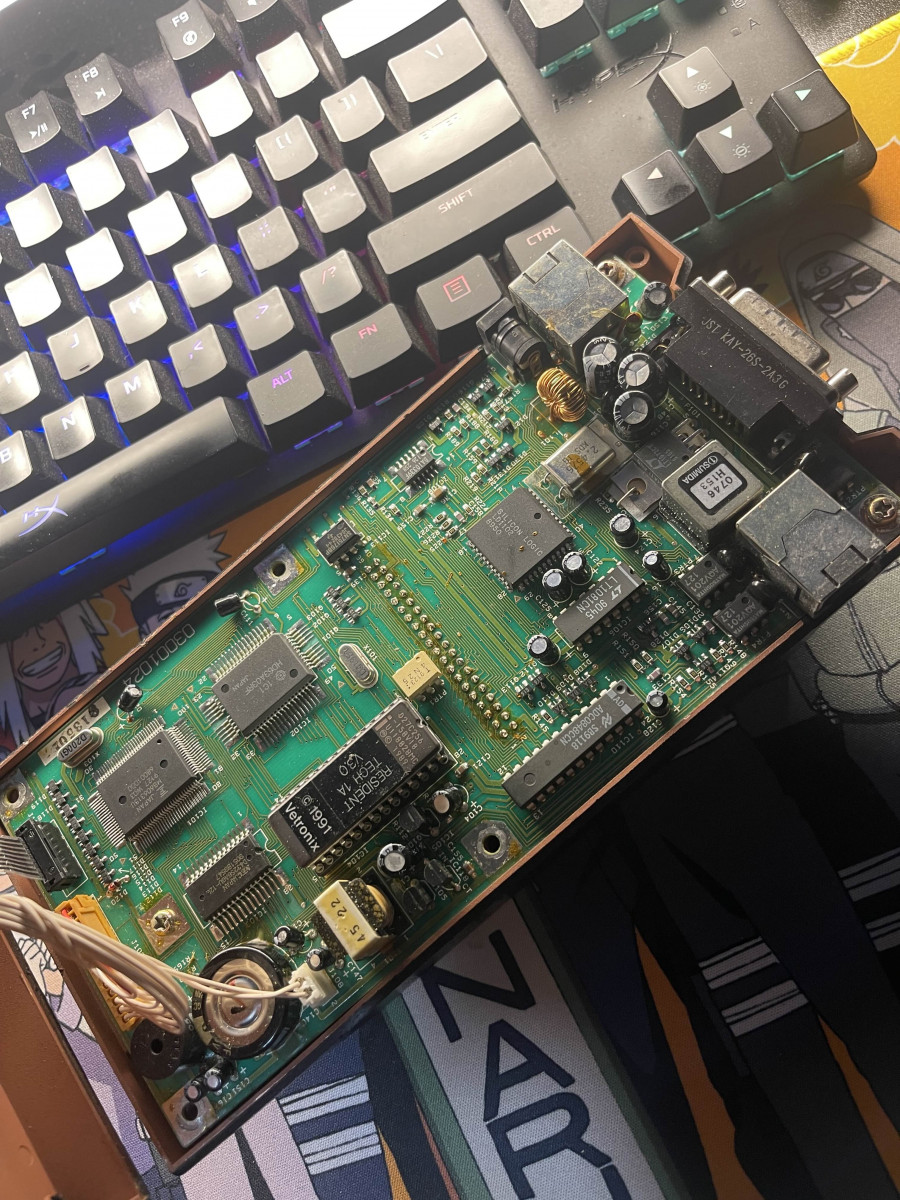

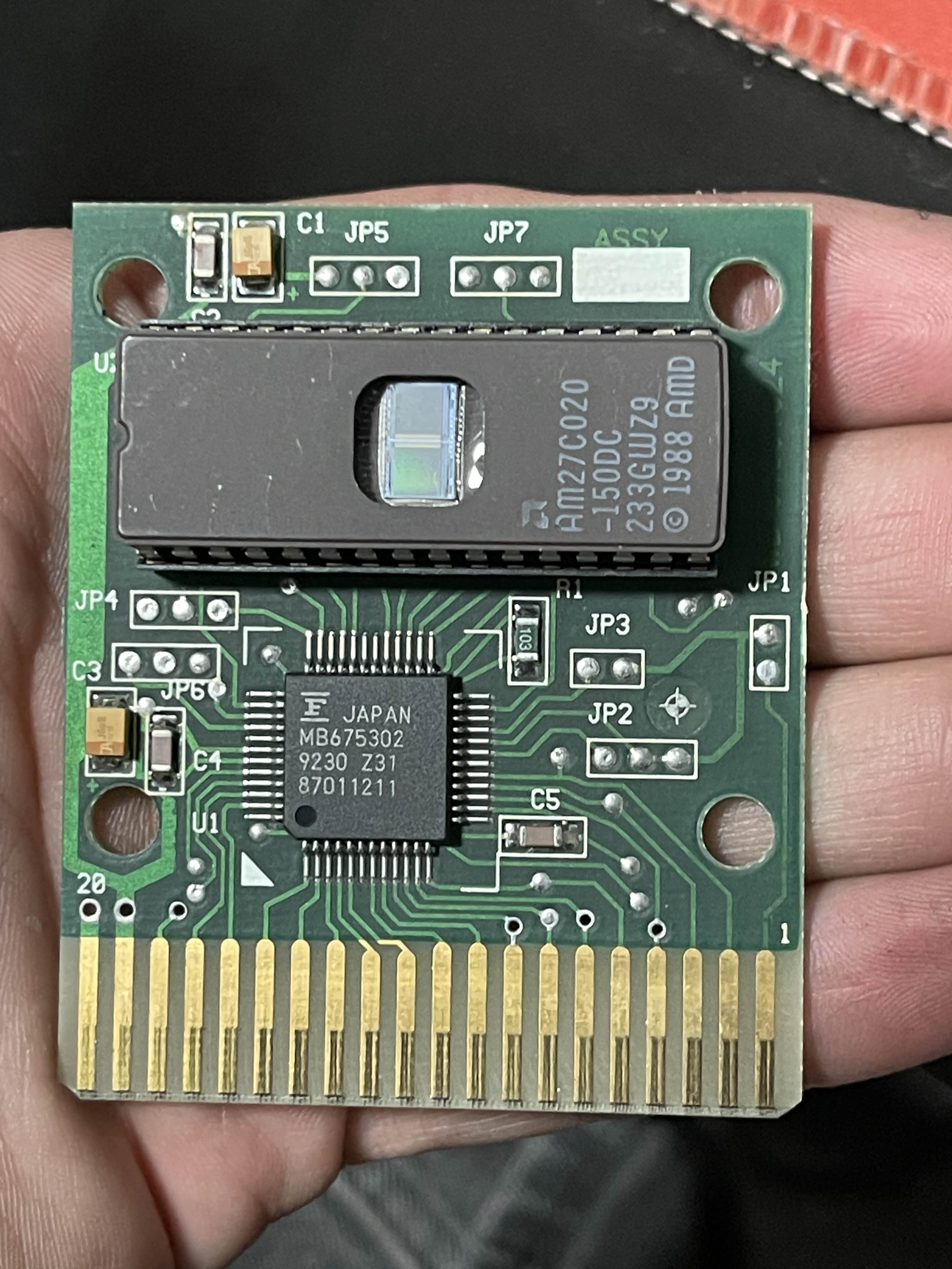

ik im tardy to the party but i only found this recently and got verified today. Though id add a couple more things onto this thread about the tech 1 lol. I took a picture of the insides of a tech 1 with the rs232 on the side and the inside of a GM 81-93 Powertrain cartridge. Hopefully soon i'll figure out how to dump the contents on that amd chip

The AMD chip inside the cartridge is a standart EPROM. You can use a regular eprom reader like TL866.
AFAIK there is no way to dump via Tech1 serial non-flash cartridges.
By the way, we have the Tech1A resident V4 binary. Would be interesting to have yours V3.
