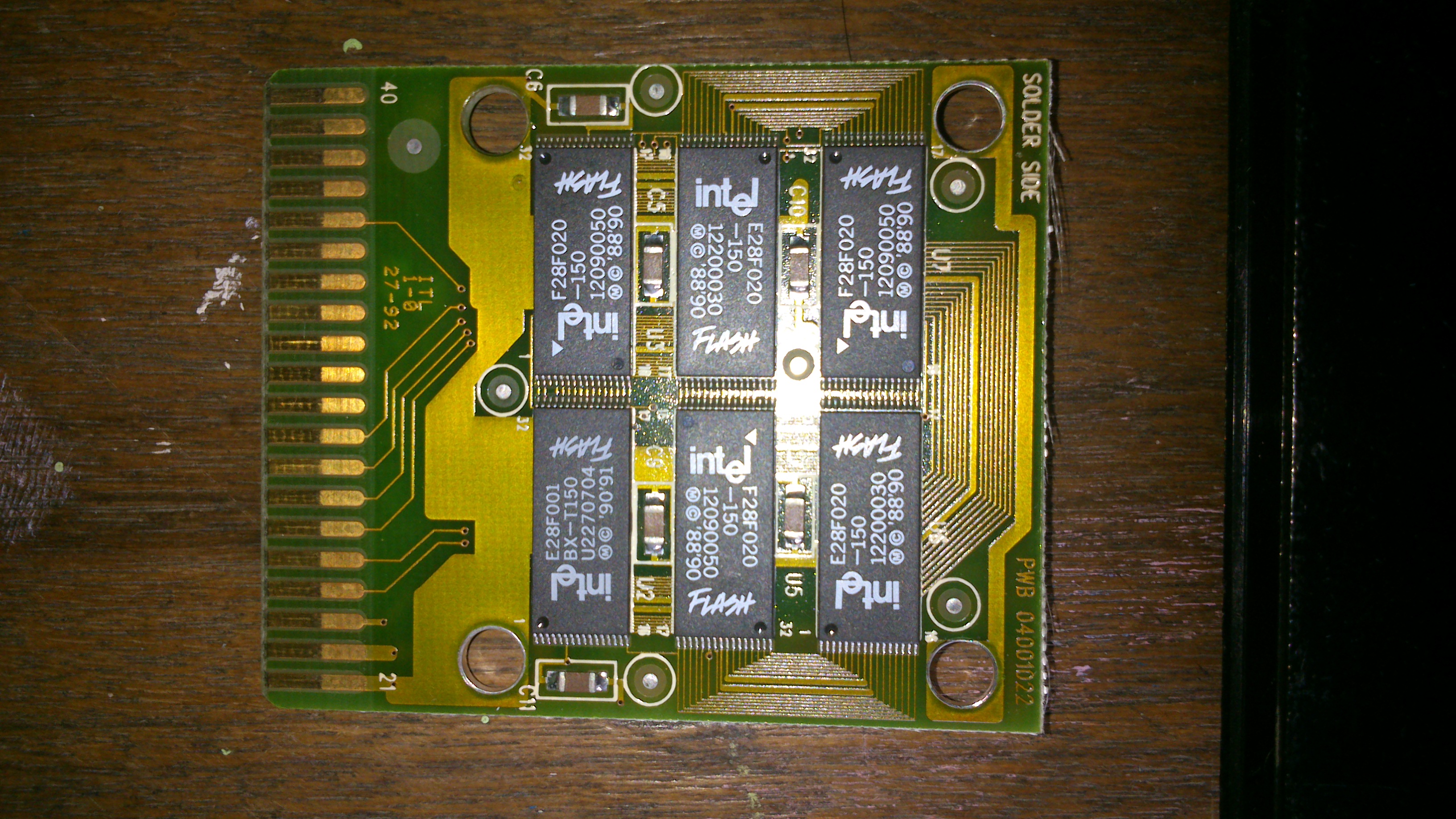

Here pic inside MSC (both side), any idea???

It looks like flash memory wired in parallel prolly using the ce line to select which one. But yeah will be proprietry.

Re: Vetronix Tech 1
Any info to extract the software inside flash memory and burn to new memory like standard EPROM/EEPROM?antus wrote:It looks like flash memory wired in parallel prolly using the ce line to select which one. But yeah will be proprietry.
I'm really new with flash memory...
- Posts: 10013
Re: Vetronix Tech 1
You'll have to come up with something custom. I dont think there is any information about how the data is mapped on there and thats after you buy sockets for those chips to suit your programmer and then successfully desolder them without causing any damage.

Observing the data written to it, seems like the writable data sits between 0x8000 and 0x9FFF, in pages from 0x01 to 0xff (in case of NAO package, about 1.1MB in size according to TIS). Seems plausible, since we'll have 255 pages of 8kB data for a total of 2MB addressable. The picture posted shows 6x F28F020 Intel flash chips, 256kB each, 1.2MB total
