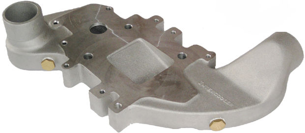

I didn't put it all together but yeah what your saying makes complete sense, would need to see how the plate for the A2A is (googled & edited & attached image).
So it looks like the maf does need to be before the throttle body on the hot air side or it will affect amount of air not being measured.
I think the original bypass purely just allows air to go through the back of the charger without going into the rotors when not on load.

Re: L67 tuning with A2A and MAF?
looking at that I can see why it didn't work for you, could make a spacer plate that will allow the bypass to go into the a2a and block off the hole at the back (even cut up an old phenolic spacer)
