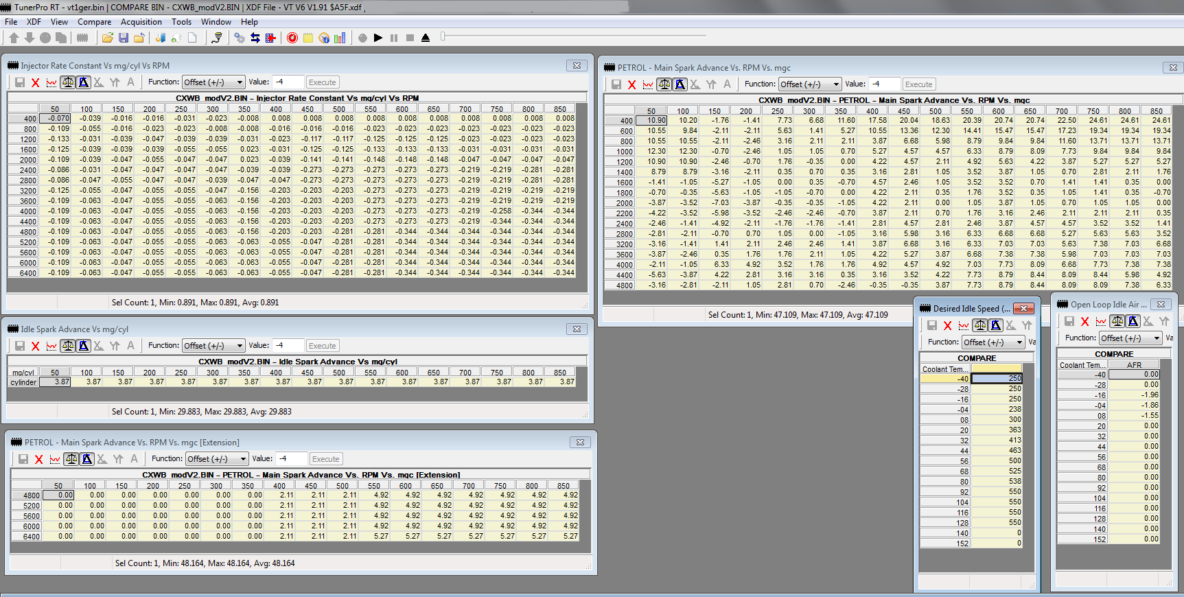

Not sure what version you used to tell you it's $A5F but it look's like its correct & lines up mostly with CXWL1938, which is strange also why they didn't use the updated version of it!
just the CAL only section does line up but some weird changes in unidentified areas with the XDF I have, which makes me wonder how much they do know.

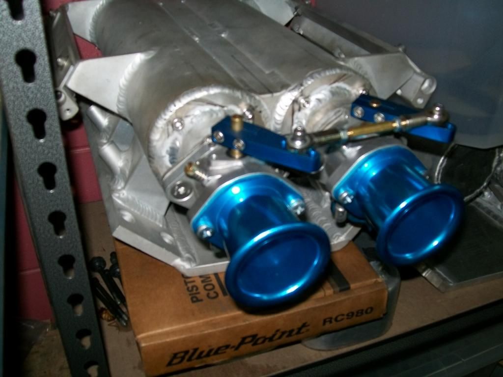

to get closed to 300 rwhp they said I need one of these lol

I think its VT V6 Auto -> CXWB_MOD2 https://pcmhacking.net/forums/viewto ... f=27&t=613
- Posts: 10111
Re: Results after a "profesional tune"
Changes from stock (excluding vats disable and and checksum) - displayed values are not absolute, they are differences...
It looks to me like they have pulled fuel out, and made a fair few changes to the spark map. Ive not tuned car like this enough to comment. Is this expected?
vt1ger, can you warm it up, then start logging it, drive it up the road with gentle acceleration, then cruise for a bit, then do a harder launch (if your happy its safe to do so)? then post up that log for comment?
